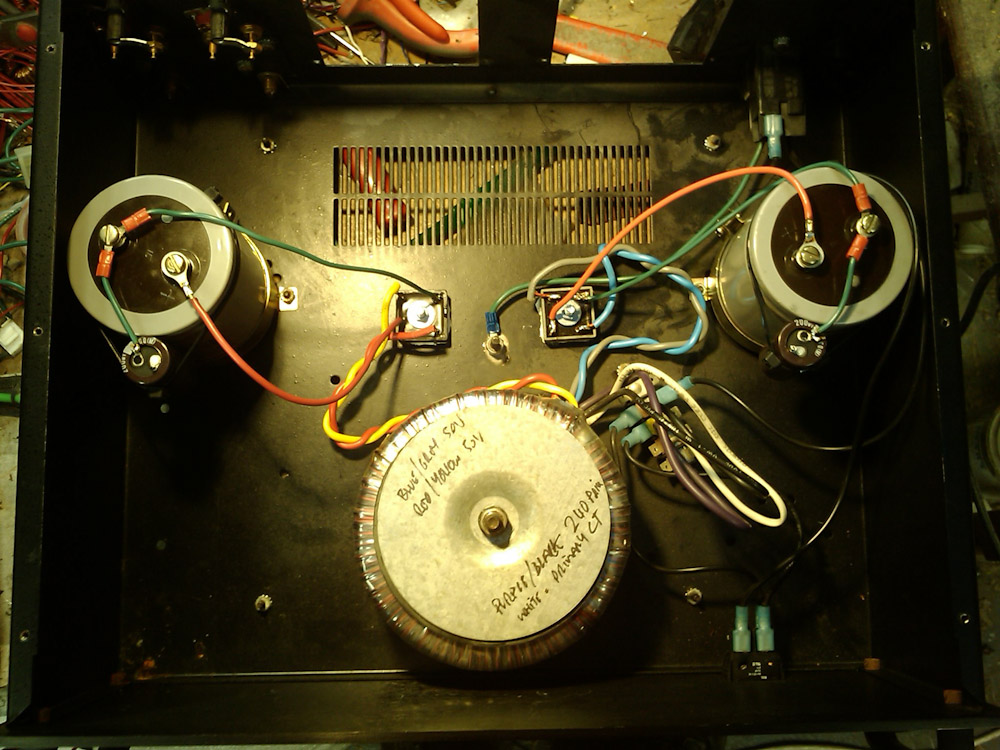

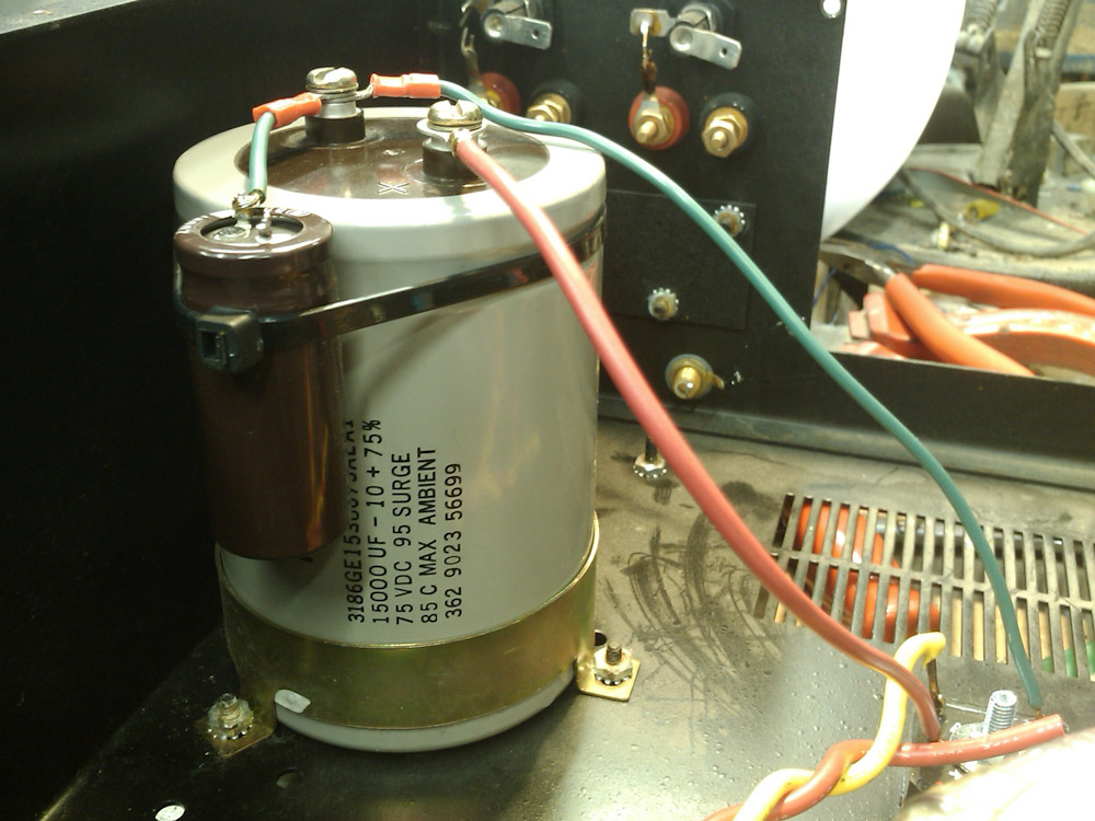

I got as far as having 3/4 of the PS built tonight. I'm going for build type 3 with the IXTH6N50D2. Tx is 650Va, 2 x 50V secondaries and I'm aiming at dual mono-ish. PS caps are 15000uF>>1r>>680uF bypassed with 10uF film. Those big caps are the size of a can of coke. The chassis is from a dead B&K amp. Heatsinks will be a bit undersized I think. I might try mounting the 1R on the base or side of the chassis to spread the heat a bit.
for the output caps I have some Elna 6800uF electrolytics and I might bypass them too.

Fran, I bet it will be noisy without another more cap or another resistor in the picture here. I use 15,000uf-1R-60,000 dual rail.
mmm. OK thanks for the heads-up. I'll start scavenging for big caps... if the worst comes to the worst, I can always go back to single supply and then I would have 15000>1R>15000. I would have used the 6800uF Elnas in the power supply, but they are 50V rated and the rails will be above that I think. Could also try bigger resistor too maybe - I think I have some big 5 or 10R power resistors.
What I might do is try it as is, and see what I get. At least that way we'll know for sure.
