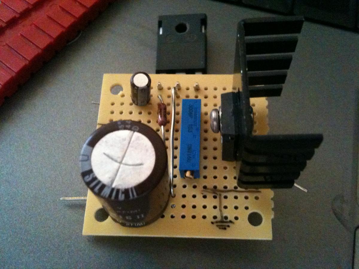

6N50D2 little amp
Here is my afternoon working amp. I got rid of some of the jumpers.
100uf high pass's the output.
I still have not figured out the bias with the light bulb.
The resistance is 4R cold standalone.
I measure 1.25A with MultiMeter with 1 lightbulb, and 2.6A with 2 of them in parallel. Sounds better with two. 😀

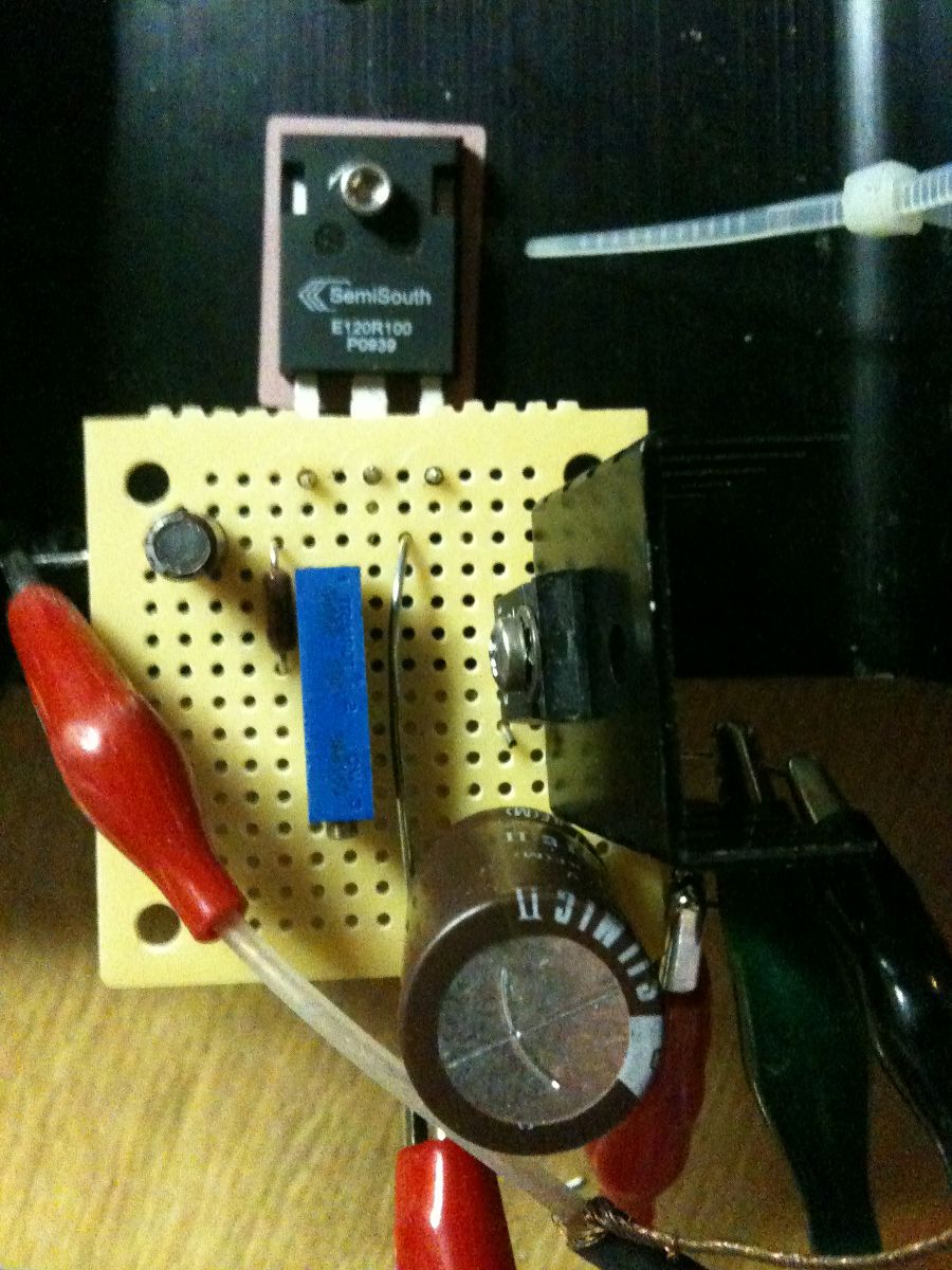

E-Lite with SemiSouth R100 JFET
I tried this time using the SemiSouth JFET instead of the depletion JFET, using the advice of nelson on the De-Lux De-Lite page 6. Wired up again on a RS perf board.
We can do much the same for the IXTH6N50D2, and Figure 10 shows the circuit of Figure 7 at 100V DC and 2.2 A. This requires a Gate voltage in between the Source and Ground voltage, so we adjust the input bias with a potentiometer as shown. Typically a 10K pot will end up being adjusted for about 25V DC at the Drain of the transistor. If you want to use an enhancement mode part (an IRFP240 for example) you can obtain the positive Gate voltage needed by tapping the potentiometer to the Drain of the transistor instead of the Source.
I gave it 14v from Drain to ground using a 50V supply.
I also got some Lowe's 300w lightbulbs (which measure 2.2R cold) now so I can get around 1.6A with one bulb.
The sound is good, and different than the D-Fet's. The SS JFet's, similiar to what I hear with an F2Jfet clone is similiar, very clean upper mids and highs. I think the pot here helps, as I was previously getting more distortion in the circuit w/o it.
Sound wise, if I compare it to tubes, the D-Fet sounds more like a 2a3, the Jfet more like a 45. Of course, those are based on fading memories.
Both have a certain punch and flow that make the circuit sound single ended and dynamic.

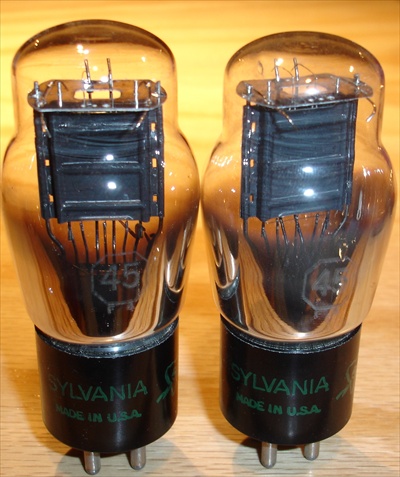

I am not familiar with tubes and therefore I don't understand this. Is a "2a3" and "45" a certainly tube number or amp model number?
Otherwise great work
this ones from attachement?Great sounding power Triodes 😀
