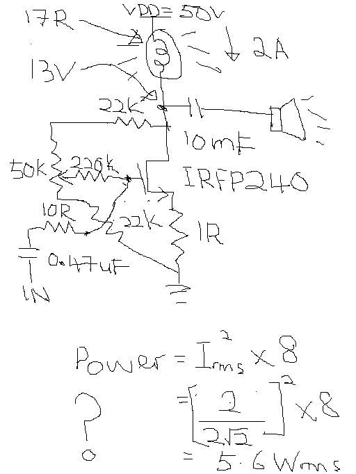

That's a step in the right direction. Thanks Woody. The next big thing is the CCS, I am making the assumption that it's optimized for 24v and a Enhanced mode mosfet, but maybe just throwing this together is the right thing to do.
Here is what I was thinking. I am not sure if this would even work, much less be anything near optimal. Any comments?
Probably it lacks a resistence to set the output impedance , say 20 ohm ?
More , since the Dfets are selfbiasing , why not try the ccs with them ?

From the altered F2 schematic, I removed the output resistors since the DeLite doesn't use them, all other thinkings looking somewhat similiar.
your right about the self-biasing bit, so self biases I belive with the 20R light bulb resistor, or 100-200watts of power resistors.
So maybe the CCS isn't in it's correct element here. But I am not sure I understand your reaction.
In my pic, C1's polarity is backwards. Oops.
I was also considering this since in F2, C4 acts as a slow turn on. That was one of my goals.

I believe the resistance of the lightbulb gives this amp an output impedience
of ~20 ohms with the light bulb doing double duty acting as a curent source and
adding some damping factor like the bank of resistors in the F2. Replacing
it with a ccs will up the output power but leave us with a pure current source
amp without any damping factor.

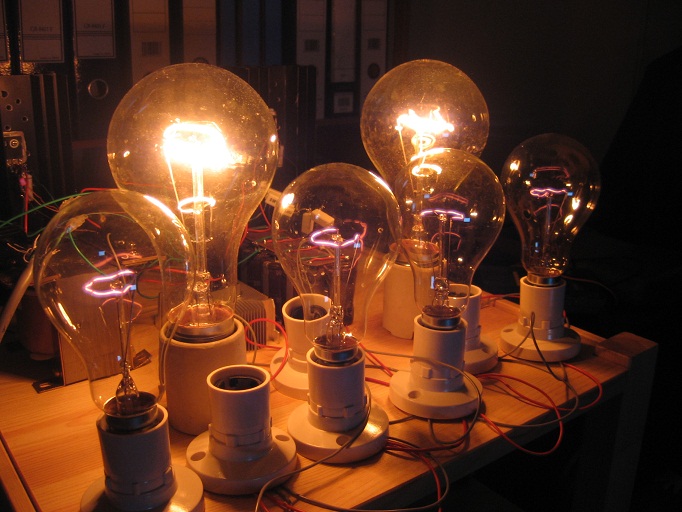

My modest contribution...
MobileMe Gallery
heatsink are diy.... they're cold...
I am listening to the Beatles now, using one amp only since the other is capricious... (light changes its intensity on its own, bad sound, etc...).
The one I am listening now is very much alive... I need to give it more listening, but so far... Success!!!
Hey Stefano,
That it not an option as the FET already sets the current. Two different wills trying to set the standard🙂.
But the close relative to a CCS, the gyrator will work as this one is an AC-CCS and a DC constant voltage source.
This will rise the Zout considerably as the RDC of the bulbs almost alone sets the Zout of the present design. So not an option after all.

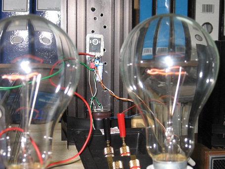

My "en"lite
No depletion, but IRFP240. Anyway, it sounds pretty good, even nicer to look at (other lights off). Transistor biasing ala F2 but resistors value are 10X larger since only these are available in my junk tray. Does larger value biasing resistor affect performance?

Hello ,
Does not happens also in Zen V9 the same thing , the jfet
are selfbiasing , and the current source current has somewhat to be trimmed
for best results ?
If the light bulbs set the Zout , why not the CCS at the same place plus a resistor output -ground as seen many times in the Zen series .
The resistor also helps a lot to equalize the response of the driver , an effect that I like a lot .
They don't fight if you have some DC feedback to hold the
operating point. It doesn't take much, as in the circuit
shown above.
