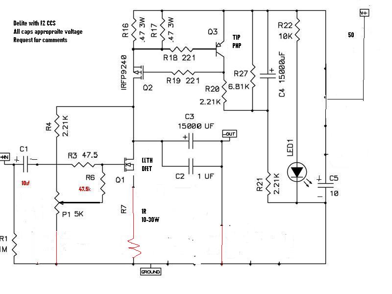

I tried an IRFP240 and a South Semi R100 in the Enhanced mode (47k from gate to drain, not gate to source) sounded good, but distorted fairly quickly.Tried 10k and 100k resistors with the same results. Voltage was 55v

I failed to mention, that swapping back in the the D-Fet, and was not so distorted, so the circuit works well.
Now thinking about some CCS instead of lightbulbs. Maybe kind-of F2 style.
I am thinking slow startup of F2 ccs (no thump), and shrinking my layout a bit to fit into my small style chassis 12X8X10 inches. Of course some values probably need to be modified in F2 CCS to adapt to higher voltage. I think the ZTX 550 might be pushed to the limit. A BC546 might be better suited, but not much. Looking at the schematic of F2, one looks to be able to R6 to 47k, C1 to 10 uf, Run Source resistors at 1R 15W. Eliminate some portion of other resistors.
Thoughts?
Thoughts?
