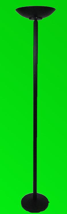

The new model will be called: The L-amp
Amid worries about global warming, there will be a new, environmentally-friendly model which will be at least 50% more efficient. It will kill two birds with one stone. The core idea is to illuminate your listening room while listening to music. At the back of the amp, you will find two sockets where you will plug your green floor-standing-halogen-lamp (not included). So, listen to music and save the earth🙂.
*Disclaimer: If you want to listen in a romantic mode (mood) and want to dim the lights, you may reduce voltage, thus increasing the distortion and decreasing the pleasure. However, it is assumed that this decrease of enjoyment will be overcompensated by other romantic means. 😎
Sorry Papa, couldn't resist ! 😎
You forgot to add that, warmth (heat sinks)and soft touch(second harmonics)will be also included.
