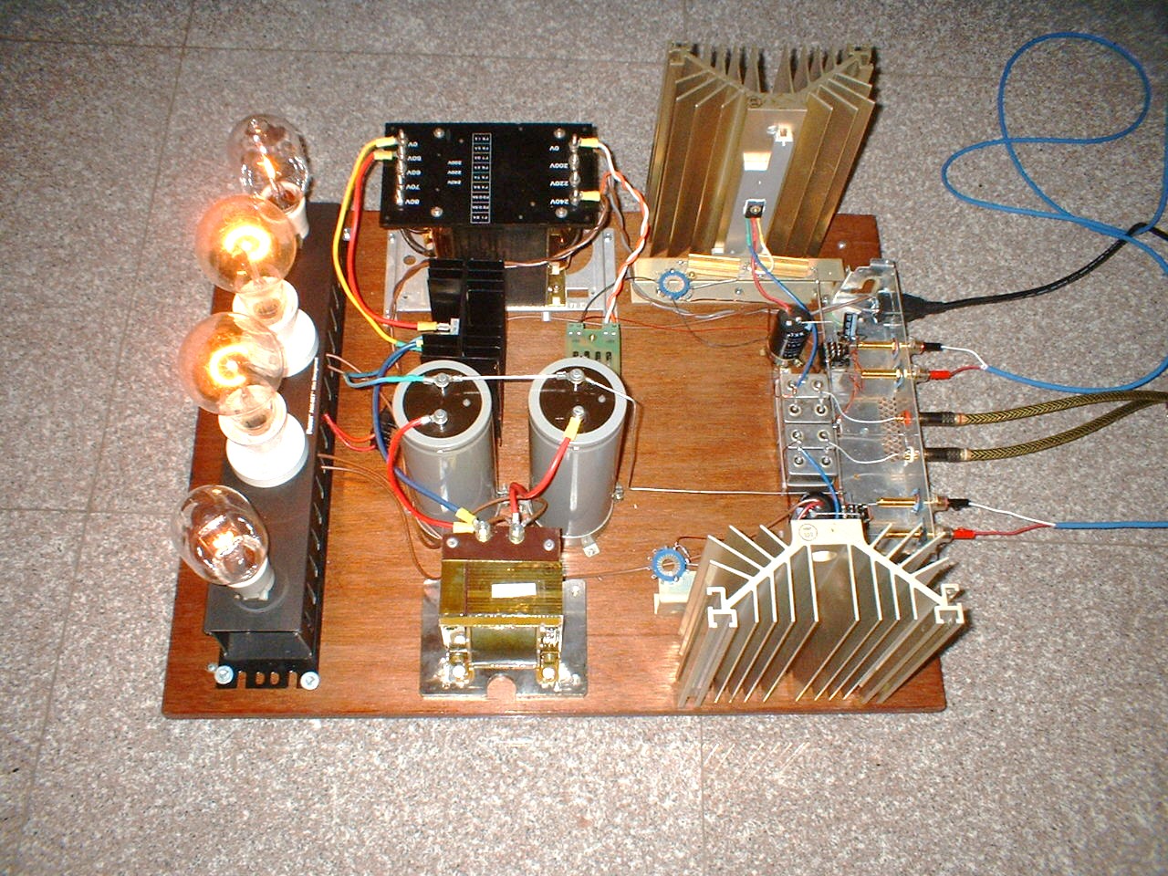

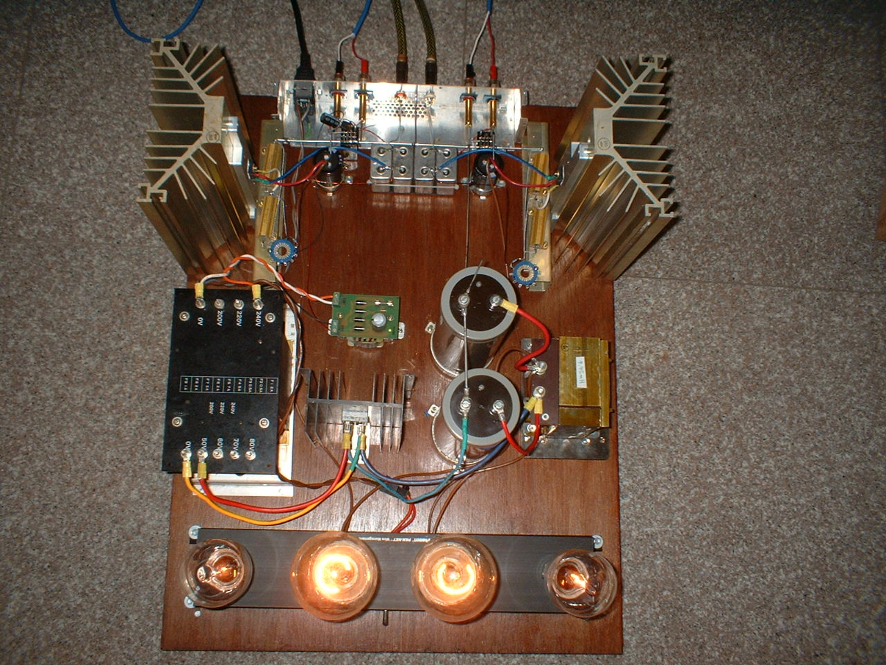

I just wire up Delite Amp on a piece of plywood. The power supply voltage is DC 64V. Two light blub per channel (parallel). One of the light blub is 110V 200W, the other light blub is 240V 500W. The sound is warm, better than my zenlite.

I'm hoping to have a go at this. Would some 18-0-18 transformers wired in series (ie 36V) at 300VA be good enough for each channel?
Secondly, the lamps.... 240V ones will draw half the current (am I right in this?) so I would need roughly 2x the wattage compared to papas knock up at BAF?
Fran
Woodturner, all you have to do is forget that your transformer has a center tap and
not use it and you have a 36v transformer. Or you could use the center tap and build a + and - 24v supply but in this case leave the center tap and it's conection
to the 2 caps floating and ground the -24v output you get 48v this way and can use
35v caps for this first filter bank.

For those in 240v countries I have done some simple measurements on a range of lamps. 60w lamps measure about 90r. 100w comes in at 40r. 150w halogen stick type was 30r. Lastly I measured a few 500w halogen sticks which varied from 12r to 19r. So it would seem 2 in parallel to give 250w or so is a sensible Target.
