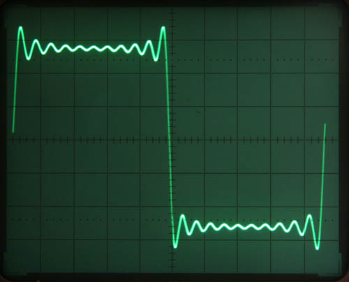

Problem building a Spencer I/V-stage
Hello all,
I built an I/V stage and power supply according to Spencer's schematic. I just made my own layout and PCB. Today I finished the I/V stage and attached it to my DAC (CS8416 -> AD 1896 -> DF1704 -> ISO150 -> 4x PCM1704U-K).
It looks like the stage is working, but what concerns me is the response to square signal (see attached screenshot of my scope with 1000 Hz).
Any ideas what’s the problem here?
Many thanks in advanced for help.
Best wishes
Ralf

I'm not sure it's a fault.
There is a thread discussing this on diyaudio:
http://www.diyaudio.com/forums/showthread.php?threadid=6901
So how does the I/V stage sound?
cheers
Paul
cheers
Paul
Hello Paul,
Thanks for the hint. It’s always embarrassing if you don’t know the physics behind the device you DIY. My 15 year old NOS Pioneer CD-Player can produce a nearly perfect square so I thought that the new DAC should be even better
Ok, no more concerns about square waves. At least the responce is near the mathematical square funktion limited to 22 kHz.

Ralf,
don't worry. your pics made me search for more information about this as I hadn't checked the square wave and they looked a bit odd. I learnt something too 😉

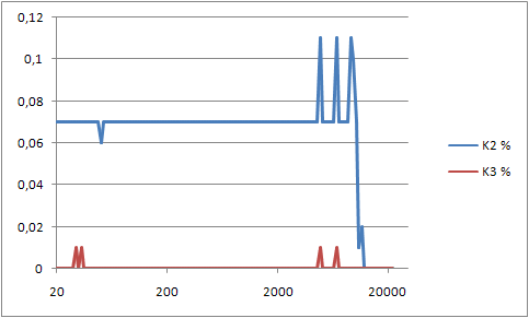

I measure high 2nd order harmonic distortion as well, higher than a tube DAC. Its just the nature of the D1 I/V (no NFB.)

Hello,
here is the distortion I measured with my ADC. I think the level I measured is near the limit of accuracy of this thing. So I would not put too much weight on these figures.
The HiFi manufacturer around the corner made very drastic clear that he is not interested in DIY-freak's affairs. But I know some other HiFi developper who is more open. Let's see what he charges for a precise measurement.
Today I listened to my DAC and it looks like it (or my ears) need a few hours burn in. I like it more and more. But I just enjoyed music and made no analytic listen tests.
Some more pictures are on my website .

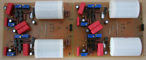

Hi regal.
is it possible to see the schematics of your works? Your DAC and the D1 I/V stage too?
