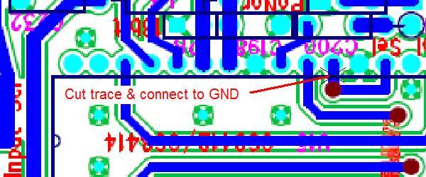

I am looking at the PMD100 datasheet and don't see how it would work with the adapter board
It states that the input data must be MSB first. Spencer has the CS8412 configured to MSB last.
Here is what the application notes say to do:
CS8412 - M3, M2, M1, M0 all to ground
PMD100 - XTIM, PROG, JUST, SMUTE, FSEL all to ground
BCPL to 5+
Looks like his will take some serious pin lifting and jumpering to get the PMD100 to work with the CS8412.
Now looking at the DIR9001 adapter kit, I think it 16 bit it outputs a MSB First Right justified, which is what we need.

This is from the PMD100 application notes. There are actually 8 modes, you would have to lift the M2 pins and tie it to ground instead of +5V in order to use the PMD100.
M2 tie to "1" so that 16 bit and 18 bit mode is able to be selected. Note that the PMD100 is also compatible to the 16 bit mode. Sometimes there is more than one way to make the chips work!
ah-ha!! i didn't see that you set JUST high on the pmd100!! So cs8412 must be set to mode 5 - 16bit to work. that would explain why it sounded like s**t.

If you want to connect M2 to GND (instead of +5V), you can cut the BOTTOM trace as show in picture and connect pin 18 of CS8414/12 to GND. Should be quite a easy mod in the D1V3 pcb if you want to try.
Note I have not done on this mode and thus it is take on your own risk trial.

PMD-100 working
switching the cs8412 output to 16bit solved the problem, so now I'm happy to report the PMD-100 is working fine. After changing the caps on the adapter I have to say I really hate 0603 case size caps.
