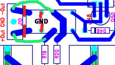

Re: Another D1V3 "tweak": Output Relays
spzzzzkt said:
If the pins are left on and soldered to the pads - which are grounded, it's a simple matter of cutting the traces between R19,20,30,40 and the relays, then running short jumper wires from the relay side of R19,20,30,40 to the output pads. In normal operation the relay is not connected, but in mute mode the outputs are shunted to ground.
[/B]
Hello Paul,
I am looking at your upgrade to the output relays.
But doing so, if the traces between R19,20,30,40 and the relays are cut, how can the relays shunt to ground the outputs in mute mode? If the relays input not exist (cutting traces) nothing can be shunted to ground.
Let me know your opinion.
Many thanks. Best regards.
Davide.
You are right - the "mod" doesn't work as advertised :\
Checking the datasheet for the relay I can see why, and you are 100% correct that as described it won't shunt to gnd. I'd suggest leaving as standard unless you feel like trying out a different method 🙂
What I think should work is:
- leaving the connection from the resistors to relay in place.
- cut traces between relay and output connector
- Jumper between "input" pins on the relay and the output connectors
- Tie the "unconnected" pins to GND. If you have trimmed the leads as described in the build notes then you'd need to replace the relays so it's probably not worth the effort in this case.
