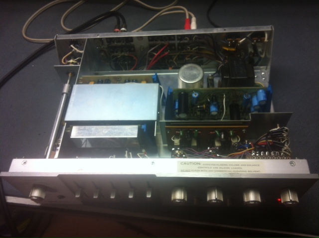

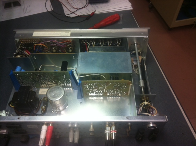

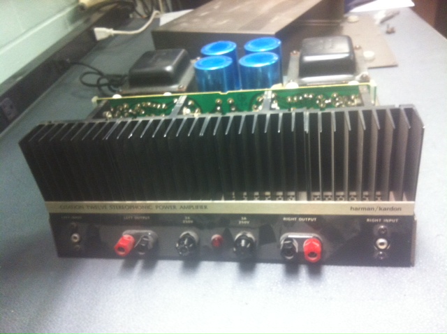

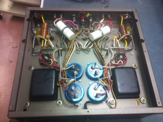

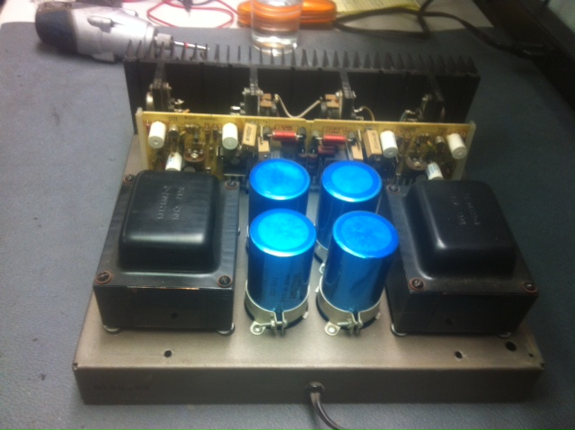

Here are some pictures of my recently acquired CT11 and CT12. I'm almost shy putting the iron on these... They are both completely original, not a single wire moved... Both no rust, corrosion, oxydation, nada... Working like new; not a scratch, pots are clean.. etc...

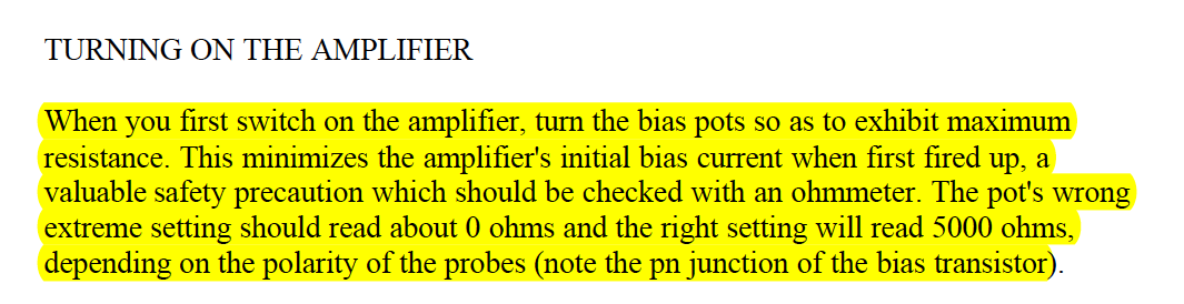

this is quite old thread but maybe I have an answer here. I'm using a couple of Tazz board for C12 Mod and Bias setting is always a scaring point for newbie, at leat for me..on your schematic and pcb it seem clear but I would like to be sure:
If I understand Right, At the initial Turn On the screw of the variable resistor R17 must be in COMPLETE COUNTERCLOKWISE position?

To lower the bias current, you'll have to lower the value of R14 to 4k7 (or to 5k by adding another 10k in parallel to R14).
If you want to take out the Vbe multiplier circuit (Q4, R14, R17) and use a single resistor to bias the output stage just put a 1k or 2k multi-turn pot in parallel with C5 instead. Don't forget to set that pot to 0 Ohm before turning the amp on.
Also, check the current through Q3 (should be about 5 mA) by measuring the voltage across R13. If that's so, you'll have the output stage bias at 150-200 mA with pot set at 400-500 Ohms.
it seems the opposite that Mr Pass says.....if I follow him for a project, I can't see why don't follow him on the Bias...
It's easy - if you you use vertical MOSFETs you need Vbe multiplier to control the temperature drift and bias adjusting begins with low/zero current through output stage and, at the start, the pot has to be set to maximal resistance value.
If you decide to use Lateral MOSFETs you don't have to worry about thermal drift so you don't need Vbe multiplier and instead of it, just a single pot between the gates is all you need. With such a configuration the Id adjustment should be started at minimal/zero pot resistance setting.
