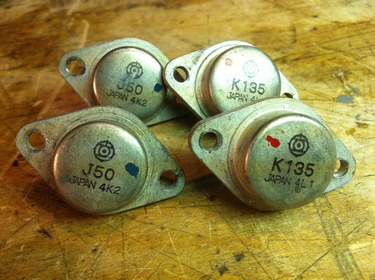

Well I've completed my MF Citation 12 but have a problem with biasing.... Can't get lower then 350ma.
I'm using the K135 and J50 old Hitachi TO3s and BC139 BC140 everywhere else.
Cant find transconductance neither bias info on the datasheet for the Hitachis.
Playing with the BIAS pot don't seems to have any effects. Even removing the 4.7K in parallel don't have an effect.
Can anyone help me?
I've verified the schematics on my original "modified" boards and everything is right, as the "Revised Mosfet 12 schematic, complementary version" shows.
Can K135, J50 be wrong for this application?
I've done all verifications, got the amp to clipping around 20 RMS volts on both channels. Both channels have the exact same problem; bias around 350ma, even higher at start up going a bit lower after.
Thanks anyone!

If you want to use lateral mosfet for citation 12, you must modify the VBE multiplier resistor value since they are intended for Vfets which has around 4v for Vgs. You can also omit the VBE multiplier and replace with just a low value resistor since laterals don't need thermal compensation.
Gate to source voltage is at +/- 14 volts.
Hmm... what's wrong with 350ma of bias voltage... gets hot but I've seen worse. I was just trying to follow the original plan. I should get both clipping starting at the same voltage hey? Means I should replace 5K pot by a higher value as this one seems to have no effects on the current...

The Hitachis ought to be conducting at around 1V Vgs, so the complementary
pair of followers would have a bias circuit around 2V. At the voltages you
mention, they shouldn't work at all. What are we missing here?
How about the pinouts? Aren't these laterals with Drain and Source pins reversed?
Dooohhh!
I knew about Drain/Source reverse pin out and swapped these 2. And verified, verified, verified,...

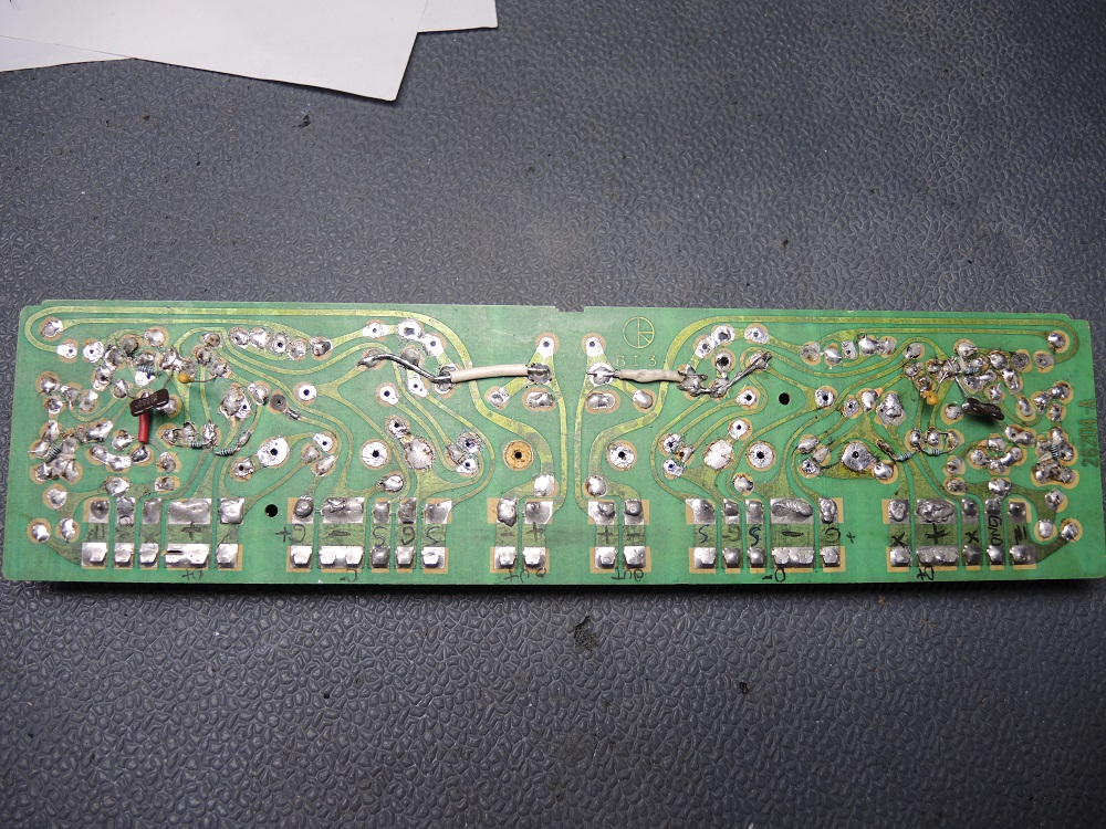

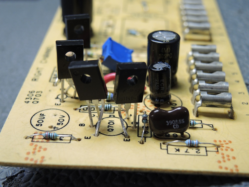

Anyhow... I'll try to add a few pictures of my project to this post. If that can help a bit... You'll notice one red jumper that will on one the front side of the board on one side and on the back for the other... Didn't noticed there were wholes...
Well thanks for helping!
