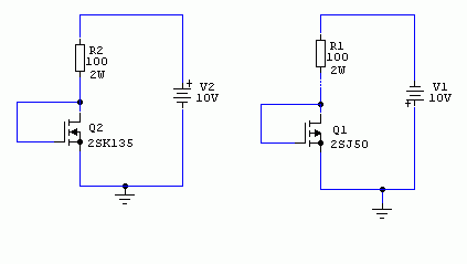

Start verifying the FETs and don't know if this is supposedly normal but even without gate voltage there is current going through the FET between drain & source. Checked the other J50 I have and same thing. Checked a IRF130 and same again so it may be normal.
Do I have to "ground" the gate to close the junction? I've verified with ohm meter in diode check and get .330 on the good side and open in backward. So no short there.
I'm used to check Mosfet with a 1K pot, tap on the gate and both sides on the drain & source. + at drain for N channel and gnd on drain for P channel. Is this OK? I've measured the K135 to close junction with .5VDC but the J50 is always closed...

HAHA .... just noticed the test setup I'm using for FETs comes from: https://www.passdiy.com/pdf/mos.pdf

Forget last post
Can't edit it my last post anymore, too late.
I was stupidly measuring the FET backward... Don't do too many things at the same time... Both are fine. The K135 starts conducting around.5V and the J50 around .2V.

That's a fine article and you should read it carefully in order to understand how these devices operate.
For a quick check use the attached schematic. If MOSFETs are OK you'll have about 9V across the 100R resistors which means that they conduct current as they should. Be careful with pinouts and polarities.
Be careful not to burn the MOSFETs. They can't take more than 15V between Source and Gate...... I have the +45 all over on this channel, up to the N FET gate.

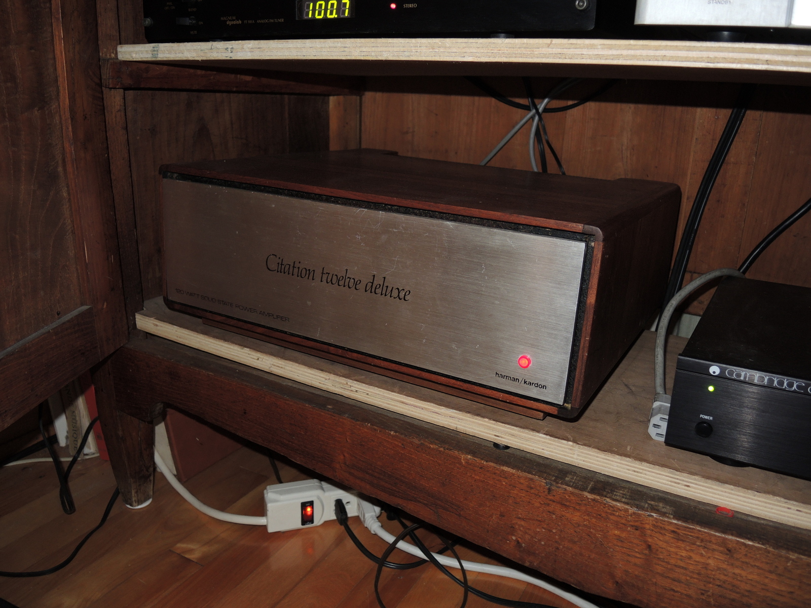

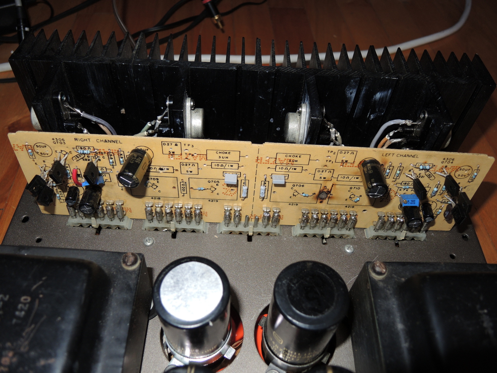

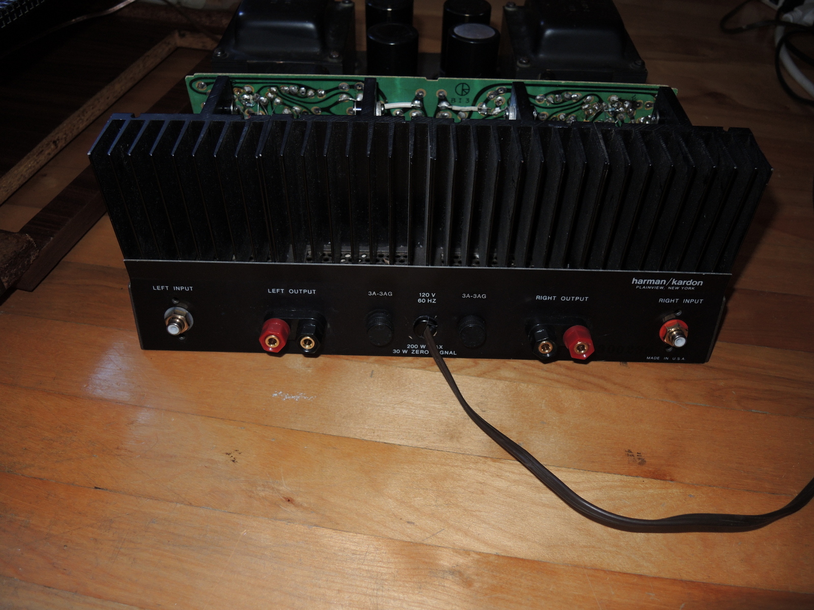

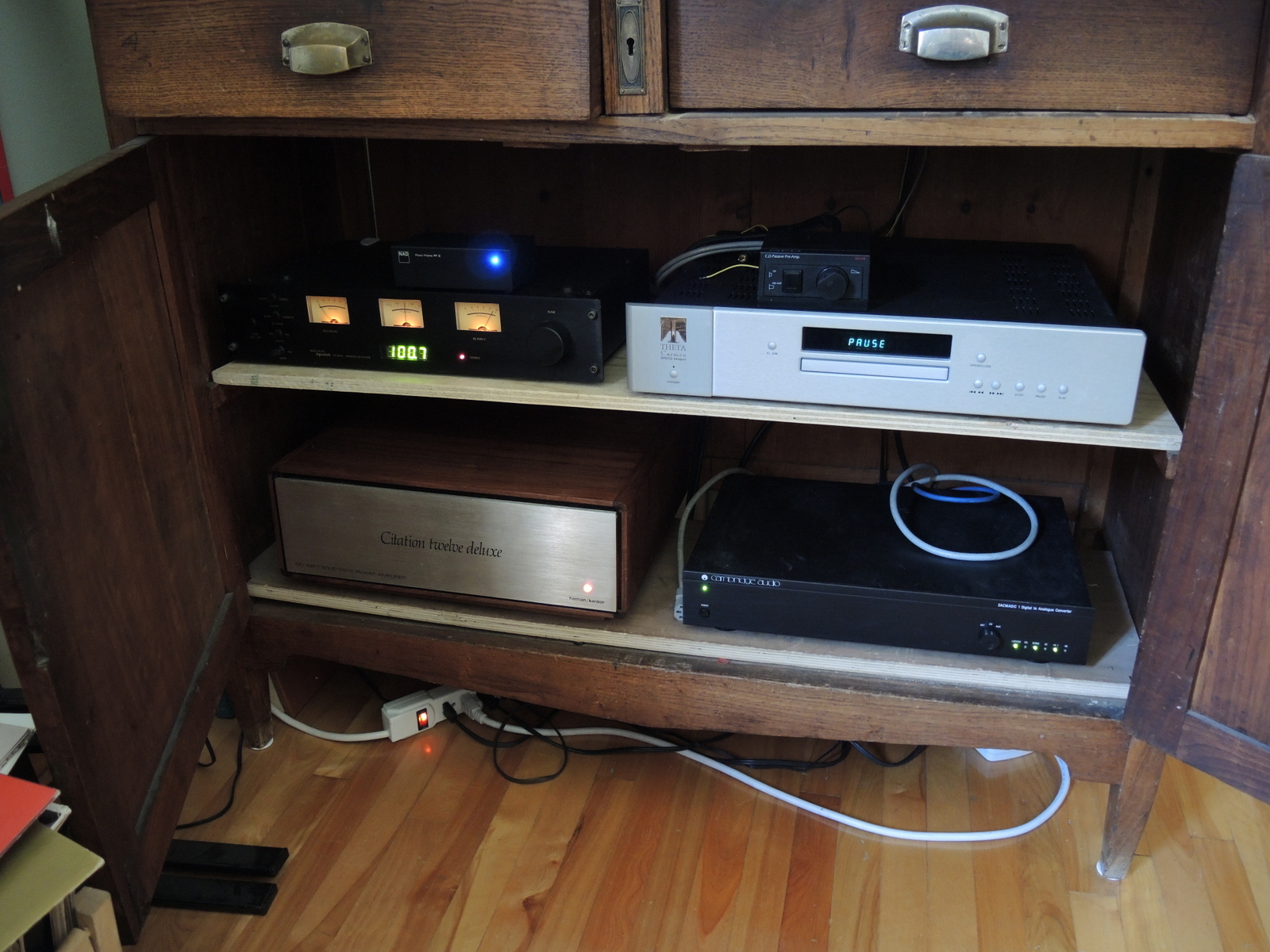

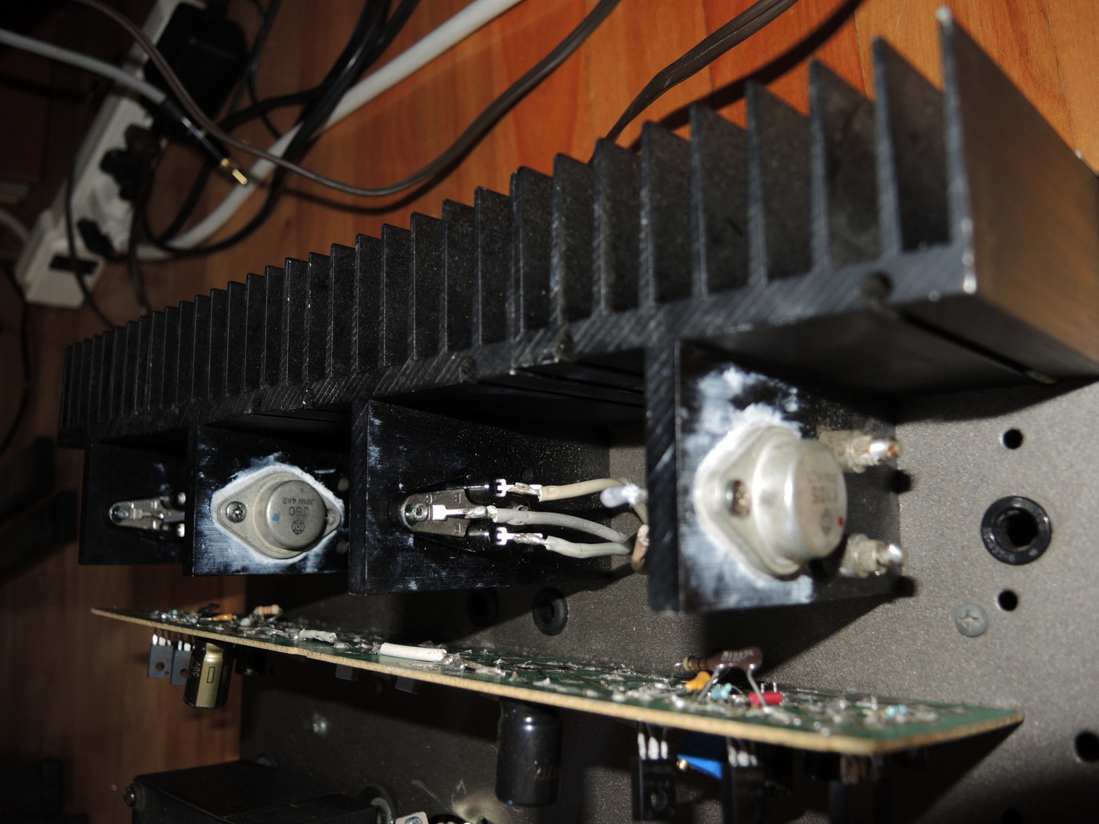

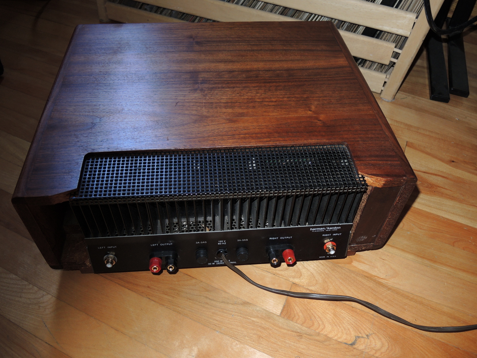

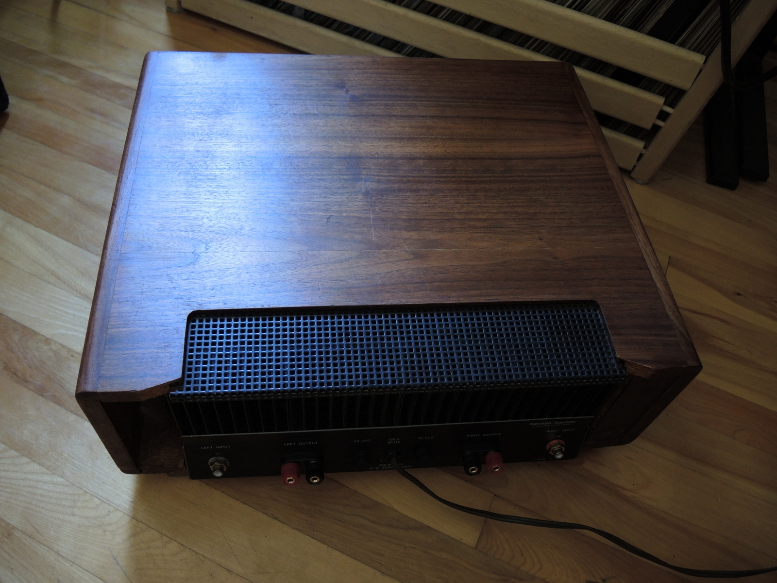

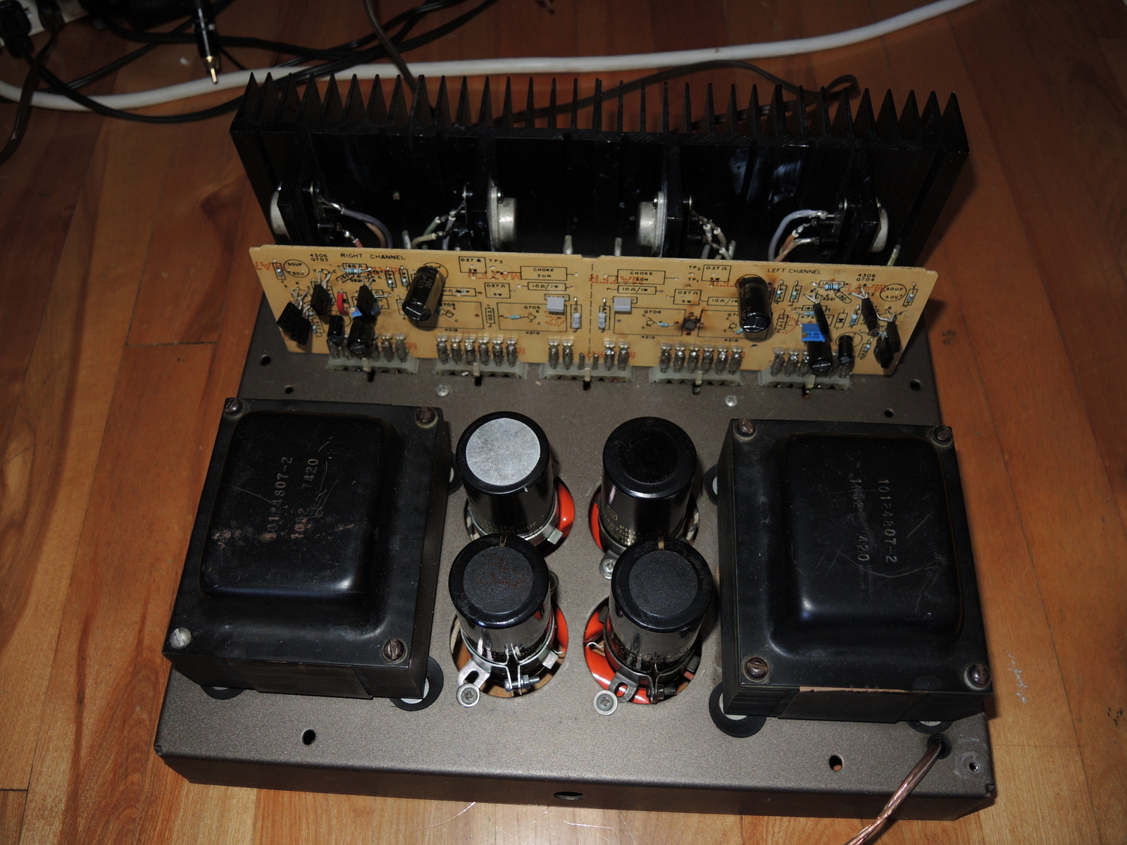

Pictures
Here they are...

Here they are...
For the next one I'll use a custom chassis. I have 2 toroidal transfos, many filter caps I'll put in parallel (with small value resistor between ), new boards from Tazz I'll populate and I'll use IRFP9240 & 240. Will get back here as well.
