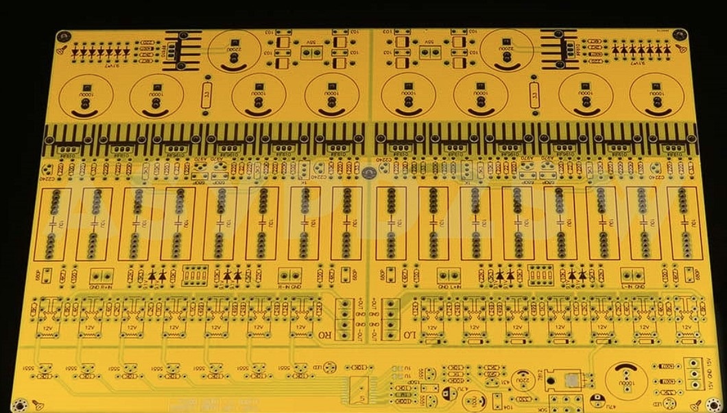

Hello,
I am looking for a preamplifier for my Aleph 5. The choice fell on the Aleph P 1.7.
PCBs are hard to buy these days. I only found this:
Aleph P1.7 Preamplifier - HiFiStor
Does anyone have experience with this ?

Remember that you will have to add a resistor in parallel to the input Zeners (it is not on the board). Check the Papa Pass article 😉

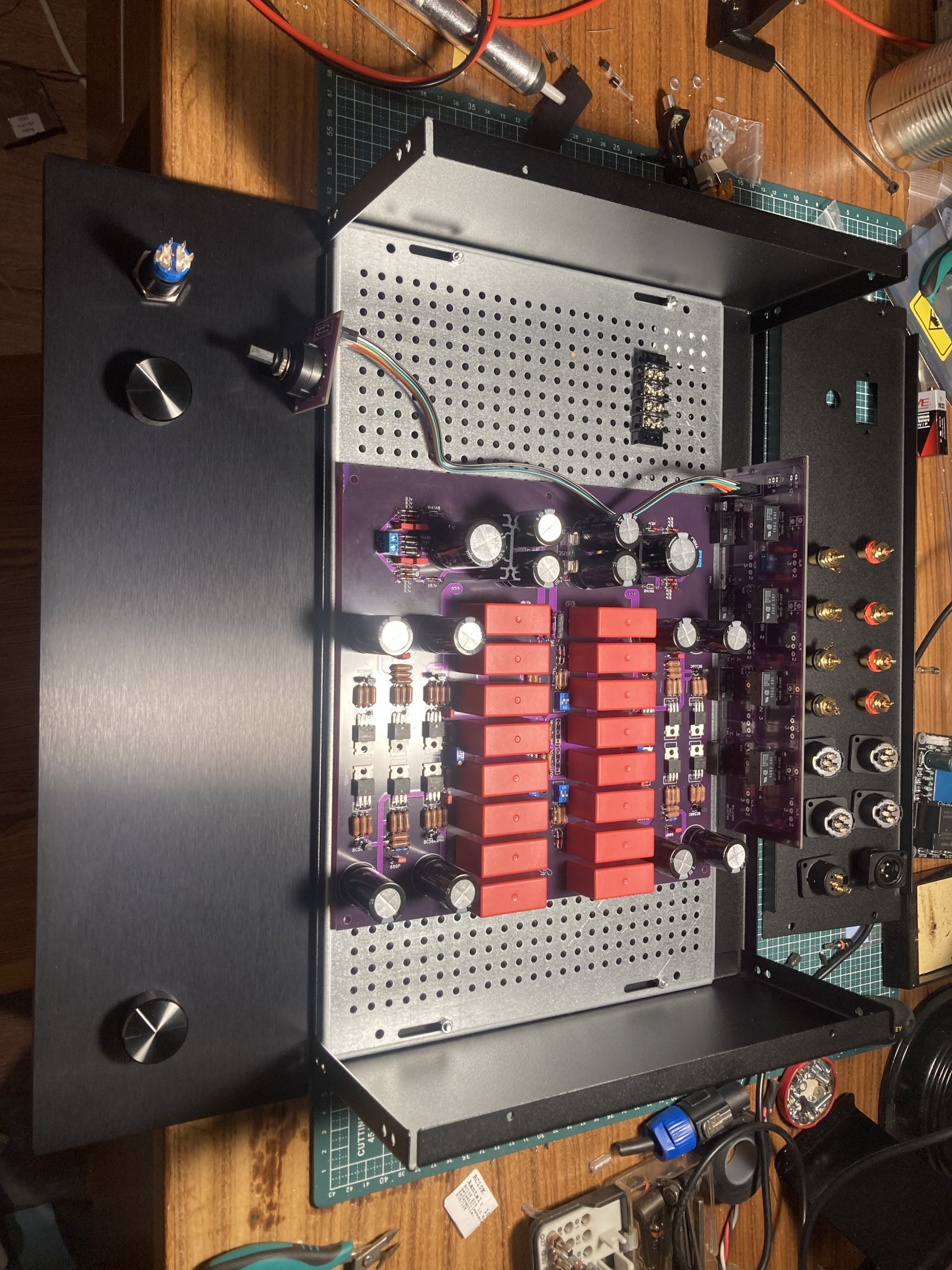

Lay-out considerations... Keeping the inputswitch on the right kind of messes with my head. But it's the most logical given the circuitboard layouts.
We'll see. Couple of weeks waiting for the transformer... See if I can cobble something up to test the board already.

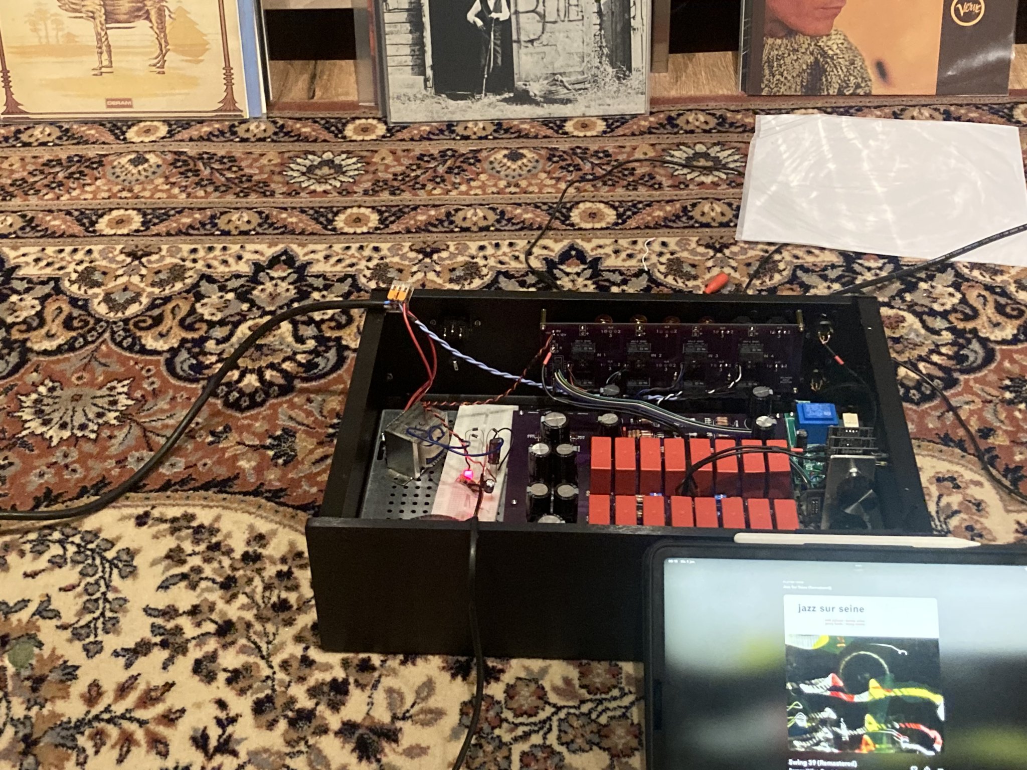

Pretty hectic weekend but got the thing running. Checked both channels but gotta keep it mono until the Toroidy gets in. Only had a 2x 35v transformer kicking around at 50VA. Not much but OK for testing, turned it down to 60 volts with a Variac.
Breadboarded a simple 12vdc supply for the relay PCB... Wasn't completely foolproof. Got the switch in the wrong way round. Have to fix it and tidy up the wiring. Pretty happy as is, no magic smoke or blowing fuses... All good. Least favourite thing still has to be done as well... Drilling the frontpanel. ;(

Hi Andreas, can't detect any problems as of now. Have been using the preamp for a while now but will need to swap out the LED's for the channel indicators as they are too bright for my liking... Otherwise no complaints about this thing. Sounds great!
