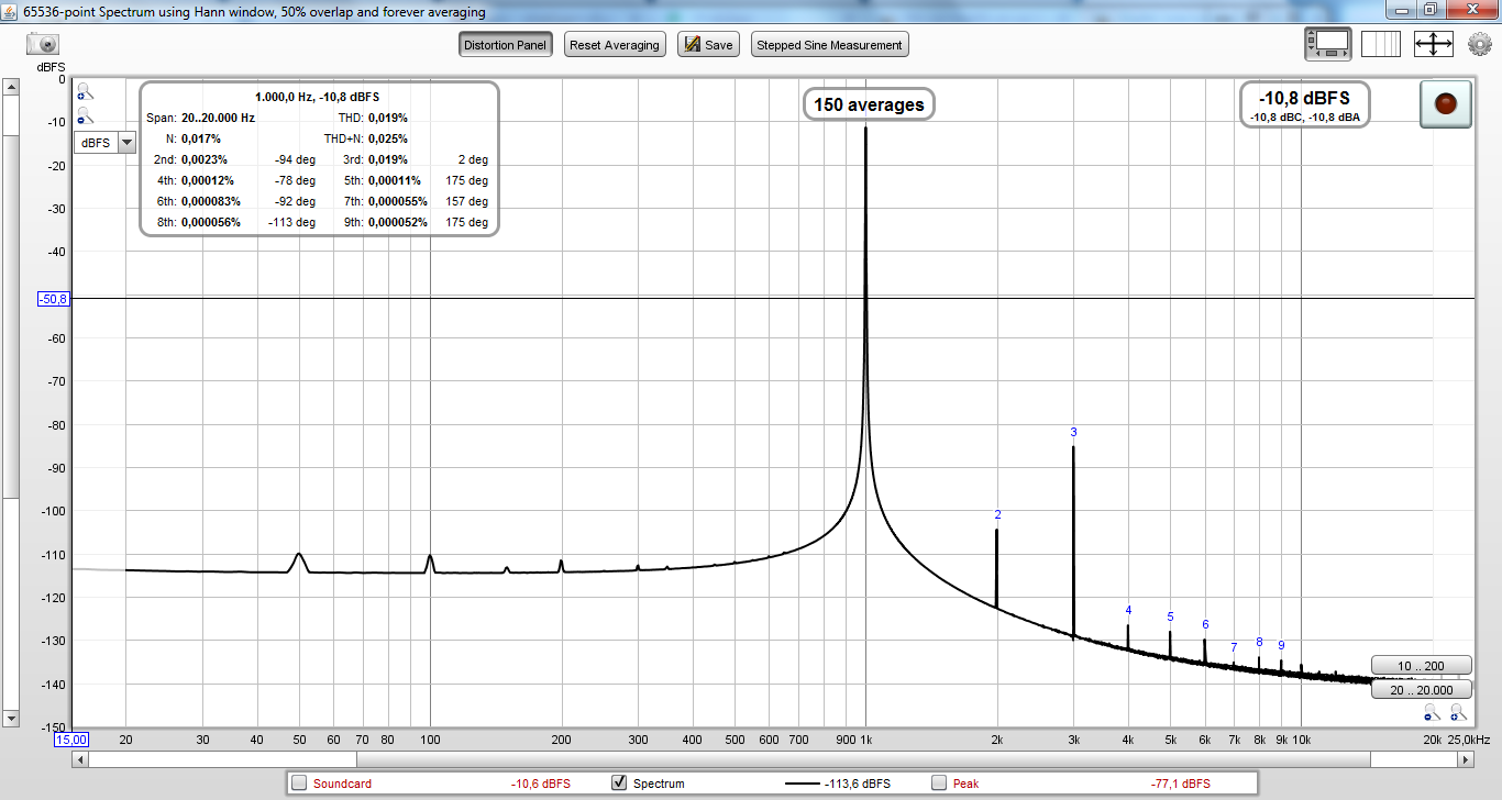

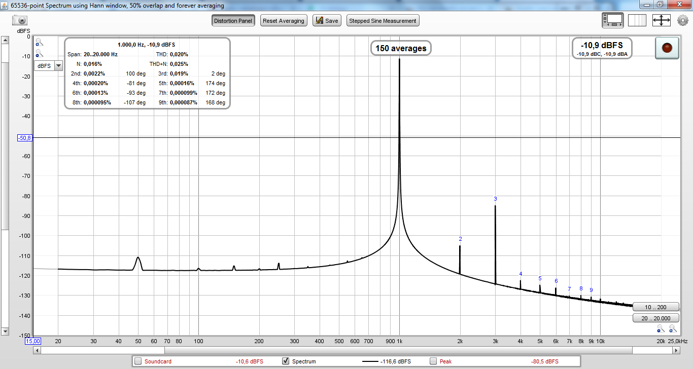

I used REW to have a look at the output of the amp (with the 221R resistors in series with the input). I think I have tamed the oscillation.
Interesting to note that I measure dominant in-phase 3rd harmonic. I am new to REW and similar software, so not sure if my measurement setup was correct. More testing in the coming days I think.
nulling of 2nd is normal thing with balanced stages
you need to deliberately spoil symmetry , to invoke 2nd
My experience is that the Aleph P 1.7 sounds despite its k3 dominance with a good body.
Hearing it you could suppose that it is k2 dominant.

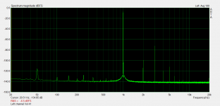

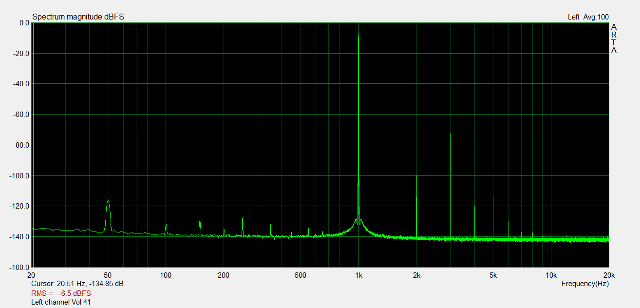

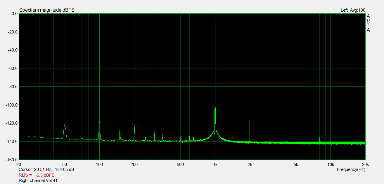

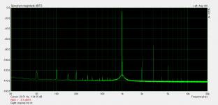

I have added 2 ARTA screenshots. They show some mains noise but with unpotted transformers in the amp case that is to be expected.

I don't hear any noise but the Arta FFT graphs above show there is some measurable mains noise. About 110dB below the primary signal, so it is fine. 🙂
I assume it can be lowered by moving the transformers and rectifier diodes to a separate box, but at this level I will not bother.
