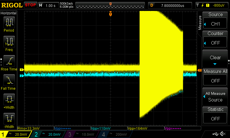

Could the psu voltage (that slowly creeps up to a steady state, in my case today 61.04V) be the cause?
Interestingly, the oscillation is also visible when the amp is switched off (3 secs while the supply caps are drained).
https://www.diyaudio.com/forums/attachment.php?attachmentid=732208&stc=1&d=1548664868
I had a look at the psu voltage (after the 3R3 resistor). It rises slowly (slower than I had thought) and oscillation stopped when it reached 60.67V. Switching the amp off produces oscillation as soon as the voltage slowly drops below 60.67V.
Switching the amp on again while it is still warm again results in oscillation that stops as the voltage rises, but with a warm amp the oscillation stop at a much lower voltage (56V) than when cold.
So, it seems there is something going on that depends on both voltage and temperature.

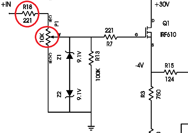

I read somewhere else that (as Gerd mentioned) the protective zeners at the input may lead to oscillation when there is no resistor between it and the input. Nelson mentions this in the Bosoz paper (and mentions the requirement of the input resistor) but seems to have left them out in the Aleph P1.7 schematic. Perhaps the Bosoz paper was written later (I did not check the dates).
Tomorrow I plan to remove the protective zeners to see what happens. If that does not do the trick, then I will have a look at the other gate stoppers and base resistors. Or perhaps add a small (100R?) Input resistor. The switchable 10k eliminated the oscillation but attenuated the signal too much.

After reading the Bosoz paper (balanced zen linestage) http://www.firstwatt.com/pdf/art_bosoz.pdf I wondered about the input protection zeners that Gerd had mentioned. In the Bosoz paper a 221R resistor was recommended if the builder did not opt to use a 10k pot before the input because the protection zeners could cause oscillation. Now, for me 221R is low enough not to cause much attenuation, and (lucky for me) the same value I had just removed from the gates of the gain irf610 gain devices.

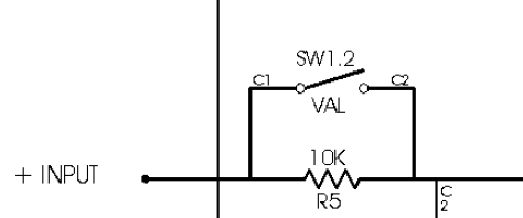

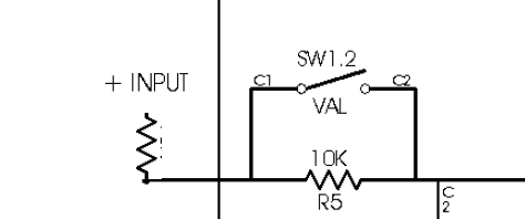

No, it really was in series. Perhaps the following diagram make it clear.
attachment.php
Original above. Modified below.
attachment.php

I am sorry, but I do not get your point. Both schematics show a labelled, ungrounded input. The modified version has an extra input resistor (in series with the input).
I was testing with inputs shorted to ground. That is not shown on the schematic.
Normal shorting would mean IN+ to GND and IN- to GND.
I wrote:
I inserted a 221R resistor between IN+ and GND and one between IN- and GND.
So, instead of a wire from IN+ to GND there was now a resistor.
To play music in the unmodified amp you first remove the short from IN to GND (obviously) and hook up your source.
To play music in the modified amp you first remove the short between the new 221R input resistor and GND and hook up your source.
I would not leave the 221R connected to ground, just as I would not leave IN connected to GND.
