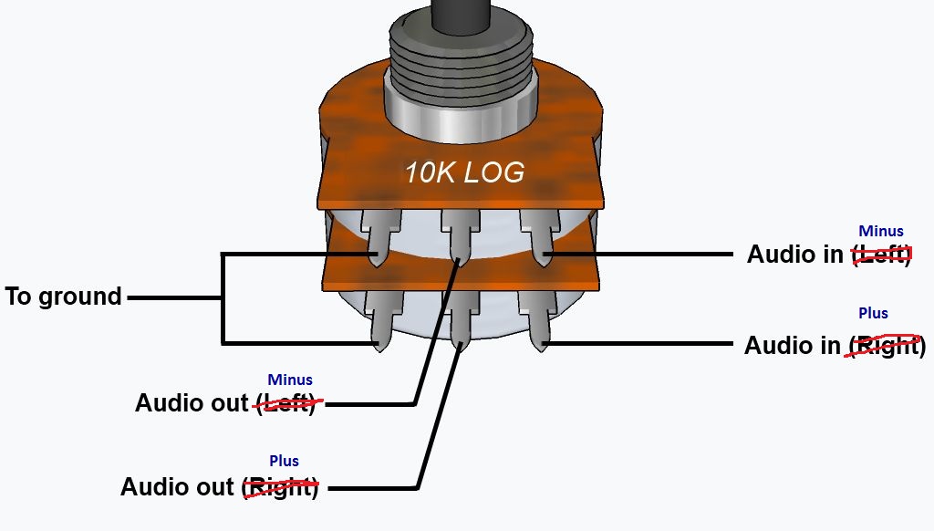

If I now don't get it right then the other solution is to apply a potentiometer/attenuator that I know is working so then my question is, do I think right when I want to apply this way, showing only one channel??
And if the thought descriebed in the picture is correct that mean that I need to use a 4-gang potentiometer/attentuator to get both channels right and left, balanced all way to the output, or....??
I hope I am getting this right cause I am not shure but logic is saying yes.
