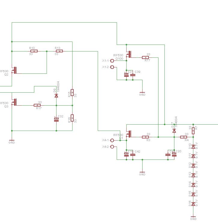

I had a idea to copy the dual regulators from X2 psu.
And make the same with the aleph p psu.
One regulator for each channel.
If i made some errors tips are welcome.

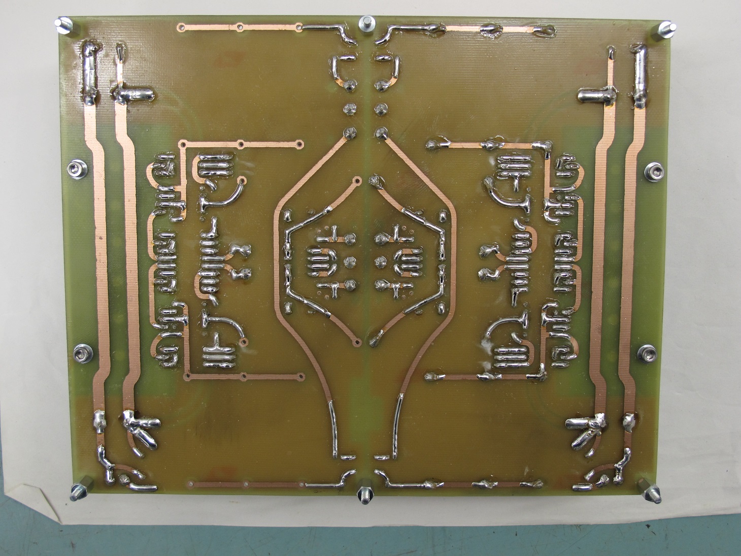

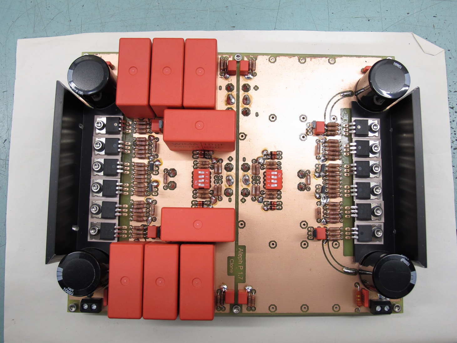

No im not an Radio Amateur. Im orientated very much at the aleph p clone from R. Stens.
But im not happy with 2 times the same pcb.
I wanted both channels on one pcb, layout in that way, that the Power connector and the Preout Pins of each channel are on the same side.
