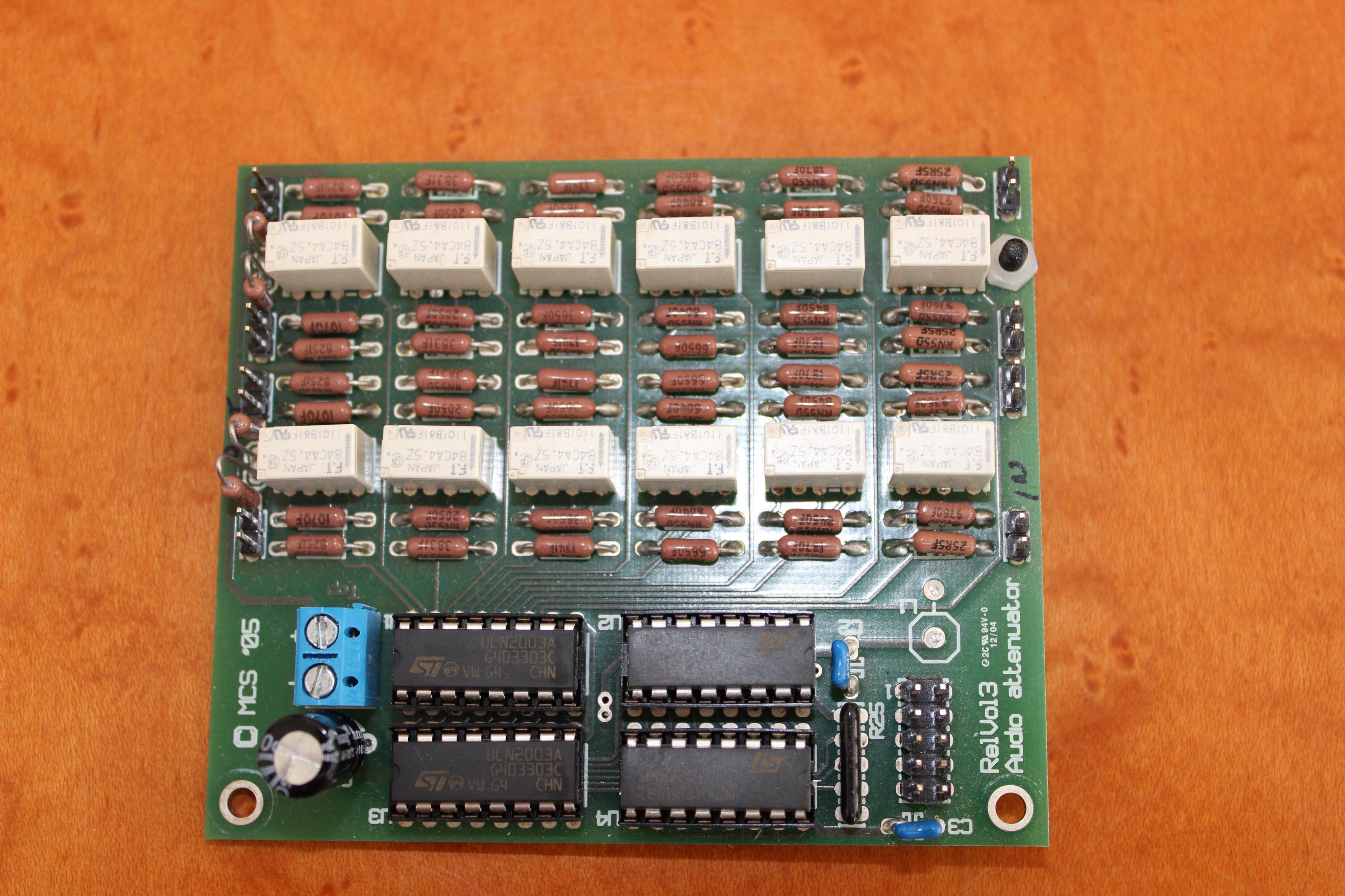

My AP1.7 was connected to a DIY Aleph J (balanced), but I am not sure if the input impedance of the poweramp is the issue.
I wanted to make sure the problem was really due to my RelVol3, so tested my RelVol3 board as follows:
- Signal generator to input of RelVol3 (I tried L+, L-, R+ and R- in turn)
- Scope on RelVol3 output
- Change volume and observe
The RelVol3 board was connected to the other Dantimax parts (power and logic only, no signal) in order for it to work.
You can see the distortion on the scope as I changed volume https://youtu.be/WvkQ2TlmWj4

A picture of the board from both sides would be nice.

Thanks Mixon1,
Because the distortion occurs on all 4 lines (L+, L-, R+ and R-) I do not think it is due to a single faulty relay or single cold solder, unless the cold solder would be in the control section. But it is quite possible that I have overlooked something
I will try to take some decent photo's tomorrow and would appreciate it if you would have a look.

Hi albertNL!
I cant see any direct problem, maybe little too excess of solder, hard to see cold soldering because of that. In other area its looks like you have heated to much, damaged the relay? Not sure..
But why have you desoldering the iron core with line? It should be mounted, there is a reason that the designer chose to put it where it is.
Othervise it looks ok. with me.
Any other DIY'er see anything strange about the card?
Edit: When I took a look again, I see a relay (two, actually), that have what I suspected cold solder, take away excess of solder and re-solder them.
Hi Mixon1,
Thanks for checking.
It forms a connection between audio ground and negative line of the Dantimax PSU. I removed it hoping the problem was due to Dantimax PSU switching noise contaminating the audio ground but it did not sovle the problem.
Which ones?Edit: When I took a look again, I see a relay (two, actually), that have what I suspected cold solder, take away excess of solder and re-solder them.
Hi albertLN!
If you see the soldering side of the PCB, the upper line of relays, the third and fifth counted from left side, it is hard to see on picture, but I think it is possibly a cold solder, it's look like the solder point on a couple of legs not wet the PCB traces properly?
Hi Mixon1,
When I look at the pcb itself it looks fine. I will re-heat those joints, just in case, but do not think it will be the cause. Remember that the problem exists in the R+, R-, L+ and L-. Both relays are in L (or R) only.
Thanks for helping out.
albertNL
albertNL
