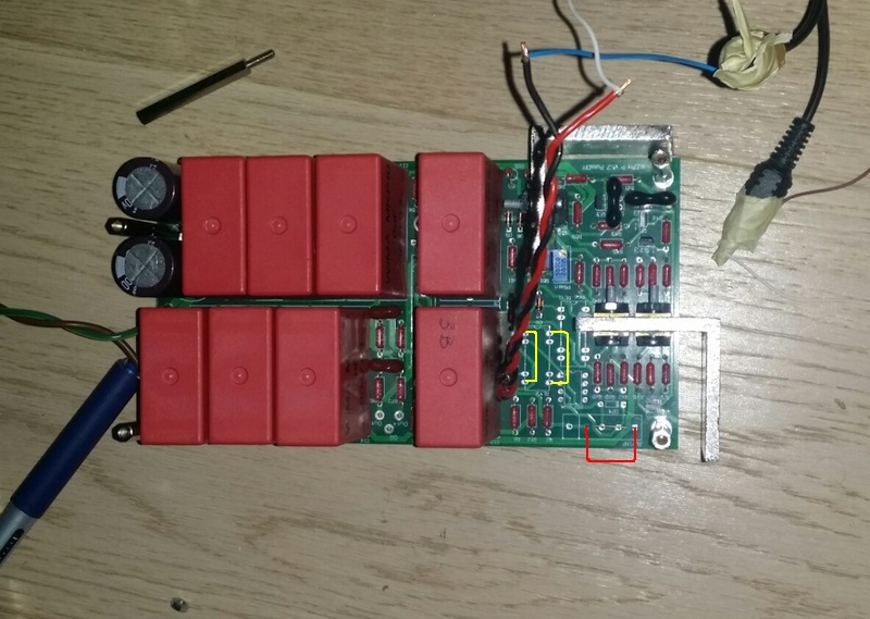

I have 6 channel of those P1.7
and have hard time understanding how to make them work...
those are Koja PCB
have solder all the parts, except those relays as I have no plan to use tham
the input is SE so I shorted pin 1 and 4 on first relay...
Now I power it, with around 60V (more like 65V AC) and have 60V regulated
Q23 (on original P1.7) scheme is relay hot...can't touch it...but it have 60V on output..
the thing is that I don't get nothing on output
I have connect input and try with small speaker at the + and 0, or - and 0... but no sound
does any one have idea, did I skip to solder something, some jumper as I don't use those relays ?

I'm not sure where you have jumpered. You only need to put 2 jumpers on RLy 2 which is right beside the input connections. The jumpers go between the end pads on each side of the relay. See the attached photo of one of my boards.You can see the jumpers which have white heat shrink on them, just to the right of the input cap. I am using Axon caps. 30uf for outputs and 13uf for inputs.

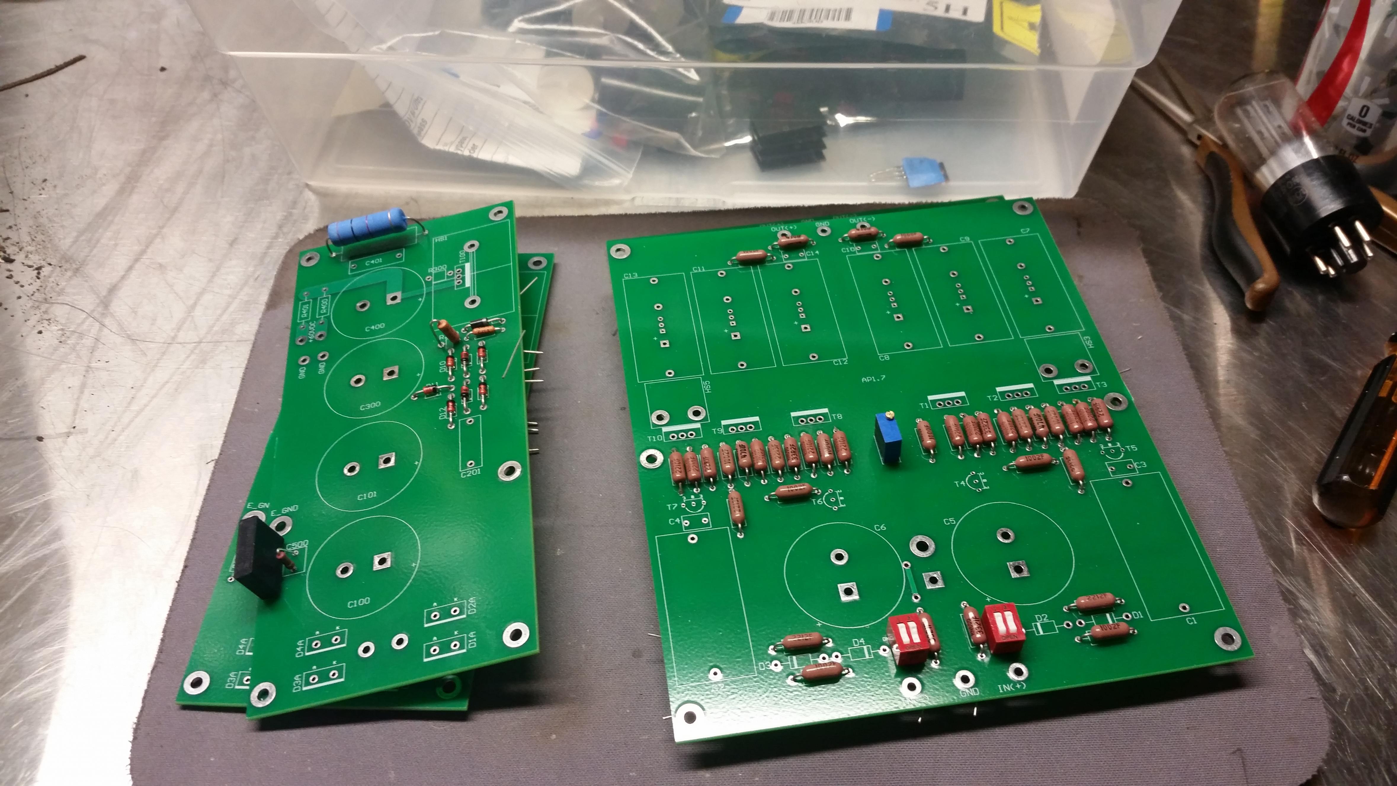

Anyone recognize these Aleph 1.7 PCBs?
I've been planning on ordering the remainder of the parts but wanted to do a little research on their origin before I buy anything. They look pretty true to the schematic but I wanted to check just in case...

I will use only SE inputs, and it will be a part of DSP so I don't need to swich anything, once it start to play music :D
[/ATTACH]
Thanks Bfpca
On picture, belowe, I have draw with ''red'' what I have jump over ( as I understand, it should be jumped for SE inputs )
and will place ''yellow'' jumpers as you advised, once I get home from work :D
I hope it will do the trick but I'm affraid I did something wrong as I tought that it should play withot those jumpers that you have placed :D
will see...thanks
Looks like the "Veteran Boards"
See also this thread.
Nick

Yes, the red jumpers would ground the - input and allow SE operation. The jumpers I put in are to bypass the 10k attenuator resistors R5 and R6. I did not put them in on my build. If you have the attenuator resistors installed you would still get an attenuated signal through them without the jumpers I used. I don't think that is your problem. It looks like you have separated the power supply from the rest of the board. If Q23 is getting hot then you can measure the voltage drop across the 3.3 ohm resistor R73 to determine how much current the board is drawing. It should be somewhere around .23 volts for a typical 70ma current draw. This will give you some idea if the current sources etc. are working.
You can also measure the voltage drop across the 22.1 (R44,59) and 33 ohm (R55,70) resistors that set the currents. They should be in the .65v range.
no luck, still no sound when I connect speaker on unbalanced output + and 0 (- stays unconnected)
I should have sound when I play something and connected this way ? (with SE input + and 0 (shorted to -)
I have
0.22V over 3.3 for around 59.6v
have 0.61V on R44 and R59
and 0.63V on R55 and R70
whats next to check ;)
tnx
(is there some place (schematic) where I can check referent voltages (over resistors etc.) for P1.7 ?)
Those readings all look good. Using a speaker to measure the output is not the best plan. The output impedance of the Aleph p without the attenuator is about 2kohms so you won't get much sound from a low impedance speaker across the output. you should be able to use a DVM on AC volts to measure the output. If you do not have the gain control shorted or wired up with less than 2k resistance you will get very low gain. If you short it you should have a gain of something like 8. If you are using music as a source you should still see a fluctuating AC output voltage on the meter display.

I was thinking that P1.7 have enough ''power'' to drive speaker...
will try to measeure some AC at the output...
maybe play 1khz sound to see what will I get...
tnx
I have some reading when play 1kHz tone (from tone generator), so Ibelive it's working :D
will take some time before I connect it to some amplifier...
still have some work to do :D \ 5 more to go :D
thanks all for help
Bfpca I own you a beer, let me know when you come to Croatia :D
