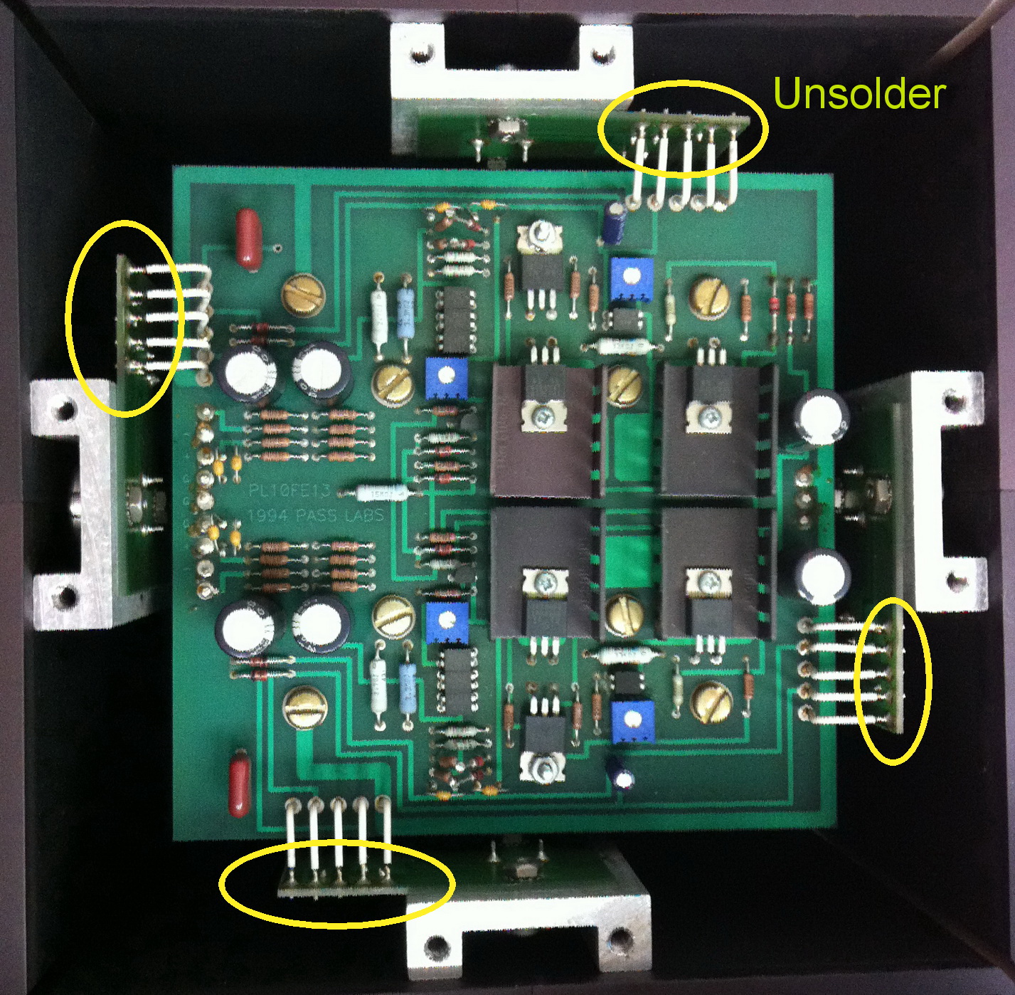

first cut those white wire bridges (later replace them with new ones )
rest is self-explanatory
(use solder-sucker for cleaning old solder , to have free solder-holes for new bridges)

Before you cut the wire bridges, un-screw the finned heatsink from the U-channel. There should only be the screws holding the 2 parts together, as the output transistors mount to the U-channel.

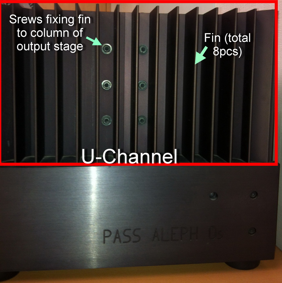

U-channel means ...
Dear 6L6,
Thanks for your advice.
To clarify the term of "U-Channel and fin," I attached the picture.
Is my illustration correct?
Then, if I release 6 screws x 4 sides, 8 pieces of fins are disassembled and core of U-Channel (4 colums of 8xIRF244 output stage + PCB + 4 power caps) will be revealed.
Do I correctly guess?

Dear 6L6,
Yes, you are correct~
I did release those screws a few months ago but hesitate to disassemble my Aleph 3.
Because I can't figure out how to start disassembling them.

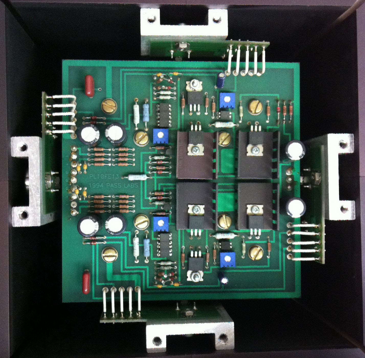

The U-channels would be the 4x unanodized aluminum you see on your top view pic. These 4 run the total height of the heatsinks and hold the TO-3 power mosfets. These U-channels also hold the heatsinks upright with the black Allen bolts you see on the sides.
I would guess the 8x big flathead screws on the top view pic connect and mount the 4 power supply capacitors onto the circuit board. Two each diagonally per cap.

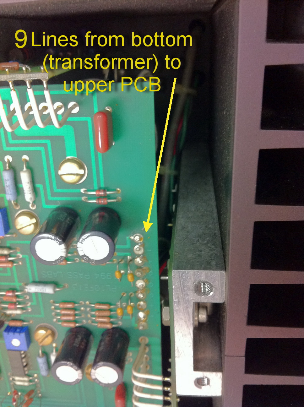

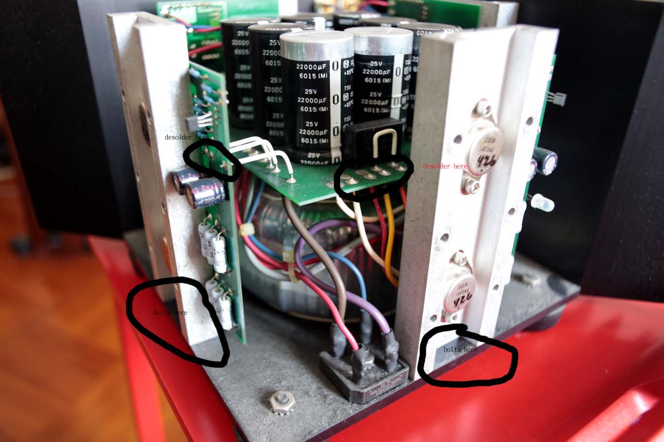

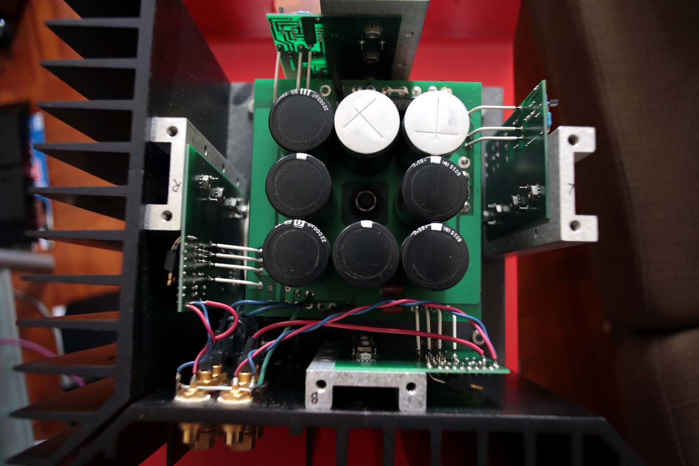

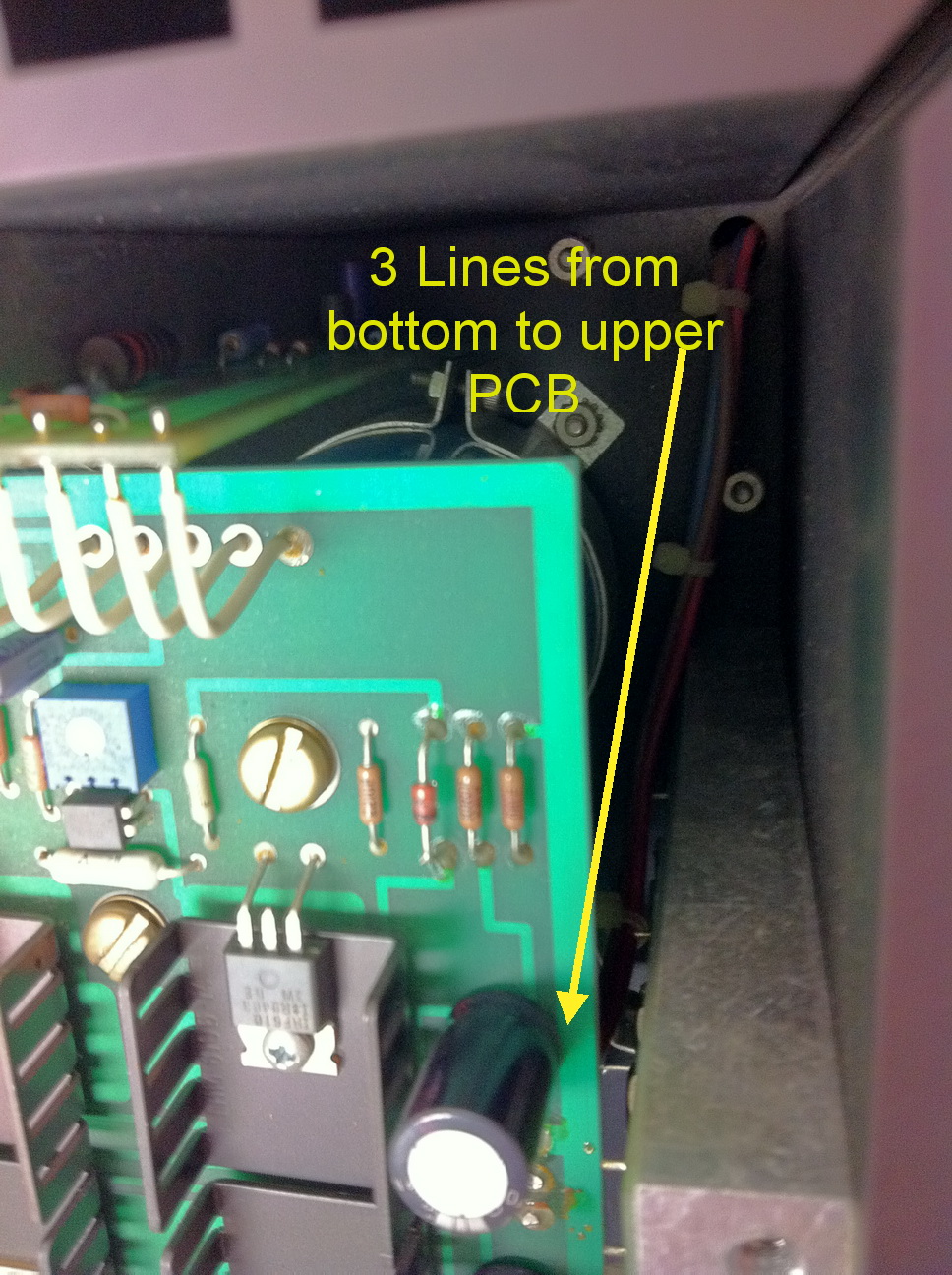

Albert, It is not neccessary to cut the wires.
Please refer to the following photos.
After a close inspection, the wires can be de-soldered.
Refer to the photo 1, after desolder the wires from the PSU board,
the PCB can be un-screwed and removed from the chasis.
However, I am not sure how to un-screw the bolt at the centre of the PSU board. (see photo 2)
Inside Aleph 0s (U-channel)
Thanks, B&W_Arthur. Aleph 0s is structure is different from yours as attached pictures.
With releasing 2 fins, I can understand the simple structure of upper part of Aleph 0s.
To replace power caps, the sequence is
1. Remove all 8 fins (unscrew total 24)
2. Remove hood (it should follow Step 1 to hold mechanical support on columns at Step 1)
3. Pull out (unsoldering, not cutting) 4 x 5 lines between PCB and output stages
4. Release 4 x 2 screws of power caps
5. Release power cap clips (it should follow Step 4 to hold mechanical support at Step 4)
6. Lift the PCB. At this step, you don't need to unsolder upper 9 power lines & lower 3 power lines from bottom part. The lines are extra long to give some free lift distance.
7. Replace caps one-by-one
8. To check whether there is mistake of short or not.
9. Reverse steps from 6 downto 1.
BTW, there is no mark of thermal paste between fins and columns. Anyway, I'll apply thermal paste (very thin) at interfacing surface among them.
