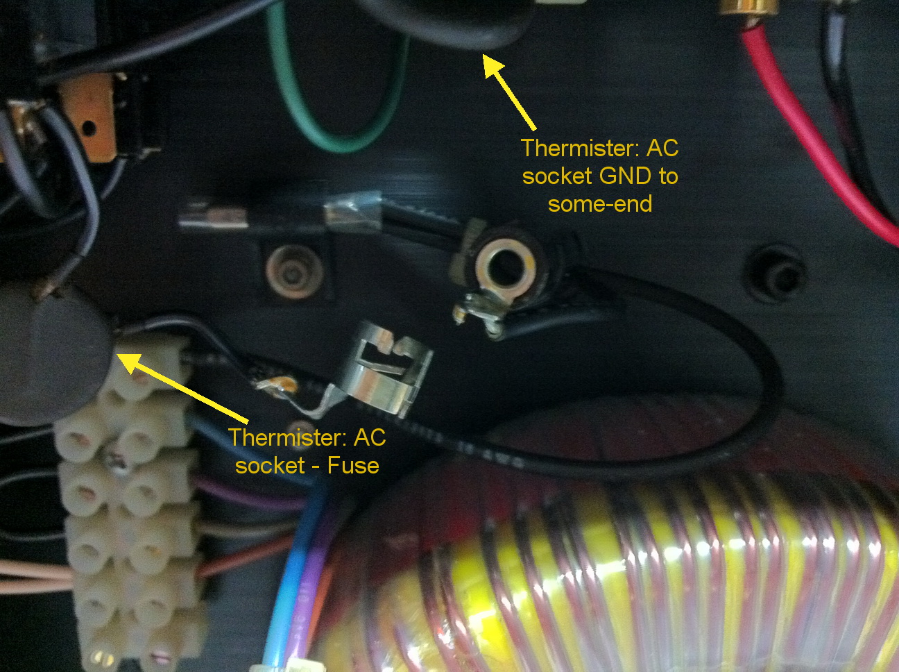

Dear Zen,
I found the case of hum.
When all input (RCA, XLR) are open (not connected at all), no hum.
When RCA inputs are from pre-amp, very small hum as I wrote before.
When the same RCA output form the same pre-amp to another power-amp, no hum.
What should I do? To connect GND between Aleph and the pre-amp?
do you have thermistor between audio gnd and case ( safety gnd) ?
ih earlier series it was 2R7 resistor , later replaced with CL60
