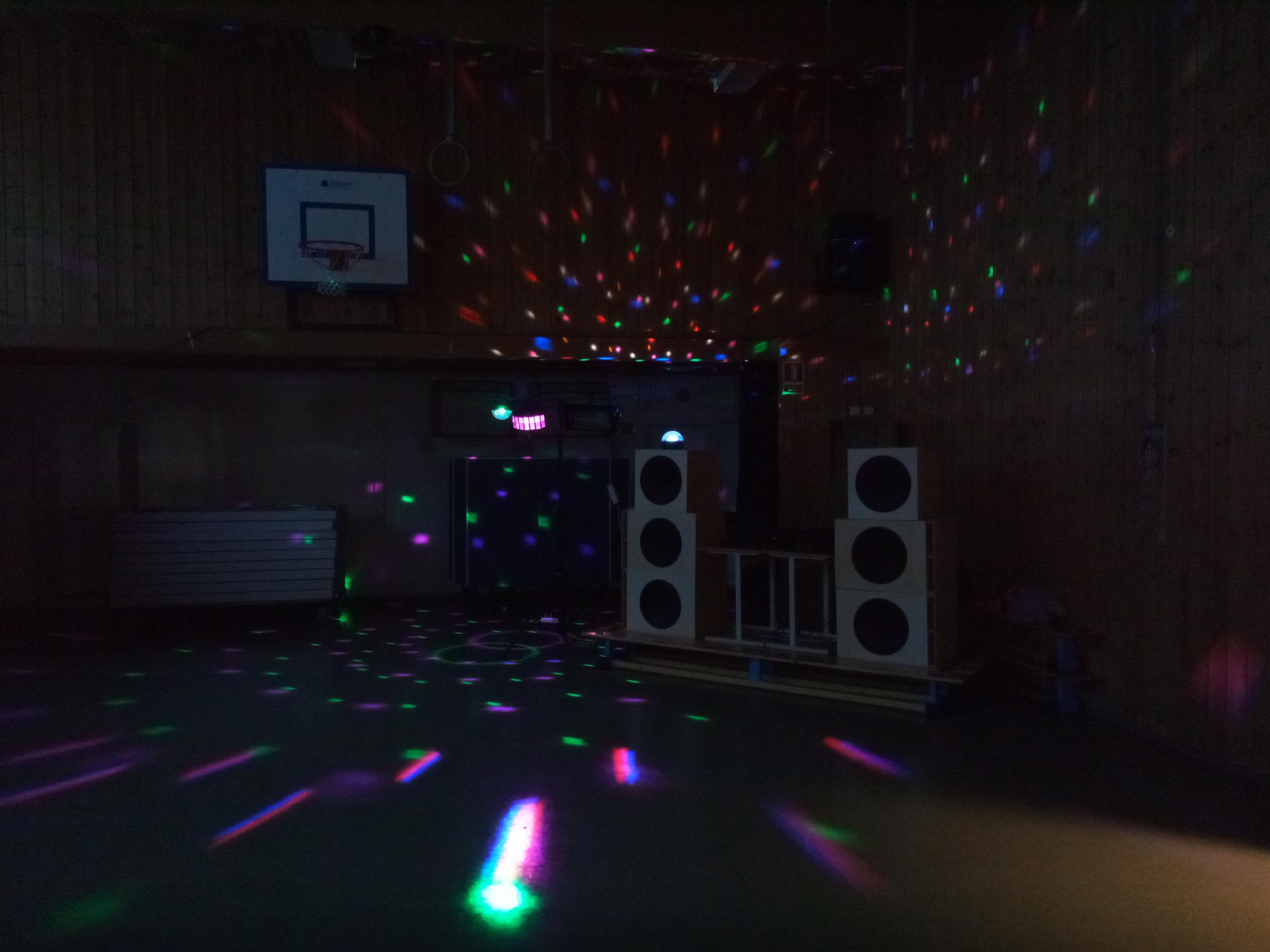

I would have no problem getting in trouble with 15w/channel, I was able to get the green signal light on a little bit when I volunteered my hifi setup for a disco a couple weeks ago, completely failed to achieve clipping, and no compression lights on, even though it was really loud at times.
Maybe I can try again in august, the setup is in the garage now, tidying up the place for the sales process, photographer comes tomorrow.
Somehow the real estate guy thought my 6 x 15" setup was a bit excessive, and wanted something smaller, so down to only 1 x 12" + 1 x MA10.2 per channel. No details, no dynamics...

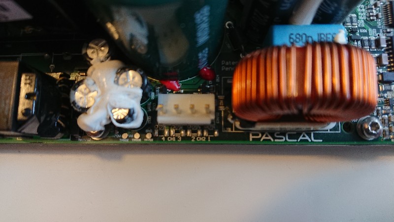

Hi guy, I am Using s-pro2 and S-a2. Checked big capacitors on board - they are only 80V (while supply is 70V) and 85C rated.
Have anyone tried to upgrade for caps with voltage 160+ V and >100 C ? With bigger ripple current also? Any impressions?
Waste of time most likely. I am sure the current caps are good enough from an engineering perspective, so what you gain is most likely just some theoretical extra lifetime - which you might never see and never need either.
Friends of mine were experimenting and comparing with another PFC SMPS and liked higher temp/voltage/ripple variant more also with subjective listening tests.
