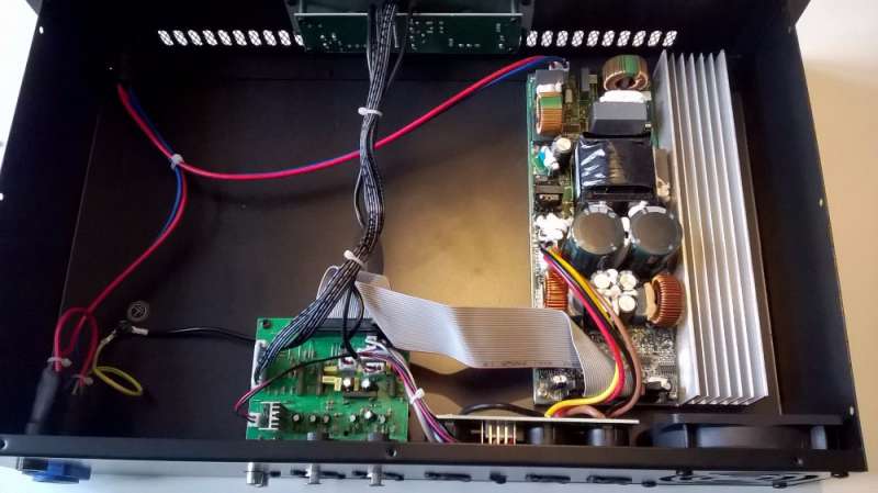

It have lots of power, and have a vary good low end performance on my four times 10" open baffles with massive eq. They are completely cool and silent (fan never kicks in - only at 85 degrees celcius). This amplifier is also very good in the high.
I am no high end guy, sp I will not comment on depth etc, but it's definatly there.

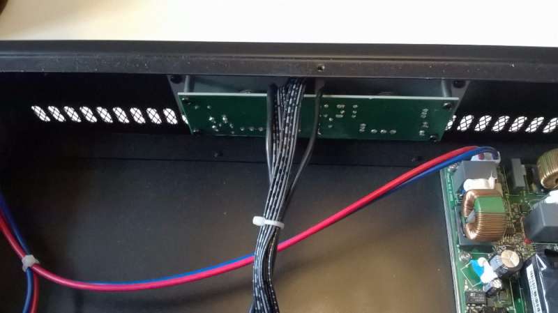

The case is fine for the price, and only one third is used inside, so lots of free space inside. The potentiometers is not very good, they can have scratching sound when you touch them (not always).
If they should be modded it does have a 26 connection flat ribbon, but no indication of what the connection are. But, for the modders a new and strong preamp section, could probably make this amp very very good. But, I don't really miss anything.

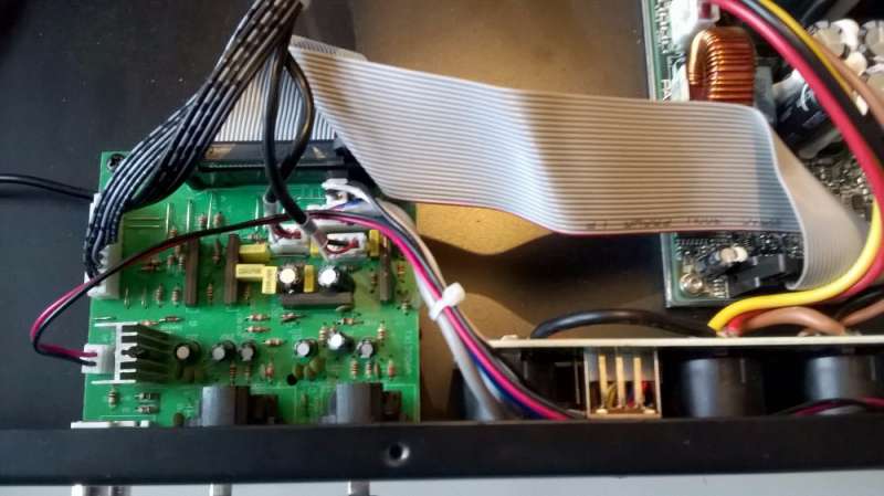

The inside of the IMG STA1000D Pascal amplifier. Op amps are NJM4558LD. I plan to try another front end. Either based on better op-amp or a low impedance discrete preamplifier.

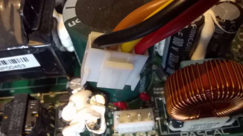

To bypass the preamp is quite easy. There are a connector on the amplifierboard. Just take it out, and you can access the input pins directly. I will take some photos when I'm doing it.

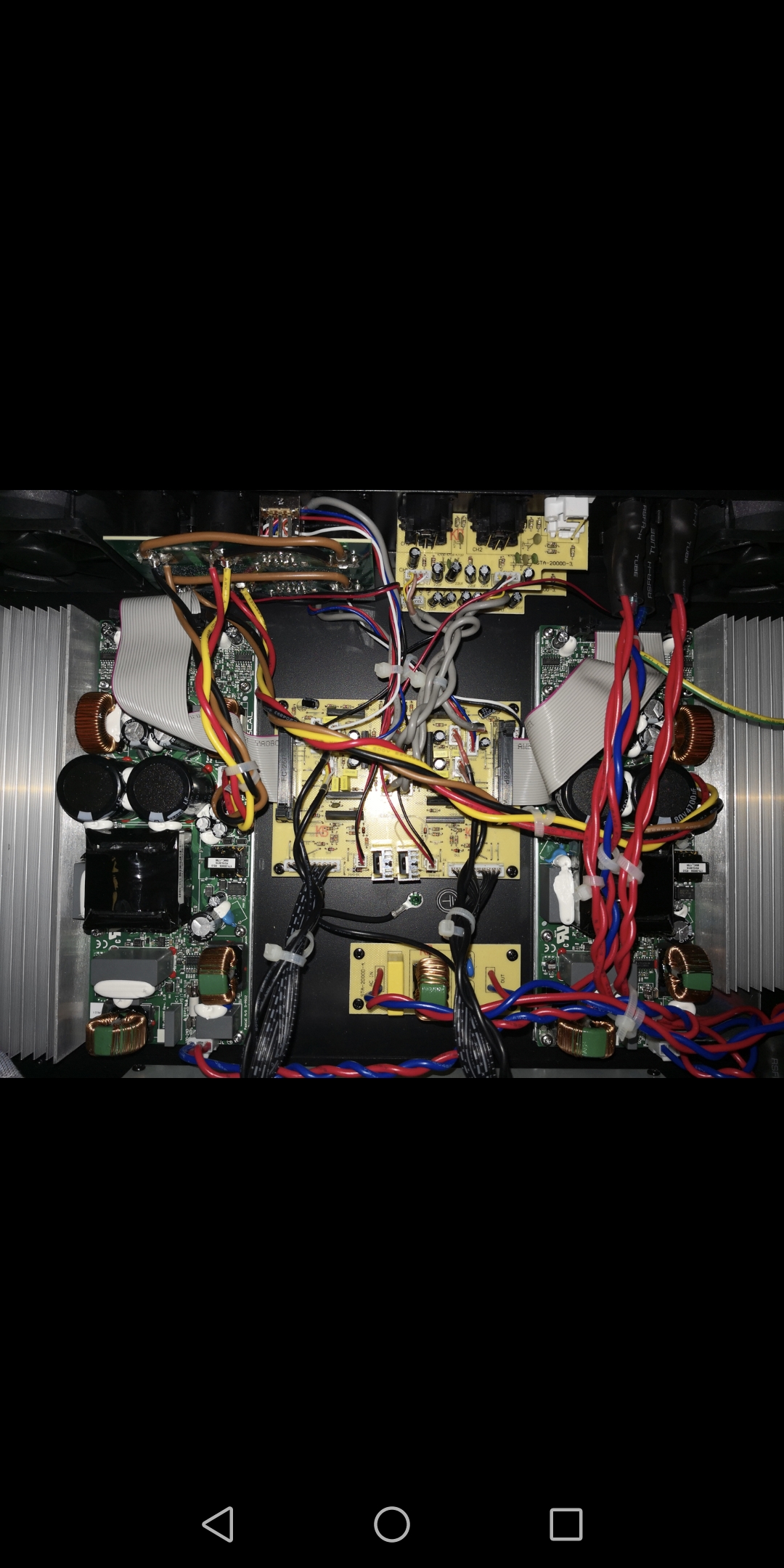

I use a IMG 2000D the best are the Pascal Modils inside. The sound is very limited until some changes i think. I found inside a little funny board with an EMI filter wich obviously filtered not only EMI, Sound also.
After removing it the sound was much better...
Another part to change is the input i think.
At diyaudi wrote a member that he just removed just 4 resistors and 2 coupling caps to bypass the electronic for direct input to the s-pro2, he uses the 1000D, the input is only one bord, at 2000d the input is split to three boards, i dont know exactly wich parts to remove for testing.
