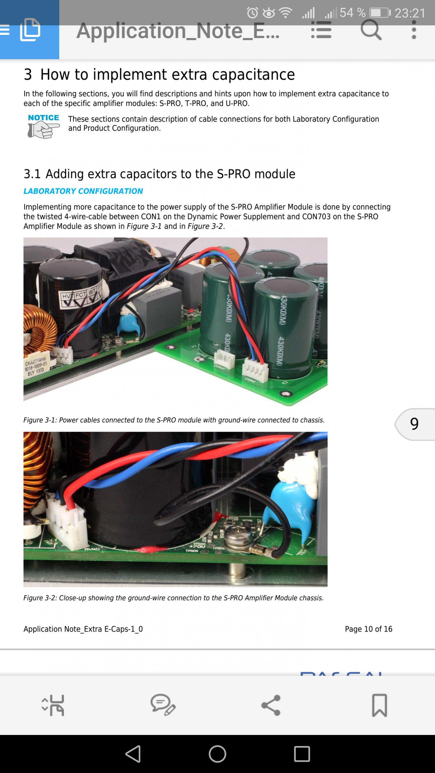

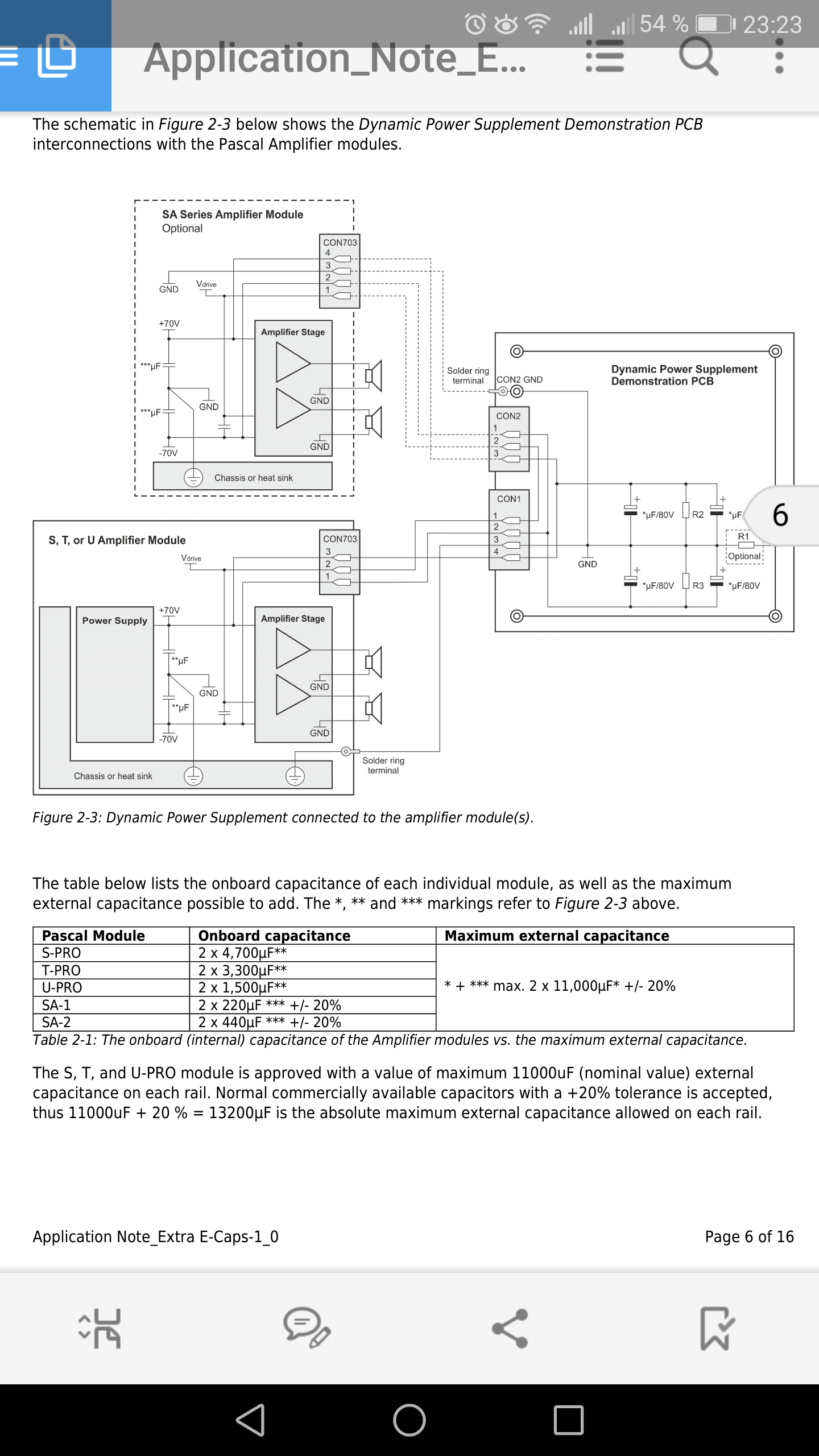

Hello,
i make 2 Screenshots
from the Power Extension PDF s-pro 2.
I think it's very interesting with the Power Extension but I don't know how exactly to produce them. There are no finished ones to buy.
You have make it on your own.
