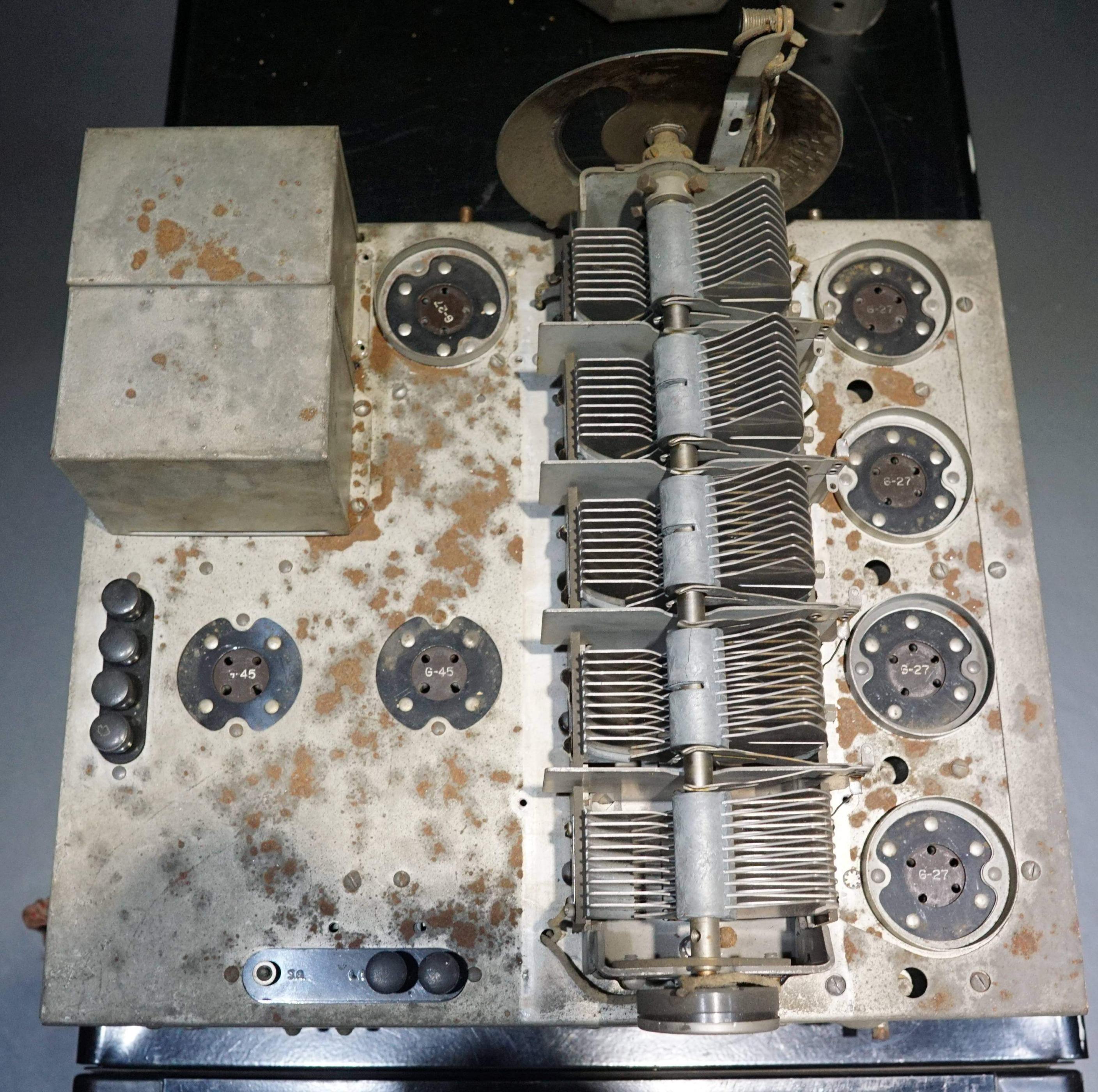

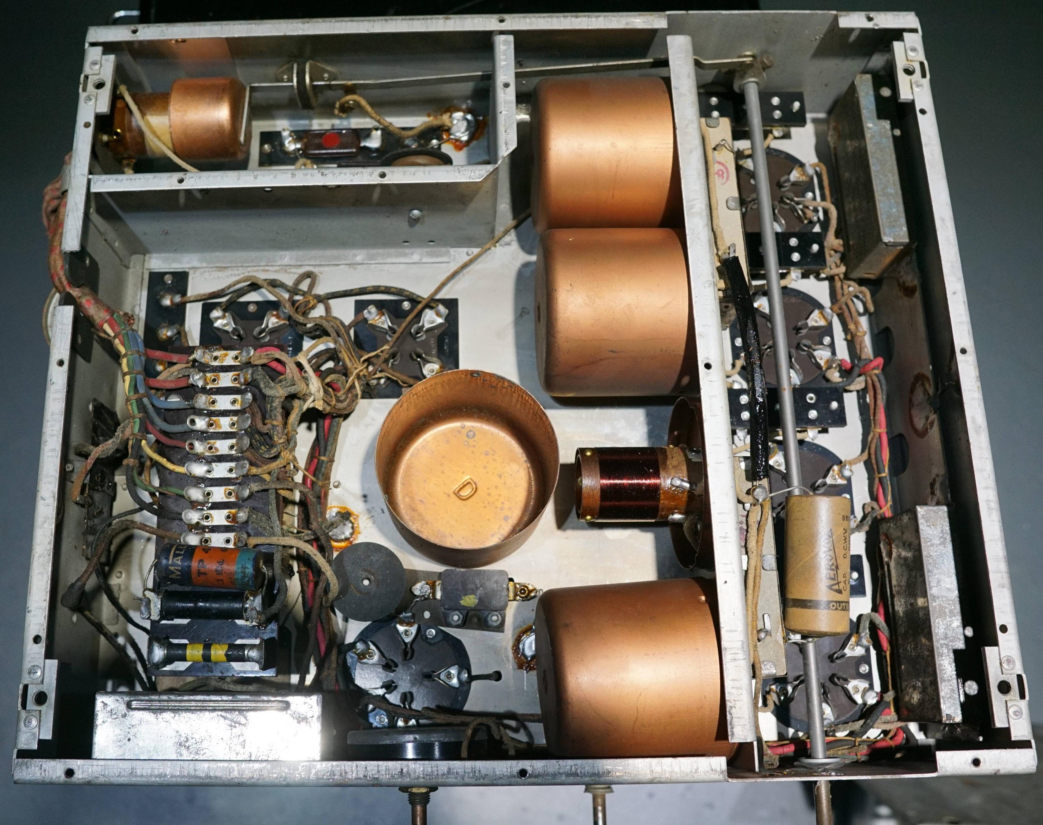

Majestic radio chassis parts salvage?
If a separate thread is more appropriate, do advise.
I have the remains of a Majestic Model 90 radio chassis.
Anything here obviously worth salvaging before I further dissect it?
(ignoring the obvious - chassis itself and tube sockets)
If not, I'll leave it more than less intact and plan to pass it along.
e.g. What are:
- these coils within the copper cylinders?
- the (topside) large seemingly potted metal square structures?
- the 4 '~ deck of cards' sized units (interior, right side, 2 oriented to show ceramic innards) are these caps, resistors?
thanks!

Hi Gearfreak
that looks like its waiting for an owner to lovingly restore it so please don't scrap it.
The copper cans look like screens for the coils and the potted 'chunks may be transformers that have been potted to keep the laminations it place.
I would have a look at some of the vintage radio sites and ask if anyone maybe able to give you some further information and maybe an offer.🙂
Regards
Mike

Thanks Mike. I agree with the sentiment, but to your horror, know that I had the entire thing (highboy), and probably all that was wrong was the power supply. Alas, despite increasingly generous pricing and the ultimate in proximity to our eastern seaboard's primary thoroughfare, I got a sole lukewarm bite that went cold. The cabinet did get a lot of traffic when offered for free. From furniture flippers we presume.
So yes, alas most of it has been discarded bit-by-bit for lack of storage and the need to make way for repairs to a leaky roof.

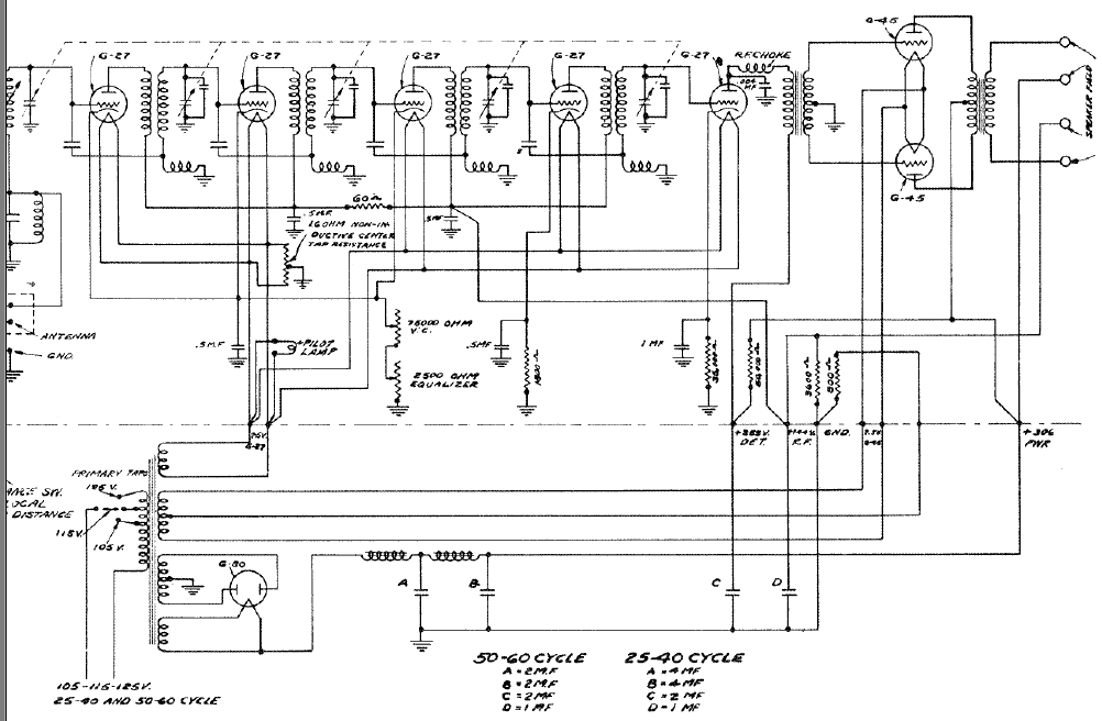

Coils tune with the 5-gang variable capacitor to select a frequency (station). This is a really slick TRF radio; soon "obsoleted" by superhets.
The big square cans are probably power and output transformers.
The "decks" are probably power resistors to drop voltage.
Somebody "should" want all this stuff for restoration material; however radio collectors are a vanishing breed, and most already have a lifetime of projects.
The two '45 tubes, the '27 tube before that, the interstage and output transformer, IS an old-school Audio Amplifier. Fix it up (you need $$$ tubes and maybe some missing bits like fake field-coil), put your iPod to the last '27 grid, there's some fine sound in there. Mono.
In the cold light of day, if you can't find an Enthusiast, it's just junk.
