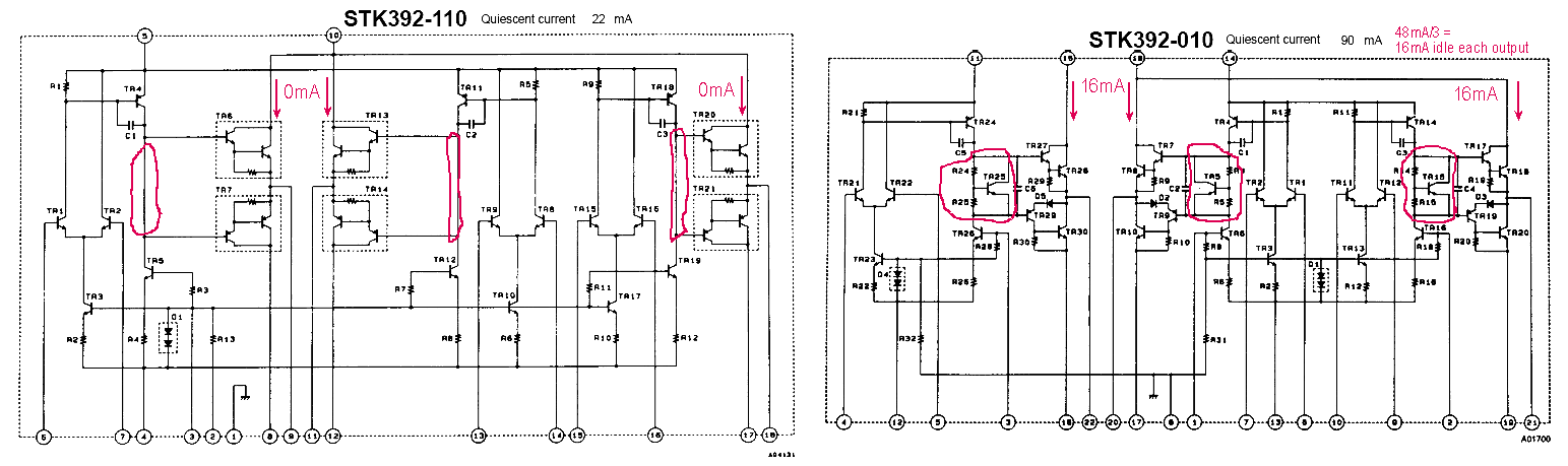

...Sanyo STK392-110.... any use in audio...?
They "are" audio amplifiers withOUT idle bias. I predict significant crossover distortion on small signals.
What you want is the -010 part which does have output stage bias. However I suspect for ordinary TV use, most makers will/did settle for the cheaper part.
It also is not clear what gain it is stable at, since it really is not intended for voltage feedback. And I have a feeling it is good for more V and A than power; maybe no-matter for TV correction but may overheat in audio. Also complete lack of protection from shorts-- supposed to be nailed to its load, not brought out to screws for easy user screw-up.
Thanks! Yes, I've seen the lack of emitter resistors and bias circuitries for the power devices. So I'll better scrap these hybrids, 'cause I'm really not too eager to build a colour TV 😀.
Best regards!
Best regards!
Actually the AB part does not show emitter resistors. Maybe they trust the matching to the Vbe multiplier, or maybe just "simplified".
It occurs to me that *two* focus channels, outputs linked with part-Ohm resistors, and offset voltages in the inputs, would get the pure-B part into AB. But now you get just one audio channel per whole module. Does help with power dissipation.
With just four stages of current gain (and no other fancy tricks) it is unlikely to be real low THD.
