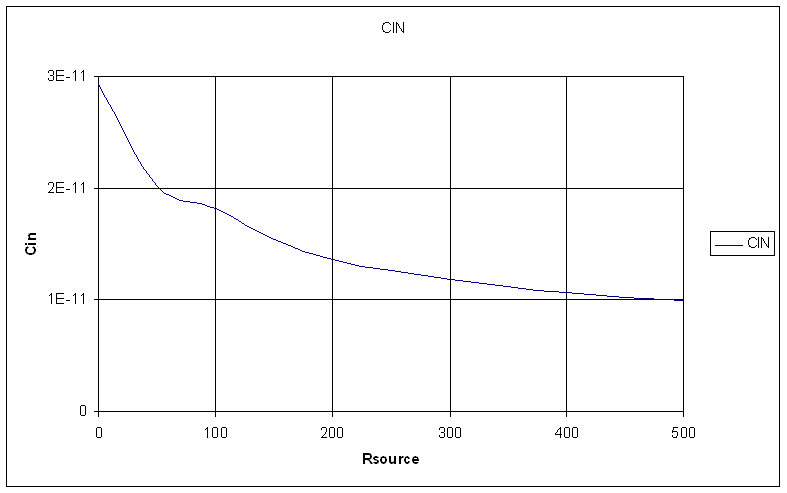

That was not the point here (obviously). It was not about non-linear capacitance per se, but input capacitance as absolute value. At the signal levels we are dealing with for MC/MM Phono the non-linear capacitance impact is still quite small, compared, for example, to a low gain Linestage application.
The concern was the 75pF Ciss per 2SK369, which would make a serious (but in actuallity not that serious) input capacitance, which may cause trouble with MM Pickups.
And then there is the 15pF Crrs, but that is largely neutralised in this circuit (it is also actually the more non-linear of the two), however that too is cut by local degeneration.
If we add local degeneration that will drop the Gain by 20dB we need to drop Gm by 20 dB and as a result we now "bootstrap" Ciss and reduce the Miller amplification of Crss cutting their effect to around 1/9 of the original undegenerated value.

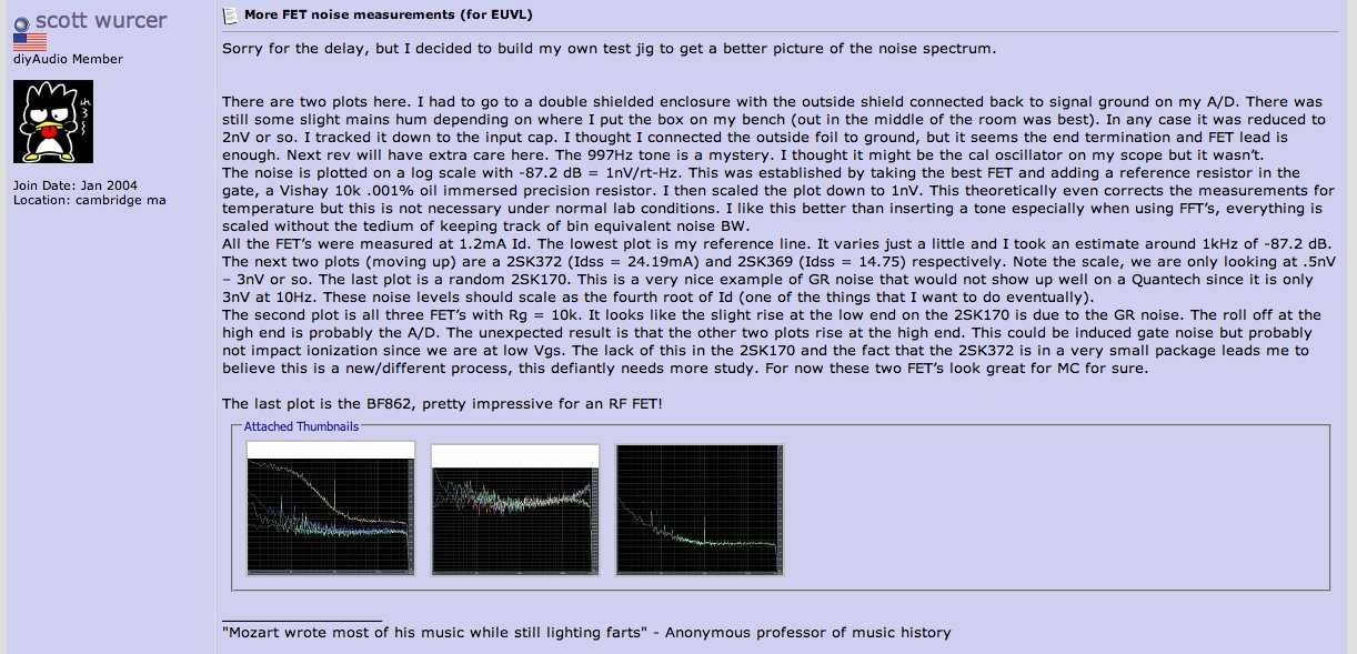

Here is a measurement of a phonostage with 4 plus 4 2SK170, 2SJ74. The red track is my Lyra Olympos producing 0.3mV at 5cm/sec. The noise of the phonostage is comfortably lower then the noise it makes "when the stone hits the plastic (Salas)".

Here are the measurements that Scott made. The white one is the 2SK170. The other are the BF862 and the 2SK369 (maybe a different but similiar one ) as far as i remember.

Thorsten, the measurements are from an Olympos in a Triplanar arm. I have now changed to a Titan i and will repeat the measurements with a bipolar phonostage i made. Sooner or later i will change the arm too. I have a Schröder Artemiz and wait for a Spiral Groove Centroid. To tame the main arm resonance at ca. 7 to 9Hz i will try a subsonic filter or i could fill more oil into the damper of the Triplanar or both.
QSerra, the measurement with the lowest noise is the residual of the measurement aparatus. Then from bottom to top comes the 2SK372V, BF862 and the 2SK170.

Units?
I can really not remember. Scott made this measurements for EUVL and he knows.

The testing of the K372 and BF862 at 1.2mA Id is impressively low noise.
Attempting to get low noise from a 2SK170 at 1,2mA Id is a fools errand though, just look at the Noise vs. Id curves in the datasheet.

OK, i found it.

i did not do the measurements but found them interesting. I build may stages with 2SK170 and 2SJ74, usually near Idss and they are fine, noisewise.
Joachim,
They are very interesting. If I ever make a 1980's Japanese Style compound RIAA circuit with Op-Amp and two J-Fets for RIAA clearly the BF862 is ideal, low current for low noise, very nice possibilities...
I agree at running at least > 50% Idss with the whole K170/J74/K147/J72 range, noise is lower based on my tests, though the rise at LF remains.

These were for microphone circuits, but in general I don't go by noise vs. Id. For FET's that generally just tells you where the parasitic resistances kick in. Many of these FET's maintain <4nV @ 25uA of Id, opens up a bunch of neat battery powered circuits.
The massive paralleling of FET's at high Id to meet some stake in the ground spec on noise seems brutally obvious to me by now, I think it's done, yes?
