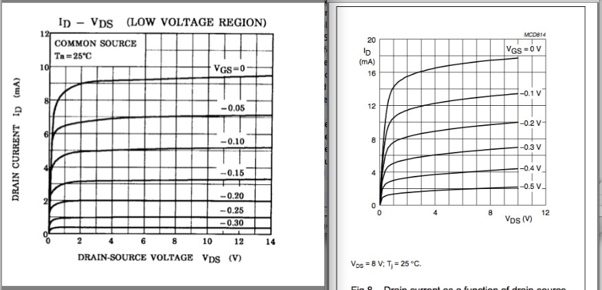

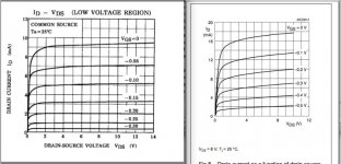

The BF862 part you can get trhough Farnell...at app half a euro a piece....
i can't from the data sheet see any differences to 2sk369....noise and gain and Idss seems to be very similar...but SMD only (OK for me)
I do not know if the plan is still to use this circuit also as MM. If so, the BF862 has the advantage of much less input capacitance Ciss of 10pF against 75pf of the 2SK369. The 2SK369 has a higher early voltage though. Your circuit does not suffer much from speed problems so this difference in early voltage should not play a big role i think.
Real life JFETs
Did you try to mismatch the input JFETs so that the circuit will use more realistic Idss/Vp/etc variations as they will in real life?
That can/will affect THD and DC offset.
Always good to do before prototyping.

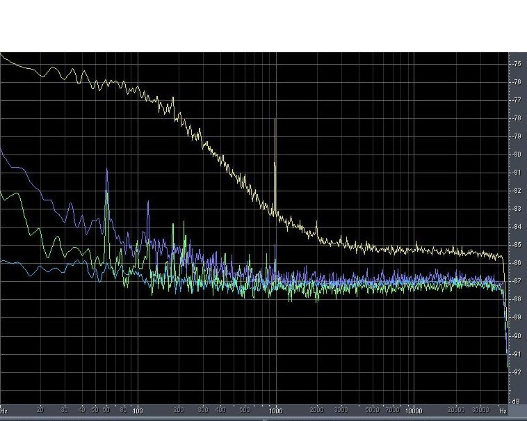

And how about the noise at low frequencies?
Anay data?
They are both better then the 2SK170 that is quite noisy in the lower reaches because of GR noise. Ask Scott, he measured them.
Any measurements except hear-saying?
Noise at 10, 100, 1000Hz?
