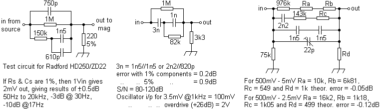

There is a different structure of RIAA EQ that can use 4pcs identical value capacitors, may be worth looking at...
(Image Courtesy of Paul Kembles RIAA Page)
I am (obviously) talking about the middle one. Suitably scaled (4.7nF Cap's maybe) it should do the trick.
