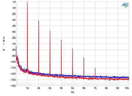

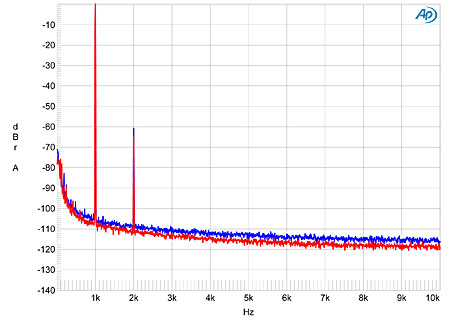

Joachim,
I personally tend to aim my circuitry (excluding power amp's) for < 0.3% THD in production (with variations due to tubes etc. accounted for) at around 2V out.
The "continously decreasing harmonics" you mention can be seen very well in JA's measurement of my recent Phono:
Abbingdon Music Research PH-77 Phono Equaliser Measurements | Stereophile.com
With a totally inappropriate 600 Ohm Load (which will also take all the bass out - 120Hz -3dB) and 1V out you get 3% THD, but it looks "textbook open-loop class A":
With a more reasonable load (1V/100K) it looks like this:
It does not look much different with 10K either.
The bottom line is, well below 0.3% 2nd HD I prefer to worry about the distortion in speakers, microphones (never mind LP's themselves) rather than that of the of the electronics.
I leave pursuing 0.0001% THD to others, I already made stuff like that many times and the low distortion did not make it sound better as such (which may be related to the > 30% 2nd HD in the human ear at around 90dB SPL).
