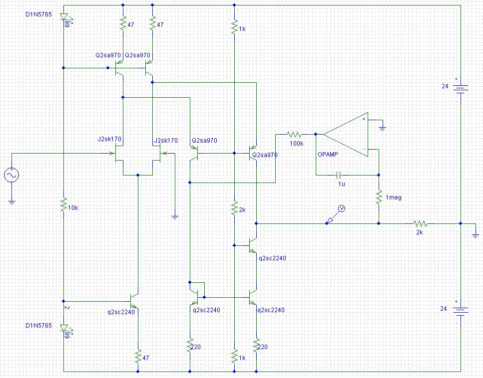

MiiB, Bob Cordell is coming around to the same idea of an N channel jfet design, with perhaps differential input as an optional extra, which is what I tried to promote a short while ago and may be an optimal way to make a 'buildable' input stage for most people here, with high quality, flexibility, yet low complexity. We did get sidetracked with Vendetta type complementary designs, etc, that are getting harder and more expensive to get parts for, that require matching of the complements, at the the very least, and servoing. Perhaps we can once again, get back on track.

Balanced makes sense to me when when it is balanced all the way, also the RIAA. Linear Audio Volume 0 has a circuit i made, the FPS, that is balanced all the way from input to output. S/N is -77dB over a 20kHz bandwidth with 4 x 2SK170 and 4 x 2SJ74.
Bappe's suggestion in #399, on page 40, on April 21, is really a good place to start. It can be both: balanced and unbalanced (in some situations). Open loop or closed loop.
Far more versatility than a simple IC. I again, recommend it.

Looking at the circuit #399....I came to think that i would be possible to add a little feedback...and maybe even let the upper pole and third constant be part of the circuit..
personally I would omit the servo..because a Riaa really need the low cut to take the warp out...
Global loop feedback is not optimum for an input stage.
Mistracking can put out high level 5us duration pulses that are going to complicate the job of any feedback loop.

Then the circuit could be followed by a passive...50-500Hz shelf...and an active 318 us feedback around a second stage, that could be quite similar to this one...
This is one possible direction. There are others.
Usually, adding the 75us RC rolloff above 2KHz, just after the first stage, takes the mistracking 'pulse' down to a risetime limited square wave, the very thing that most of you think about as being a typical source. This is most important, in order to make it relatively easy for the global negative feedback to not do anything adverse to audio quality.
I made a simulation some time ago. When the emitter resistors are over 100 Ohm i lost around 1dB of S/N. 47 Ohm is a bit low. I have seen emitter resistors as high as 800 Ohm in another phonostage but i think that is a bit excessive. Maybe something around 220 Ohm is ok.
