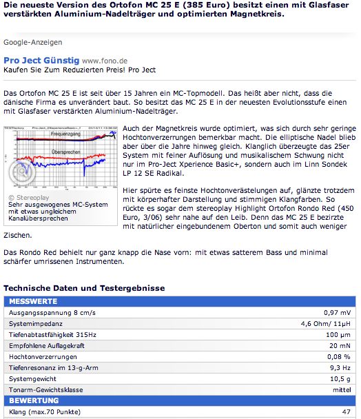

I know they did not treat you right but here is some information on the new version of the Ortofon MC25E. This is a rework of a 25 year old design. It has quite low impedance and inductance and a decent output voltage. In Germany it costs somewhat less then 400,-€ so it is semi affordable too.
I'll stick with my Lyra. It is priced right, and good sounding too! I gave away a $1000 Ortofon to my business partner a few years ago. Gave a Denon to Jack Bybee. etc.
Sure, you can not compare a Lyra to an Ortofon. I am happy that your system sounds so good at the moment.
