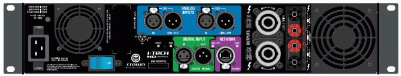

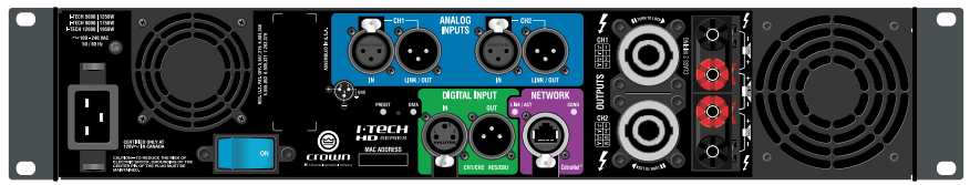

Check the purple area connector on the back of this Crown touring grade amp.
