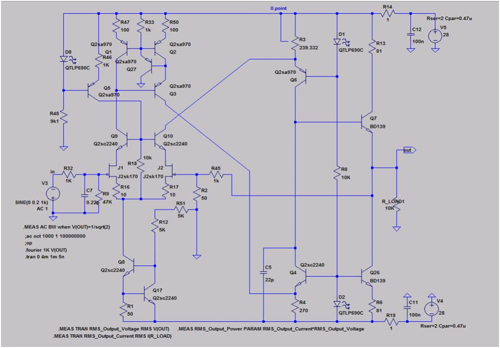

Martin, the circuit we simulated has as the "second" stage double folded cascodes supplied by
contant current sources. This gives a current output that drives an All In One Go transimpedance RIAA and then comes a buffer. We did not try to unbalance the drain loads. In the simple case of drain resistors you could be right with both aproaches but we did not try that. I know that you are a capable simulator so you could try yourself what happens. It could affect output impedance and clipping but i am not sure about that. in the circuit we tested it was mainly the total Gm that counted. We did not try to grossly unbalance though.

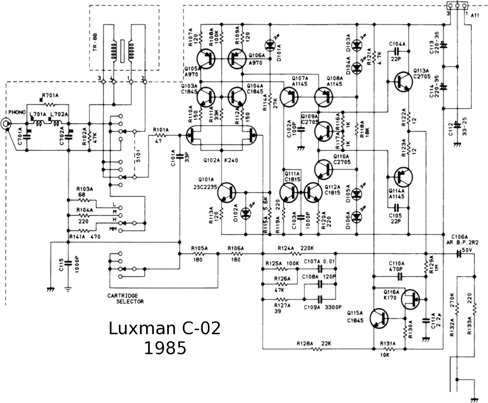

TVI, this is a great schematic. Now, how could we both simplify it, AND make it even more suitable for a low noise phono stage? Hint: We might even run it open loop.

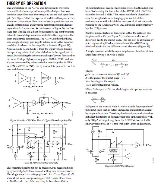

The current mirrors can be bootstrapped, so can the output buffer. Then it is a kind of Fet version of the AD797. My output stage is different though. I am not a big fan of Diamond buffers although i tried hard to make them sound my way.
Joachim, you are completely deviating from what I am trying to say. I DON'T want a discrete AD797, the IC already exists. I want a good TRANS-AMP, with limited gain, high open loop bandwidth, and CLASS A. Quality jfet input is optimum for discrete.
Joachim, you are getting closer. What I want to talk about is an IDEAL first gain block of a 2 gain block phono stage, that can have IDEAL characteristics. I, personally know how to make comp-diff jfet input stages, I do it every day. Here, I am TRYING to just use a single pair of parts for the input, with a FOLDED CASCODE AND a CURRENT MIRROR to create a push-pull drive.

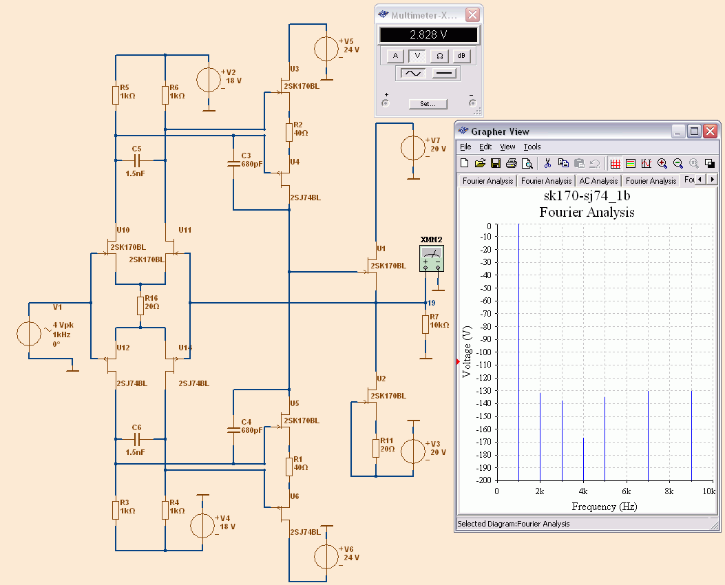

Something like this....??? old idea i have been working with.. assembling the signal in the second stage seems to cancel all distortion....even with very little feedback applied...
Joachim, your last input was very close to a Vendetta Research SCP-1 input. Very well done, but perhaps too sophisticated for consideration here.
I was hoping to simplify a single differential N channel jfet, folded cascoded design that could be made to become an OPEN LOOP gain block for a phono stage. Of course, IF I were making it for myself, then I would use the complementary approach, but many, including Parasound, one of my clients, has found getting p channel low noise fets almost impossible to obtain, yet we can still buy 1000's of n channel fets with the same general specification.
