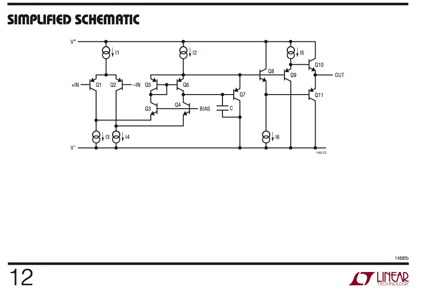

Darlington inputs, if you made this circuit have non-darlington inputs and 1nV the current noise would go through the roof especially on their original process.
Just for the record R. C. Hughes (US 3473134) of the US Navy invented the folded cascode and assigned it to Uncle Sam in 1966 (granted 1969).
As the folded cascode was published in other articles in 1969 or so, I doubt that the patent is actionable, at least. However, the use of a folded cascode single differential gain stage appears to be first in this specific op amp in 1971. Any earlier cites?

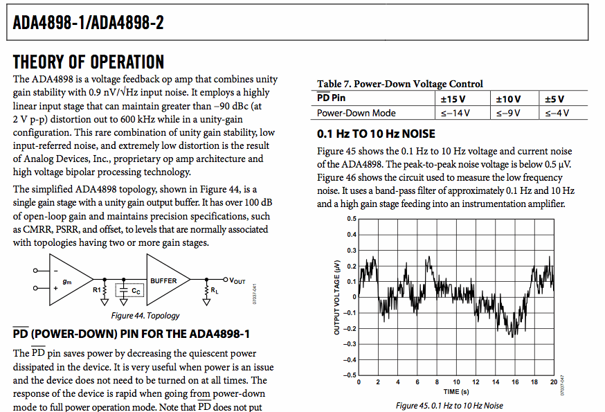

Joachim, what is the schematic? Of course, we can find quiet enough op amps. However, they have other tradeoffs, at least tradeoffs from MY perspective.

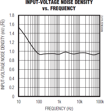

"The MAX9632 is a low-noise, precision, wide-band operational amplifier that can operate in a very wide +4.5V to +36V supply voltage range. The IC operates in dual (±18V) or single-supply mode (36V)."
No simplified Schematic in the data sheet 🙁

CMRR @DC (dB) 135
PSRR @DC (dB) 140
Input IBIAS (nA) 180
Unity Gain BW (MHz) 55
Slew Rate (V/µs) 30
in (pA/√Hz) 3.75
MAX9632.pdf
PSRR @DC (dB) 140
Slew Rate (V/µs) 30
in (pA/√Hz) 3.75
MAX9632.pdf
I see those parameters, but I don't know enough yet, except that it is a workable op amp for many applications. How about output Xover distortion? Open loop bandwidth, can we get more? etc.
