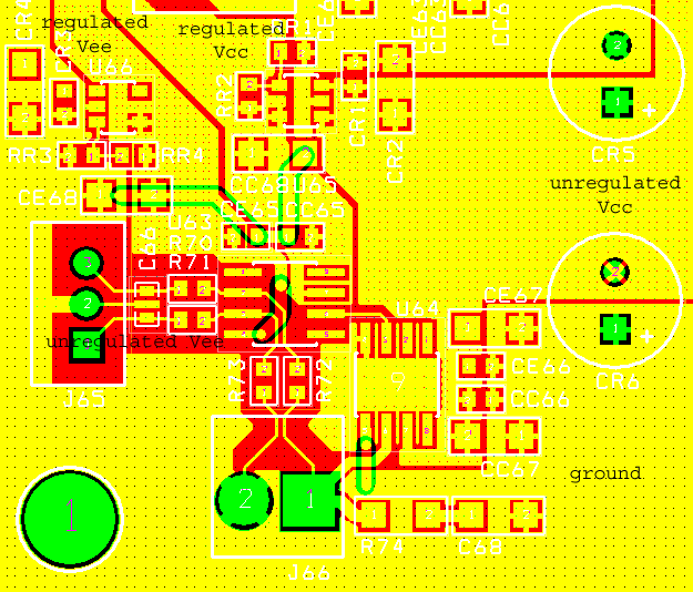

In terms of layout, there are two main design pivots; single supply versus dual supply and single ended feedback versus differential feedback. The way I tend to think about it is that FR4 comes with copper on both sides for a reason---if you're not using most of that copper then your layout's probably not what it could be.
With single supply you can usually do a pretty good job of the pours in two layers without too much fuss if you've got your floorplanning decent. With dual supply more creativity's required and I've usually had to work the design quite a bit to get good two layer pours. Either way, the planes get disrupted by signal paths so the supply net lengths are longer in terms of squares than if the planes were poured through in a four layer board. You never get an ideal pour in four layers due to via disruption so, in my experience, the net penalty for two layers is usually somewhere around 10 squares. That's actually not bad; one ounce copper is 0.26 mOhm per square and pours wider than 300 mil (on typical 62 mil FR4) tend to come in around 1nH per square. That's order of magnitude lower impedance than typical audio routing using traces, often well on the way towards two orders of magnitude.
Single ended versus differential feedback is more a matter of perception than anything else. A good differential feedback layout puts the feedback resistors and filter caps close to the control circuit (typically an op amp in line level implementations or discrete in a power amps, though there's really no reason not to use op amps to control solid state power amps too). This minimizes the extent of high impedance (and therefore noise susceptible) trace and hence the amount of noise pickup on the op amp's summing junctions. Of the other four terminals in the feedback network, two are the balanced input and two are the Kelvin sense traces tapping in to the amp's output connector. One's then free to pour planes up to, around, and even underneath the feedback traces---edge to edge coupling's relatively weak and the differential topology's common mode rejection mitigates broadside coupling (at least if the plane's poured consistently through underneath). A good single ended feedback layout looks much the same, just without the resistors on the ground connections. From a topology standpoint there's no difference between this and star ground; it's just a layout adjustment which makes better use of the copper available on the board.
The attached is a two layer example from a board I'm working on a the moment. It's a differential input, single ended output, 500mW composite amplifier channel. U63's the controlling op amp, J65 is the input connector, U65 is the output device, and J66 is the power connector. The regulated pours here aren't ideal. For the lowest inductance they should be underlain with ground on the bottom side rather than the unregulated Vee pour. Or perhaps regulated Vcc and Vee should paired. However, the board's rather small and hence the backside area's wanted for cooling of the 8-PSOP output devices. I'm not entirely settled on the geometry tradeoffs for the regulated planes, which is the main reason the board's not done yet, but my experience is this is mostly splitting hairs---the controlling op amp runs in class A so the regulated supply impedance isn't so critical.
Same one as I talk about over here; in the attached example it'd be U63 and its feedback network. To summarize stuff I've posted on elsewhere in DIYA, THD is a subset of IMD and IMD is be well correlated with percieved audio quality via the Rnonlin metric. To leave tube amps aside for the moment, this means one can use THD as a predictor of audio quality (provided other conditions are met, such as slew rates being high enough to keep the feedback loop closed). Power devices typcially have about 70dB PSRR and an open loop THD around -45dB (that varies with load; the lower the load impdedance, the worse the linearity). If you go back the ripple to signal ratio graph in that post I just linked there's that brutal range at the low power end of the graph where the ripple amplitude is 40dB or more above that of the output signal. The open loop output error will therefore be dominated by ripple leaking through the PSRR, creating some sort of THD/IMD/noise floor at -30dB.Which "control loop"?
A reasonable rule of thumb is artifacts 50dB below signal are audible to critical listeners, with the threshold of inaudibility being somewhere around -60dB (Ethan Weiner arrived at this first but I came to it independently). Since distortion from good drivers is about -60dB it can be desirable to hold the electronics' nonlinearity well below that in order to keep playback fidelity limited on the drivers. This suggests the electrical THD/IMD/noise floor should be around -70dB, perhaps -80dB to have some margin for the unexpected (or for Ethan and I perhaps having bad ears 😉). Using a regulator with 50+dB ripple rejection on the output devices' supply will get the ripple out of the way, but one's still stuck with the -45dB floor from the nonlinearity.
This means you need a control loop to linearize the output. Since the ripple is 40dB above signal and we want to linearize to at least 70dB below signal, the control loop requires a PSRR of 40 + 70 = 110dB. Minimum. 120dB+ is preferable. It's extraordinarily difficult to hit this in discrete. Good op amps will do it at low frequencies but not at 20kHz. So either you need an insane power supply with something like a Farad of low ESR and low ESL caps or you regulate the control loop supplies. The latter approach is much cheaper, easier to build, and decent choice of regulators will give you 50dB ripple rejection at 20kHz. Combine that with an op amp's PSRR and you get 140+dB, enough to push the THD/IMD/noise floor down to -110dB. If you want to. Most control loops don't have sufficient excess gain to do so, but that's a separate discussion.
Mainly works with rectangular caps that are long side adjacent over planes. The required geometry's obvious if you can visualize the electromagnetic fields in whole structure but I don't have good link handy to help with that. Perhaps jcx's link has the goods---haven't looked.It might also only or mostly apply to MLCCs, with the layers aligned correctly.
