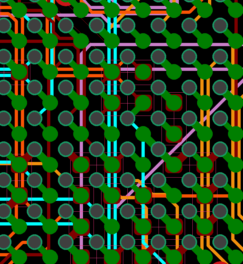

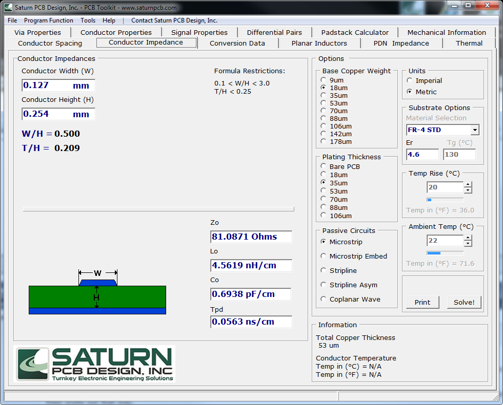

Most if not all published figures for PCB inductance are based on a ground plane being present, as the return path is critical in calculating inductance.
I'm currently on pages 436 onward of Mr Otts book as we are looking into planar capacitance and whether we use to many power islands as shown in figure 11.22...or whether a uninterupted plane pair with planar capacitance would be better.
http://www.interferencetechnology.com/uploads/media/ITEM_01.pdf
PCB inductance:
http://www.polarinstruments.com/support/cits/IPC1999.pdf
Yes but inductance is probably the most important, especialy as speed goes up, and inductance has to ttake account of the return path, trace resistance is a minor consideration for decoupling providing there is adequate copper for currents required.
the effective inductance of the circuit, as seen by the load, must take account of both the flow path and the return path. Neither is more or less important than the other.
I am aware (very) aware of the impotance of the return path, but to calculate the inductance of a trace without a ground plane is more complex, inductance is of the loop, and with decoupling of digital signals or for RF decoupling the inductance loop is of paramount importance, you cannot calculate a PCb trace inductance without taking into account the return path, and if you dont have a ground plane the calculations are harder and the trace inductance will be higher. So for star grounded layouts as you often do on the amplifiers you realy need to use a 3D field solver such as those from polar intruments or simple calcs can be done using one or two of the options in the calculator before. The figure Gootee quoted is for a microstrip trace.
Inductance Calculator
http://www.speedingedge.com/PDF-Files/BTS006_What_Is_Inductance (2).pdf
Just out of interest I am also collating inductance figures for small (0603-0402) chip capacitors and there routing, as with moving to HDI (high density interconnect) we can halve the inductance for a placed and routed 0402 capacitor.

Looked at the XY2 caps as well as other low inductance designs, such as multiple caps in BGA packages.
Limited with numer of vias that we can get on the capacitors, these are boards covered in BGA's with DDR2 ram (not DIMM modules), double sided placement, IPC class 3, 3500 plus component pins in a board 100mm x85mm 12-16 layers (sig next to contigous ground plane, dont allow vias to create slots either)! Next step is HDI:
Microvia HDI
I am currently changing one of the design to HDi, the via in pad with the 1005 (0402) resistors halves the inductance. plus going to use planar capacitance with closely spaced power pairs.

The Saturn impedance toolkit, all options have a ground plane present...
As for hand soldering or even looking at boards, I am at the age where 25+ years in front of a monitor means that its all just one big blur, without some serious magnification, thank goodness for the Zoom function in CAD, and when you get to 0201 capacitors, its like a bag of fairy dust.
The PCB area shown is approx 7mm x 8mm in the real world.
