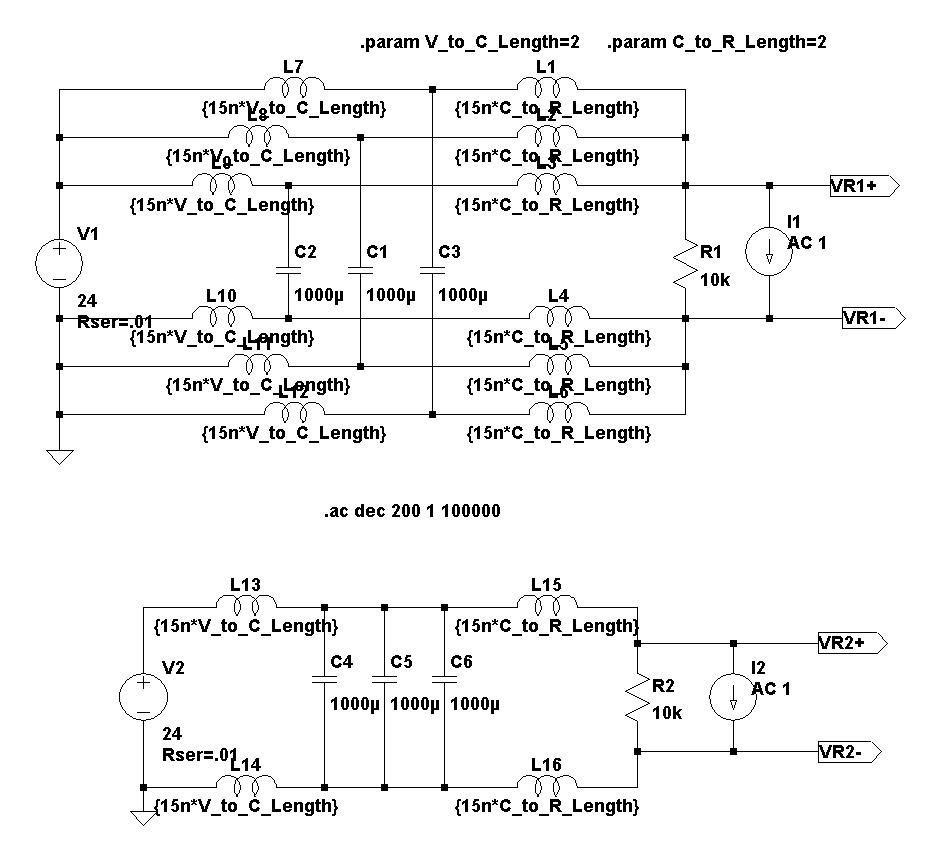

Paralleling Capacitors AND Their PCB Traces
I was thinking about the application of the parallel capacitance idea to the smoothing capacitors in an unregulated linear power supply. And I wondered how much benefit there might be to keeping the traces separate, all the way to the point of load, to that their inductances (and ESRs) would tend to reduce by being in parallel (the way that the total resistance reduces when resistors are in parallel).

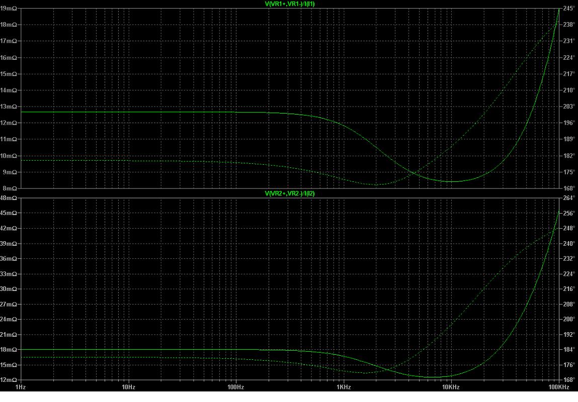

I simulated the two circuits shown, and plotted the impedances as seen from the loads.
The "shared traces" version (second/bottom circuit) has about 50% higher impedance, at lower frequencies, and gets much worse at higher frequencies.
By 10 MHz, the "shared traces" version is up to almost 4 Ohms while the paralleled version is only up to about 1.4 Ohms.
The inductors are each simulating two inches of some conductor with 15 nH per inch and 0.001 Ohm per inch. Each capacitor has an ESR of 0.05 Ohm and an ESL of 5 nH.
fits what you would expect, the higher the frequency the more the impedanz will be dictated by L
Yes.
And at the load, a current source going from 0 to 3 amps in 1 µs causes a 186 mV spike, with the shared-trace version, and only a 65 mV spike in the one with paralleled traces.
V = L(di/dt) and di/dt was the same in both cases. So the effective inductance really was lowered by almost ⅔, as expected.

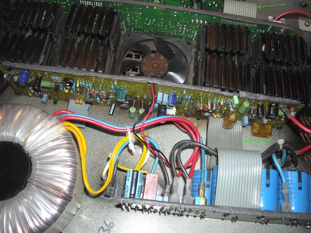

here is a foto. it shows a small pa - amp, the psu board (+v 0 -v) is connected with a "ribbon cable" to the poweramp boards (the +-15v are made with res and z-diodes on the preamp board).
