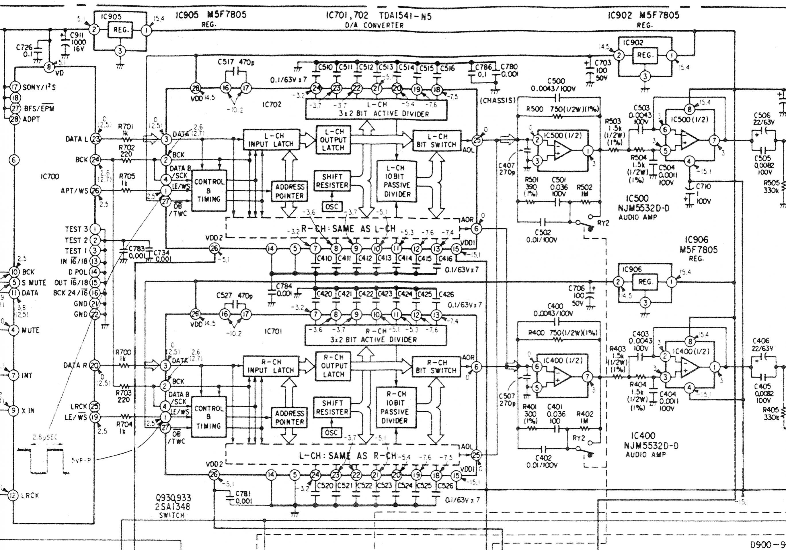

This is hpw Sony paralleled two TDA1541 in a Sony CDP-337.
On the left the digital Filter, on the right the output stages.
IC700: CXD1144P
IC400&500: NJM5532D
Curious, what the TDA1541-N5 means...
IC700: CXD1144P
IC400&500: NJM5532D
As an owner of a 337 I'm very curious about this too! I wonder if it is some sort of selection criteria?

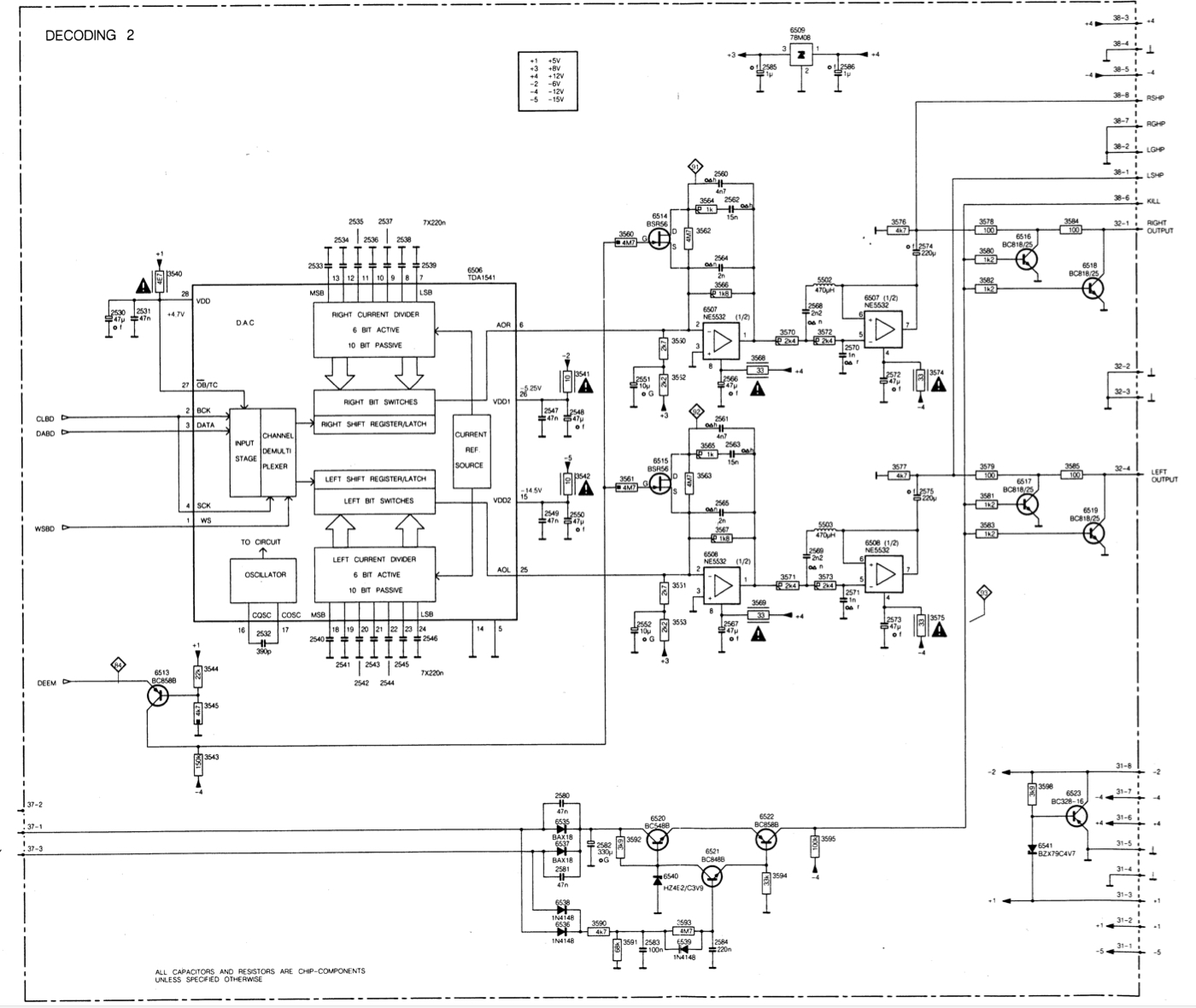

I would like to parallel two TDA1541 in a Philips CD304MKII.
But an 8V voltage is fed to the current output of the TDA1541,
see resistors in the attached drawing
3550 3552 and cap 2551 for the right channel
and resistors 3551 3553 and cap 2552 for the left channel.
+3 is misleading, for some strange reason Philips used symbol numbers
for voltages +3 in fact means +8V, a key table explaining the numbers is in the upper center of the schematics.
Very annoying when reading schematics...
Do I have to change the values of this voltage-injection when two TDA´s are parallelled?
Some thoughts why a voltage is injected into the Dacs current are here:
TDA1541-why is a Voltage fed into the Current Output?
Could have to do something with the fact that the TDA only puts out positive currents, but this voltage injection is not in every design.
Could this injection be part of the combination of SAA7220P/A together with TDA1541 non"A"?
The SAA1720P/A used in the CD304MKII player (with TDA1541 non A) produces a
"5% offset" whereas a SAA7220B/P priduced 0.05% offset, see this link:
Type Differences Philips SAA7220P/A, /B & /C
But I frankly do not understand what offset is meant and if there is a connection to the mentioned voltage injection...
I found schematics of this first generation SAA7220/TDA1541-non-A combination where no voltage/offset is inducted.
But those all use LM833 as Opamps and not the NE5534, where the injection can also be found.
On the other hand, the ones I found

...ah, time for editing ran out!
...on the other hand, the paralleled TDA1541A in the Sony CDP-337 mentioned above uses the NE5532 as well. No injected voltage, but the digital filter is from Sony.
I assume the voltage injection in the Phillips CD-304MKII and CD960 is related to the combination of Filter (SAA7220, first version) TDA1541 (non A, first version) and Opamp NE5532?
