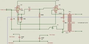

If I can suggest the next step is to find a pair of 470pF capacitors...
To be clear - one 470pF cap for each 1541A chip - and link pins 16 on each chip together - with no other connections to anywhere.. matched caps at 470pF will be best. This will have fDEM at 176kHz which is 4x the 44.1kHz sampling rate which is what you want.
Again - if it works it works, if it doesnt the problem is NOT with the DEM cct.
Once you get the parallel combination working, you have a benchmark and from there you can try other more elaborate DEM schemes knowing that any problem is resultant on the most recent change = very important.

I didn't have another 470pf for the other dac, but now have used two pairs of Nichicon 1n in series and pins 16 linked.
Success - no noise or other nasties when paralleled just that smooth 1541 sound free from grain and glare.

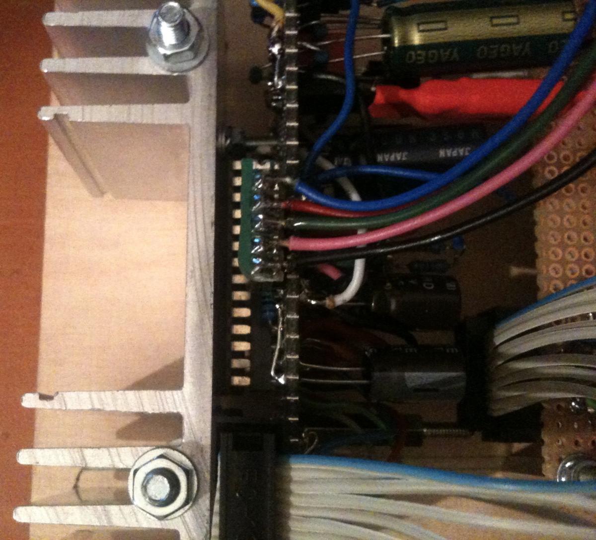

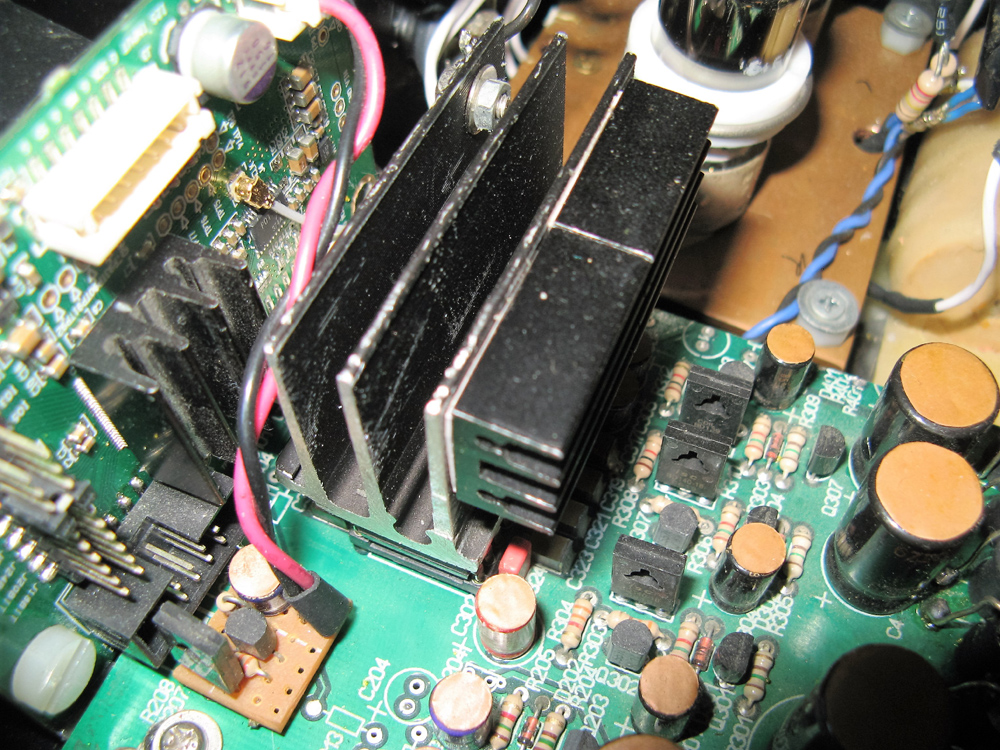

One important thing is to mount big heatsink on TDA1541A. Try and listen. Temperature matters, measure and compare T with and without heatsink.
Finally somebody suggested it! I use 2 heatsinks like on the picture, it is a must!One important thing is to mount big heatsink on TDA1541A. Try and listen. Temperature matters, measure and compare T with and without heatsink.
Yes I'll be doing this when my new dac kit is delivered.

If You have a new and unused TDA1541A it is a must to have as big heatsink as it could be.
More crowns on marking doubles need - joke. That is not only for better sound outcome, but for durabiliy and more years to join with this beautiful dac chip. 🙂

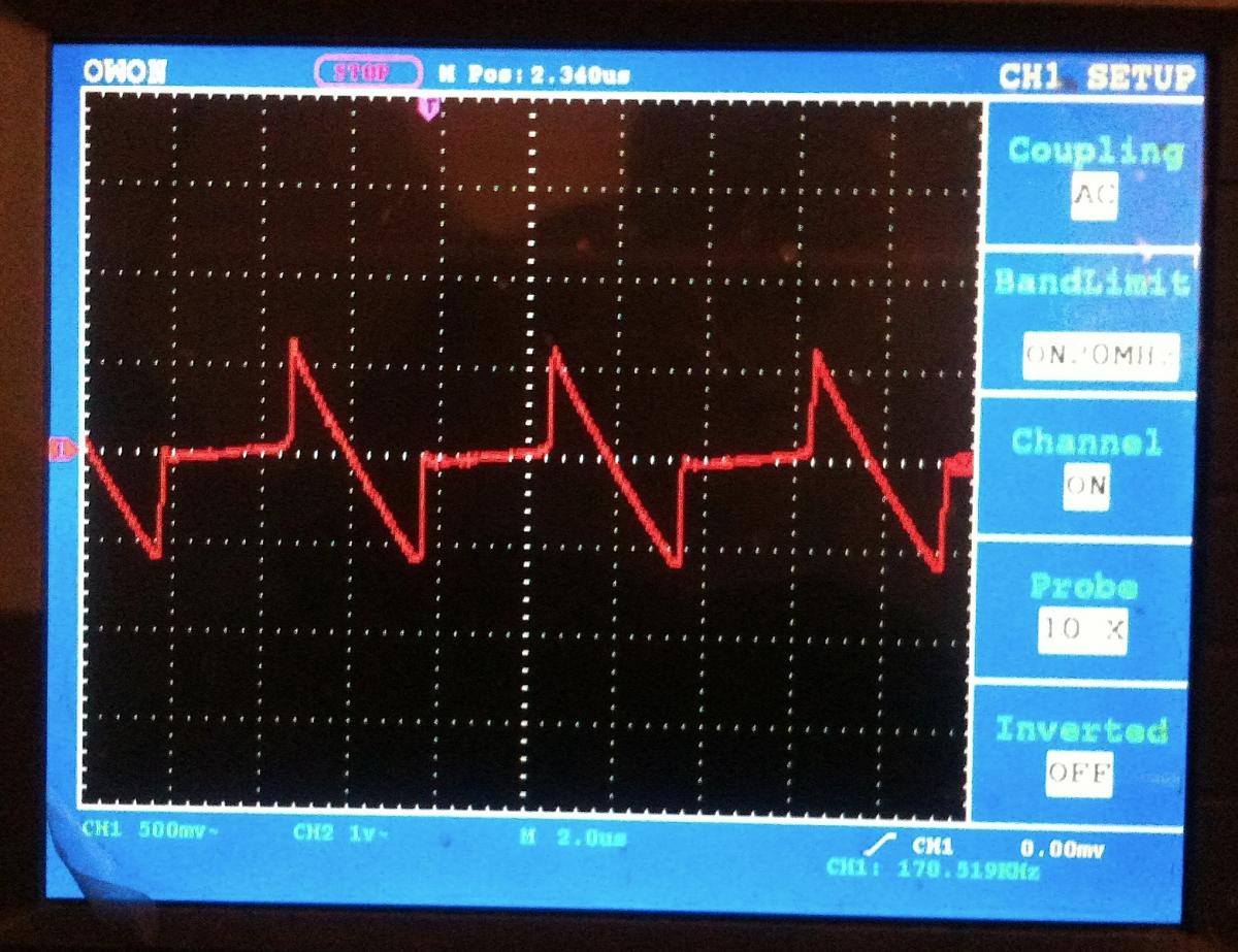

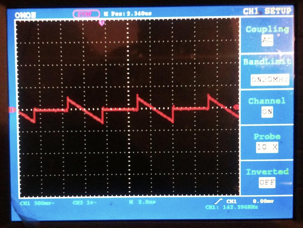

Here is some pics BUT with TDA1540 chip. I think that some of that could be valid way for the TDA1541A too?
for instance i measured about 140KHz at the DEM pins with original value of Cdem.
But with free running DEM and each pin connected via R=20K to -18V power pin (measured 200uA cca. each R)
dem F reaches 170KHz...

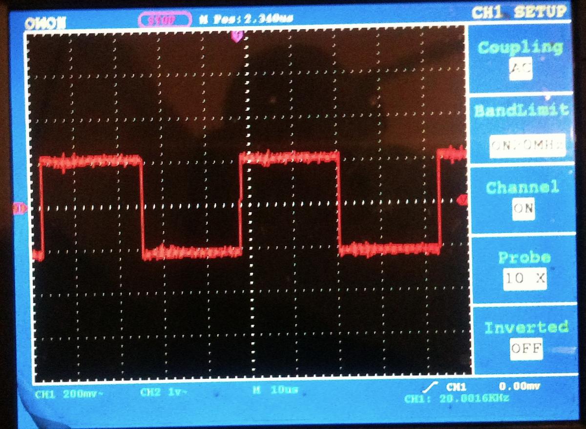

Also I mount each channel chip on grounded heatsink. 🙂
look at the 20KHz square at the output
