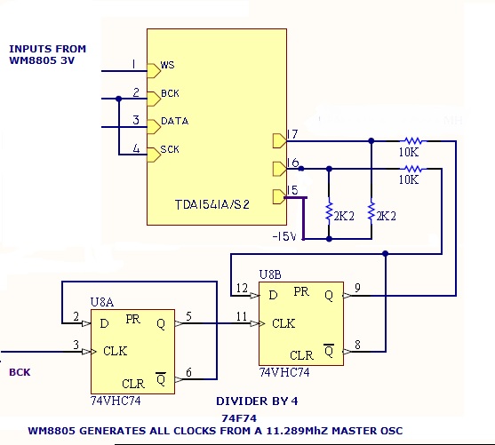

Here is some pics BUT with TDA1540 chip. I think that some of that could be valid way for the TDA1541A too?
for instance i measured about 140KHz at the DEM pins with original value of Cdem.
But with free running DEM and each pin connected via R=20K to -18V power pin (measured 200uA cca. each R)
dem F reaches 170KHz...
Also I mount each channel chip on grounded heatsink. 🙂
look at the 20KHz square at the output :trapper:

I tested same aproach on bit different chip like i said it was tda1540, with generator from computer and then measured...
Not sure about tda1540, I dont know much about it.. the linked post illustrates the difference between analog and digital oscilloscopes and the way some of them display the info. After the resistors to -15V the digital screen shot looks quite a bit worse than it does for the original circuit and the analog scope shows it quite a bit differently.
LH/S
Yes, but i gave the informations I measured with equpment I had 🙂 and I clearly stated that is for the 1540 not for the 1541A.
In fact it is nothing new I found similar circuit in one PHI book. Also similar circuit for dem was used in some Grundig CDplayer. cant remember now wich one... I try to dig it and post

I will divide bck to get a 175Khz dem clock.

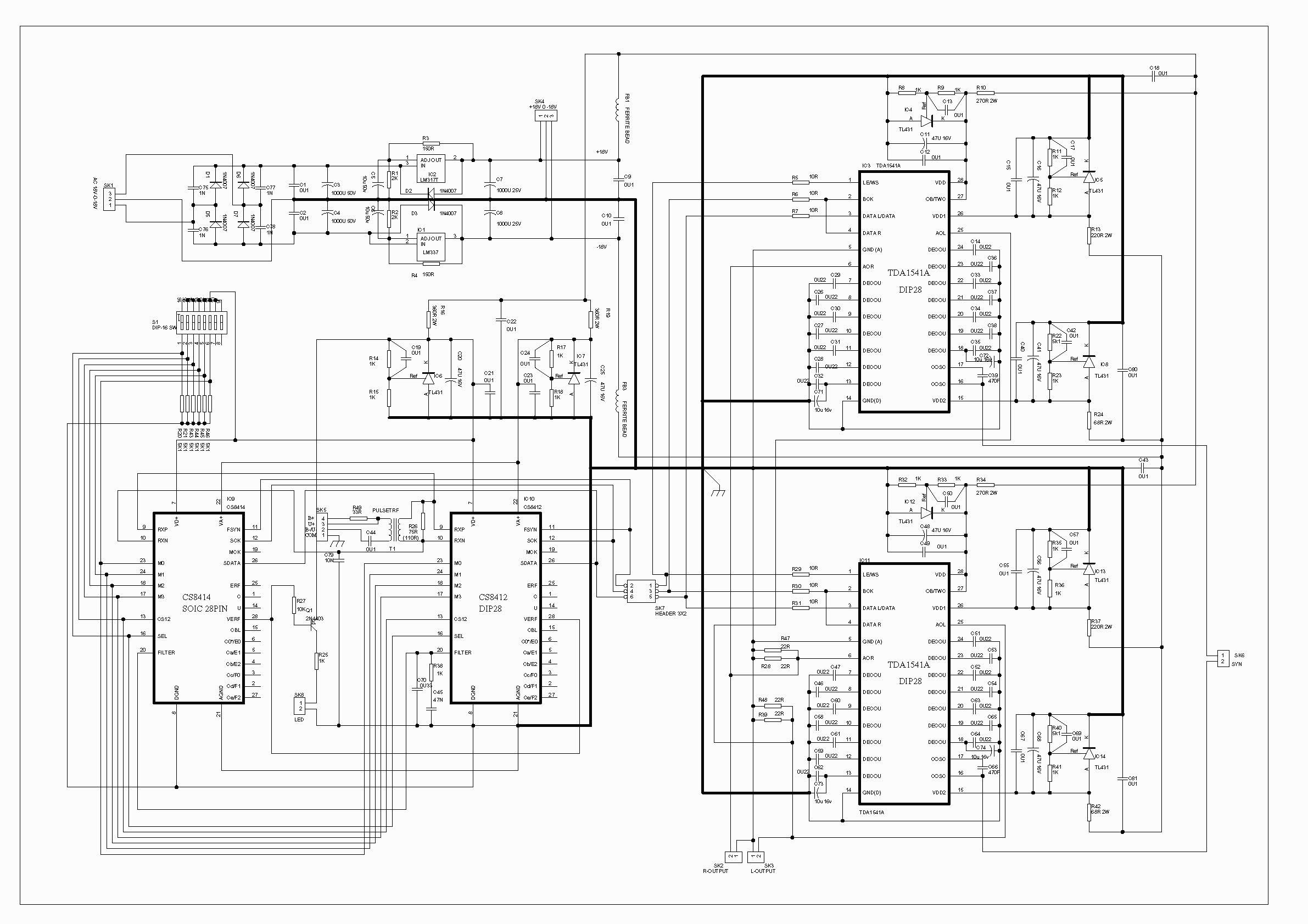

This is hpw Sony paralleled two TDA1541 in a Sony CDP-337.
On the left the digital Filter, on the right the output stages.
IC700: CXD1144P
IC400&500: NJM5532D

I would like to parallel two TDA1541 in a Philips CD304MKII.
But an 8V voltage is fed to the current output of the TDA1541,
see resistors in the attached drawing
3550 3552 and cap 2551 for the right channel
and resistors 3551 3553 and cap 2552 for the left channel.
+3 is misleading, for some strange reason Philips used symbol numbers
for voltages +3 in fact means +8V, a key table explaining the numbers is in the upper center of the schematics.
Very annoying when reading schematics...
Do I have to change the values of this voltage-injection when two TDA´s are parallelled?

Some thoughts why a voltage is injected into the Dacs current are here:
TDA1541-why is a Voltage fed into the Current Output?
Could have to do something with the fact that the TDA only puts out positive currents, but this voltage injection is not in every design.
Could this injection be part of the combination of SAA7220P/A together with TDA1541 non"A"?
The SAA1720P/A used in the CD304MKII player (with TDA1541 non A) produces a
"5% offset" whereas a SAA7220B/P priduced 0.05% offset, see this link:
Type Differences Philips SAA7220P/A, /B & /C
But I frankly do not understand what offset is meant and if there is a connection to the mentioned voltage injection...
I found schematics of this first generation SAA7220/TDA1541-non-A combination where no voltage/offset is inducted.
But those all use LM833 as Opamps and not the NE5534, where the injection can also be found.

...on the other hand, the paralleled TDA1541A in the Sony CDP-337 mentioned above uses the NE5532 as well. No injected voltage, but the digital filter is from Sony.
627689d1501161657-parallel-tda1541a-dac-noise-parallel_tda1541_sony_cdp-337-jpg
I assume the voltage injection in the Phillips CD-304MKII and CD960 is related to the combination of Filter (SAA7220, first version) TDA1541 (non A, first version) and Opamp NE5532?
