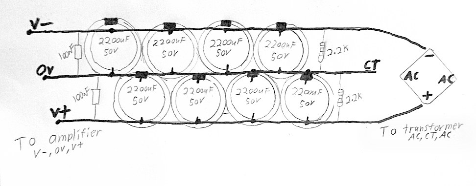

Transformer and rectifier is one easy section:
Check Mark Houston's Synergy Gainclone.
Check the datasheet for KBPC2504 or KBPC1604
Check Decibel Dungeon transformer explanation

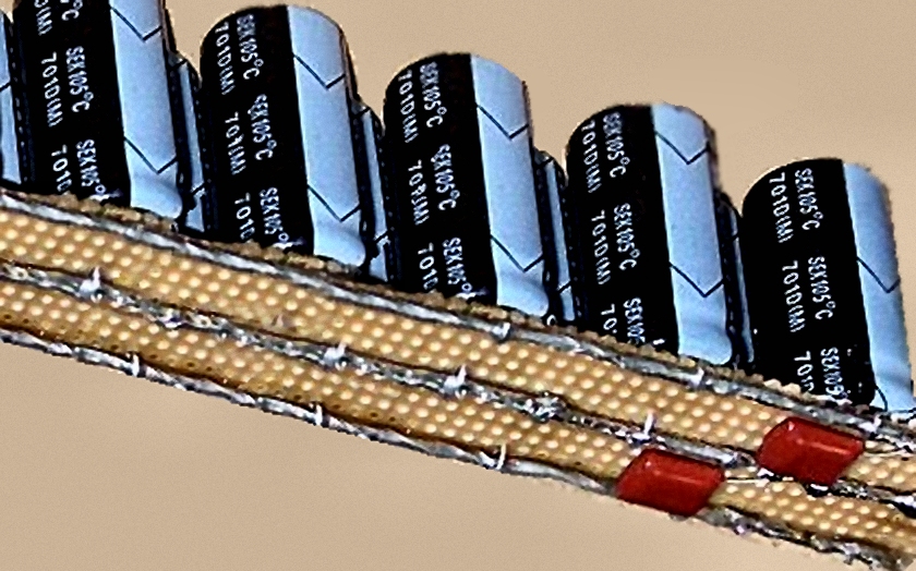

Example power smoothing board another easy section:
12 caps (2 100nF polyester dip caps, 10 pack of 35v 2,200uF ecaps) on copperless phenolic perfboard (no pads, just non-conductive board with holes), and it has this arrangement.
v+, 100nF, 2,200uF, 2,200uF, 2,200uF, 2,200uF, 2,200uF, rectifier +
0v---------------------------------------------------------- CT
v-, 100nF, 2,200uF, 2,200uF, 2,200uF, 2,200uF, 2,200uF, rectifier -
The rectifiers that we are using have clearly marked polarity--KBPC1004 on Mark Houston's example is even better in that respect. The power smoothing section is easier and faster to assemble on a board. I cannot give you a great deal of advice on power supplies, but I can provide photos. Please look up the relevant materials on the Decibel Dungeon website and also Rod Elliot's website.

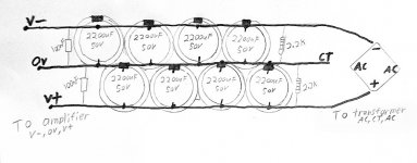

Here are some power supply photos:
That amplifier is not one of my designs. It is the datasheet example in LM1875.pdf by National Semiconductor. <--links The chipamp.com LM1875 is a highly usable kit that many people like. Most often they use the board and then simply transplant a favorite design onto the board. There's a couple of threads here on diyaudio.com about enhancements and upgrades for that kit.
