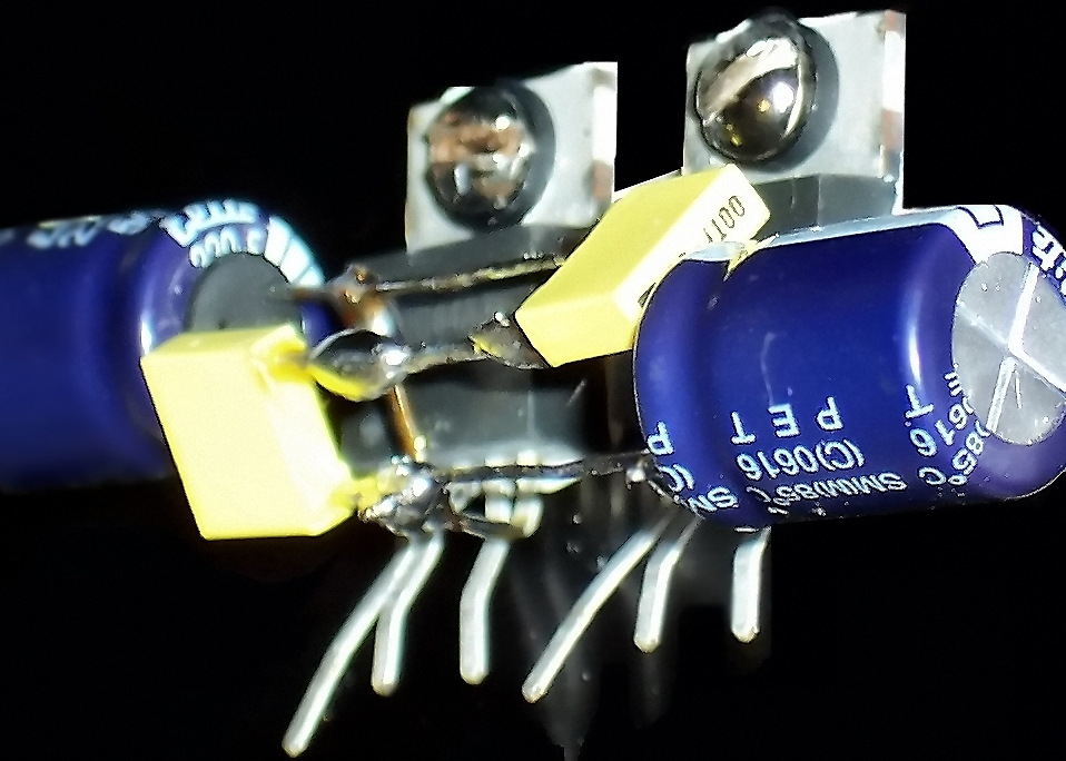

LM1875 Parallel with. . . Cake Flattening Power!!! and a weird center amp
Looking a lot like a Cmoy with a wiring problem, I'm trying to work out a center channel preamp with a lot better performance than a retail product would have.
So far, a quad op-amp as a buffer
Half of it as a normal non inverting stereo buffer. #1, right, #2 left
Anti-mixer via CapDiv from the outputs of #1 and #2.
Half of it as inverting buffers, #3 left tilt and #4 right tilt
The outputs of #3 and #4 fused by resistor mixer input to inverted power amp.
Out of the stereo buffer like this.
#1 right 22nF to #3
#2 left 47nF to #3
both of the above into inverting op amp #3, left tilt
AND Out of the stereo buffer like this too
#1 right 47nF to #4
#2 left 22nF to #4
both of the above into inverting op amp #4, right tilt
And then pair of 1k resistors out of the op amps #3 and #4 as resistor mixer for unified center channel Power amp input. The power amp in this case seems to be a Decibel Dungeon inverting gainclone or other inverting amplifier. Little green polyester dip caps are used for the capdiv section, and in such a thing, the pin of a small cap touches the pin of a large cap directly at the stage output, as indicated above.

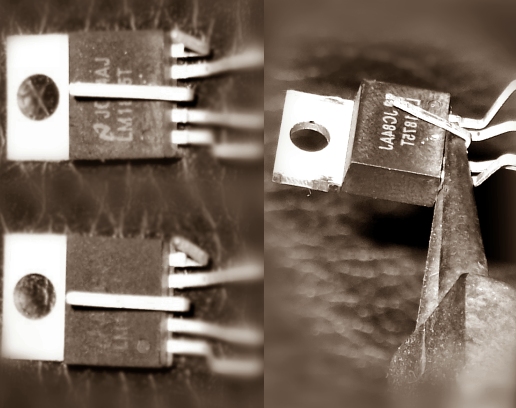

Transmitter heatsink
With my LM1875's there were some conductivity problems with a transmitter heatsink. It seemed that the hole in the middle of the shoulder washer was too large and the precision of my drilling was lacking slightly. This combination was a point of failure.
This was solved by taking a drill bit same external dimensions as a shoulder washer and chamfering the existing hole on the back side of the LM1875 to make a divot (like extremely shallow miniature crater). Next I slightly lapped the back of the LM1875 by sanding it with #600 sandpaper to gain smoother edges. Finally, I filled the chamfered spot with Arctic Ceramique. The back of LM1875 cannot now make contact with minor drilling errors.
This fix was just barely sufficient.
Although the transmitter heatsink (thick black non-conductive coating) is the highest performance option, it is also the most difficult and thus least safe. Hopefully this chamfer trick will help keep somebody safer. Again, please verify total non-conductivity with ohmmeter.
