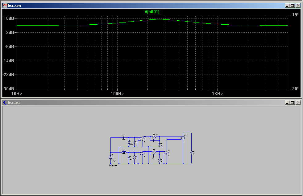

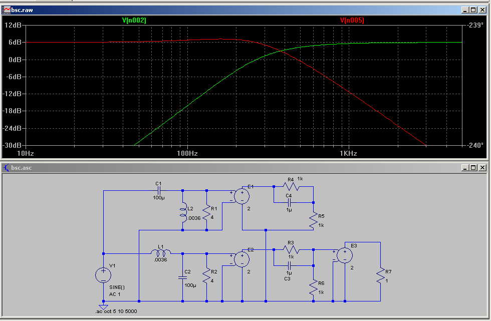

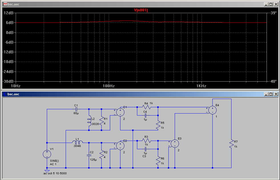

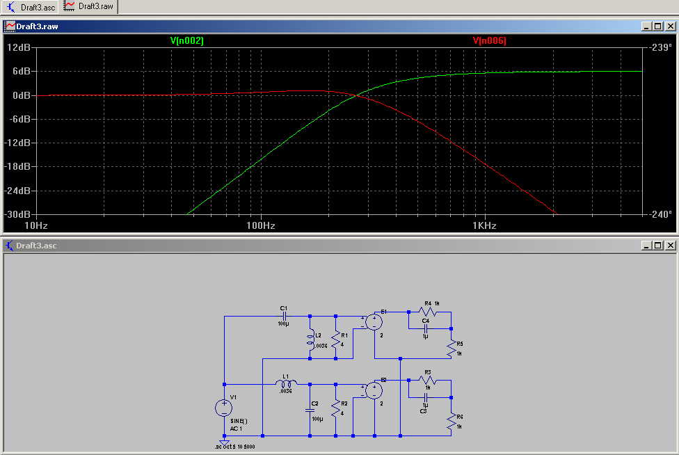

Hi Pete.
For the bass-mid cross over I will likely use a 2nd order low pass witha 3rd order high pass to avoid potential nulling effects at the crossover and having to stuff around with driver phases, but for for now I have just run a series of second order LTspice sims which pretty much demonstrate in my mind that the assertion that performing the BSC entirely in the bass-mid "won't work" is a red herring (as well as the claim that the bass needs to be "blended" into the mid-range - the opposite is true).
Attached below is the start.
A pair of second order filters consisting of a bass low-pass and mid-range high-pass with f3=250Hz are drawn into LTspice and simmed.
The responses of these second order filters sum flat.
Next, two identical first order networks are added to the outputs of the filters to simulate the baffle step gain (f3=111/Wb - simulating a baffle width of ~440mm).
Note that the mid-range response has increased by 6dB and there is a slight peaking of the bass.
