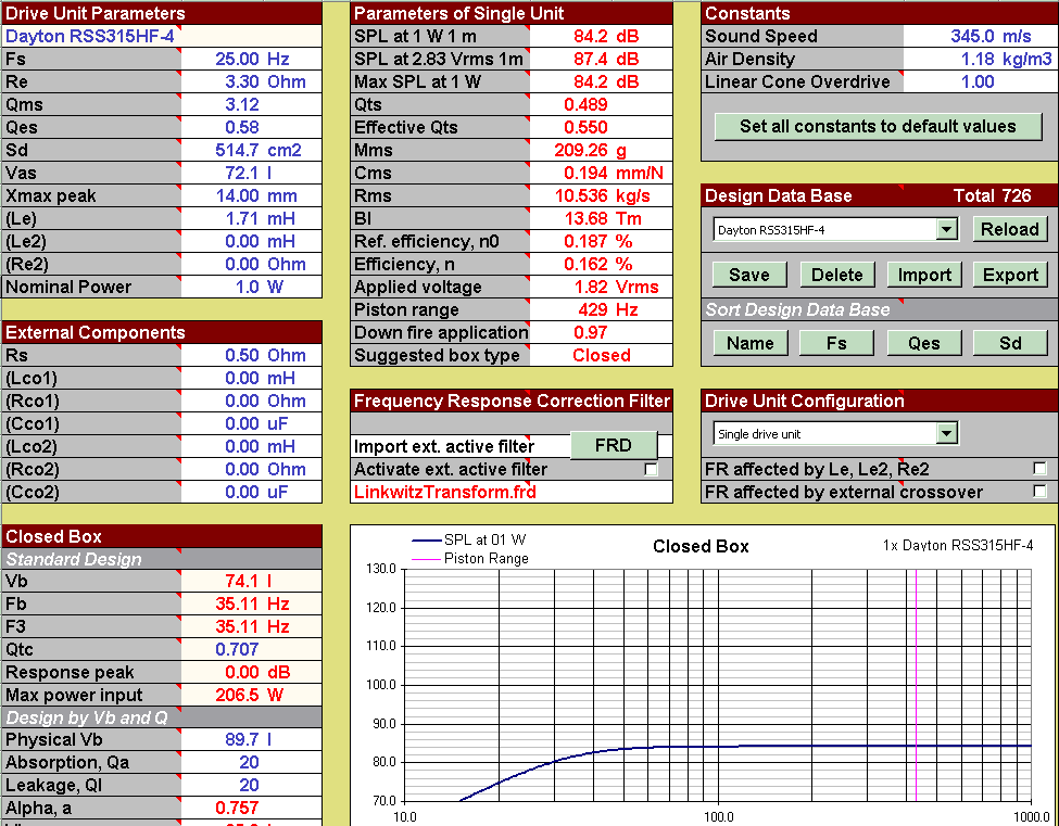

Re: Re: Re: Re: Re: Re: Re: Half space sensitivity
Me again,
I've looked up the Dayton unit and the above can be shown to be correct in the data provided.
In the specitications detailed on the page here.....
http://www.partsexpress.com/pe/pshowdetl.cfm?&DID=7&Partnumber=295-464&ctab=2#Tabs
.... an SPL of 89dB is given at 2.82V/1m
However, the .pdf datasheet here.........
http://partsexpress.com/pdf/RSS315HF-4_specsheet.pdf
.....specifies the SPL in 1W/1m (or 2V/1m) - it is 3dB lower at 86dB.
Anyway, this is an excellent driver! Huge power handling, 14mm Vmax, fs=25Hz and a high Qes giving an low EPB of 48 - perfect for a closed box.
With a 2.83V/1m SPL of 89dB, I will have 95dB with two in parallel.
That gives a baffle step compensation of 5dB with the selected 90dB (2.83/1m) mid-range and tweeter - just right.
Cheers!
Glen

OK Pete, I just Uniboxed that Dayton unit.
Even with a series RS as high as 0.5 ohms, the closed box only needs to be 75L for Fc=35Hz at Qtc=0.707.
Maximum power handling is over 200W for a single unit and Vmax limiting well beyond the desired 250Hz crossover.
This is a fantastic unit.
I think I've finally finished with the driver selection.
Glen
Looks good Glen, what is the excursion limited SPL at say 20 Hz? You can set the driver power rating to 1000W to get an idea of just the excursion limted SPL since the system will handle much more peak power than continuous? What is it at 16 Hz?
This will help to determine how much VD is required to obtain your required max SPL at your chosen lower freq limit. Most drivers work well beyond Xmax, 20% more is usually easy, some will do even more.
Just a note, you can set the the configuration to 2 drivers, and there is a check box to show the passband droop as a result of Le. Nice work!
Pete B.
Pete B.
OK, I have the HF rolling off and a pair of drivers in parallel, but not sure how to work out the cone excursion. 😕
Glen
Glen
It's on a tab to the right, there are more sheets if that's what you're asking.
