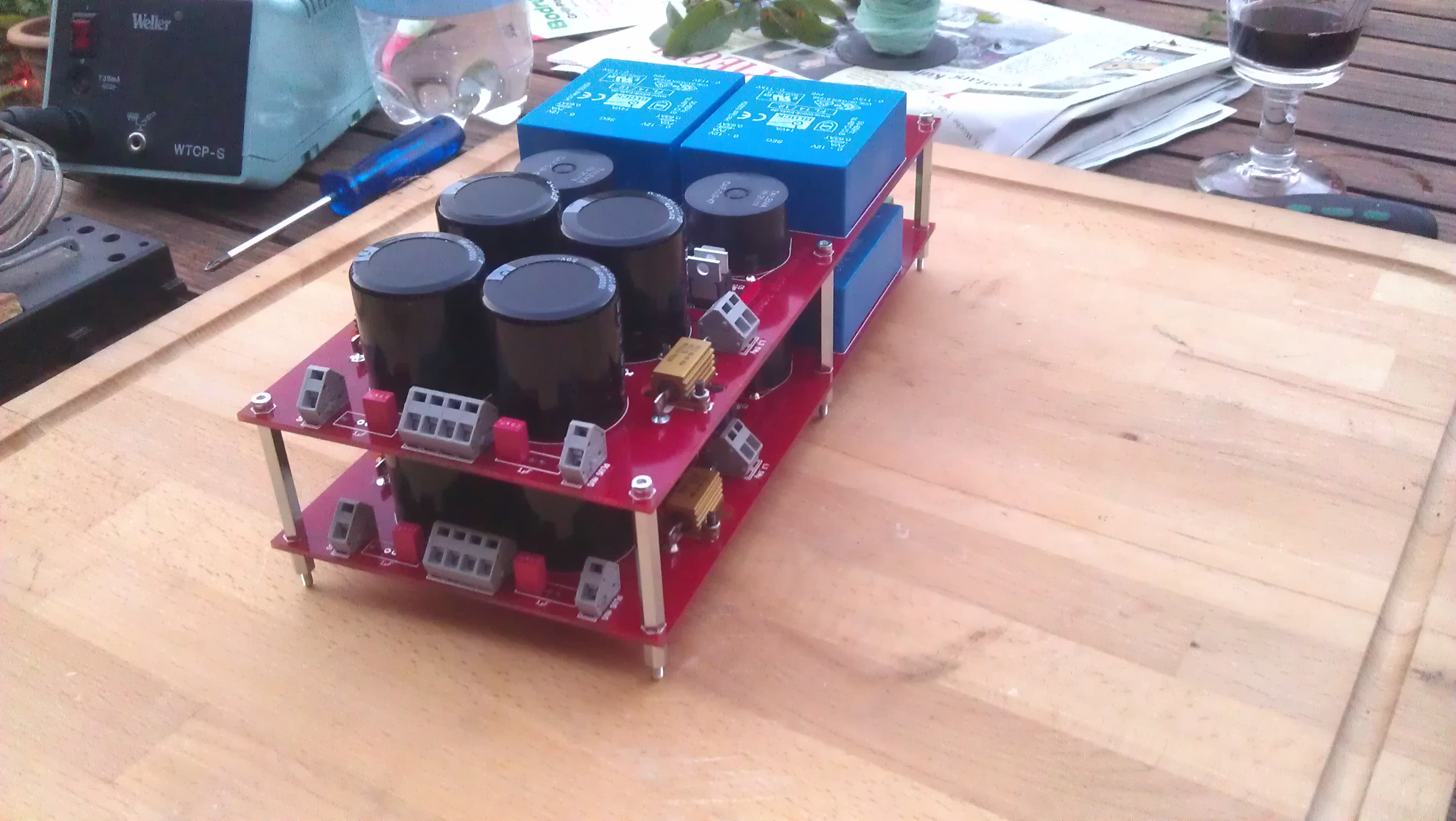

My Preregs are ready...
now waiting to get the parts for the Paradise Amp...
It was really nice to build, quick and easy. Sitting in the garden, enjoying the nice weather and a good Franziskaner Weizen :D
