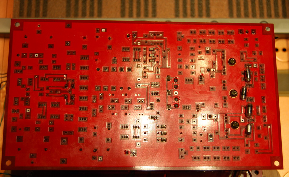

Of course i have connected it. Now i realise the 2MHz has been at the Paradise output all along only it wasn't so clearly visible because of 50Hz and other noises and the scope had trouble syncing.
So, in a way - back to square one, only this time the regulators are rock solid and not adding to the rf chorus.
Caps somewhere? Base stoppers on input transistors? The base stoppers are my least desirable option, first for the lack of particularly nice 16 x 10ohm resistors and second because of the amount of desoldering.
Still curious: are the other 200 builders not experiencing any oscillations? Especially with the inputs shorted? Are my boards cursed?

hi, did you check on different places on the board how the rf-oscillations are distributed? there are two main possibilities: they are generated in the power-supply part or in part of the signal processing chain.
you surely have the 1uf smd decoupling caps mounted (i did not read back through all your posts)?
is the 2mhz signal present on the power rails?
i am shure that a systematic analysis of your board will teach as all a lot 😉
hesener seems to be a great guy, did you consider his offer to send him your board for analysis? i really would be nice to find out where this problem is originating.
A quick recap for your benefit then. It's excruciating to read through long threads.
Yes, i do have the smd caps, which is probably irrelevant. The mishaps began with the CCS parts of the regulators oscillating @7MHz. It was measured, simulated, cure found and applied and all is now well with the regulators. So, PS is definitely out of this picture.
Hesener was extremely kind to offer his help with the board. At the end it was me who declined his offer. Moreover in less than a month US based forum members will be visiting and i have already promised a phono-stage shootout 🙂
I also have little doubt that someone in Hesener's immediate vicinity will experience the same symptoms before long. After all there is nothing at all exotic about my build. It uses almost entirely, with the exception of the fets, the components from the group buy which appear to be first rate.
Per example in this post there is an oscillogram, which most probably shows exactly the same problems as the ones i had/have. Scope cannot sync as the power supply is also oscillating.

Battery died after first pic...
You are welcome. The need for these caps has not been officially established. In my case they were clearly essential but, at least theoretically, they reduce the performance of the regulators. If your power supply does not oscillate, you are probably better off without them.
Sadly, that didn't help. Bypassing them when voicing is probably a must, but first it has to work properly.
