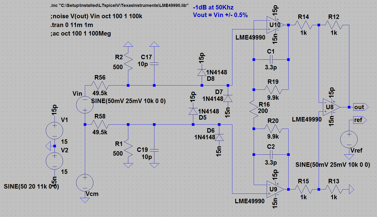

I was planning to build that one, but now I am thinking to get/design a balanced one (I even did draw something up in spice).
Here is where I am (with my probe) 🙂

whats the purpose of r56 and r58?
The protection diodes must be protected (I thought) also I want to use this thing to measure floating items in power amplifiers running of +/- 70V. For this purpose I may even need higher values for these resistors. They, and the two 500ohm values will be switchable. Any other thoughts on this? Currently it is just a simulator-prototype.
