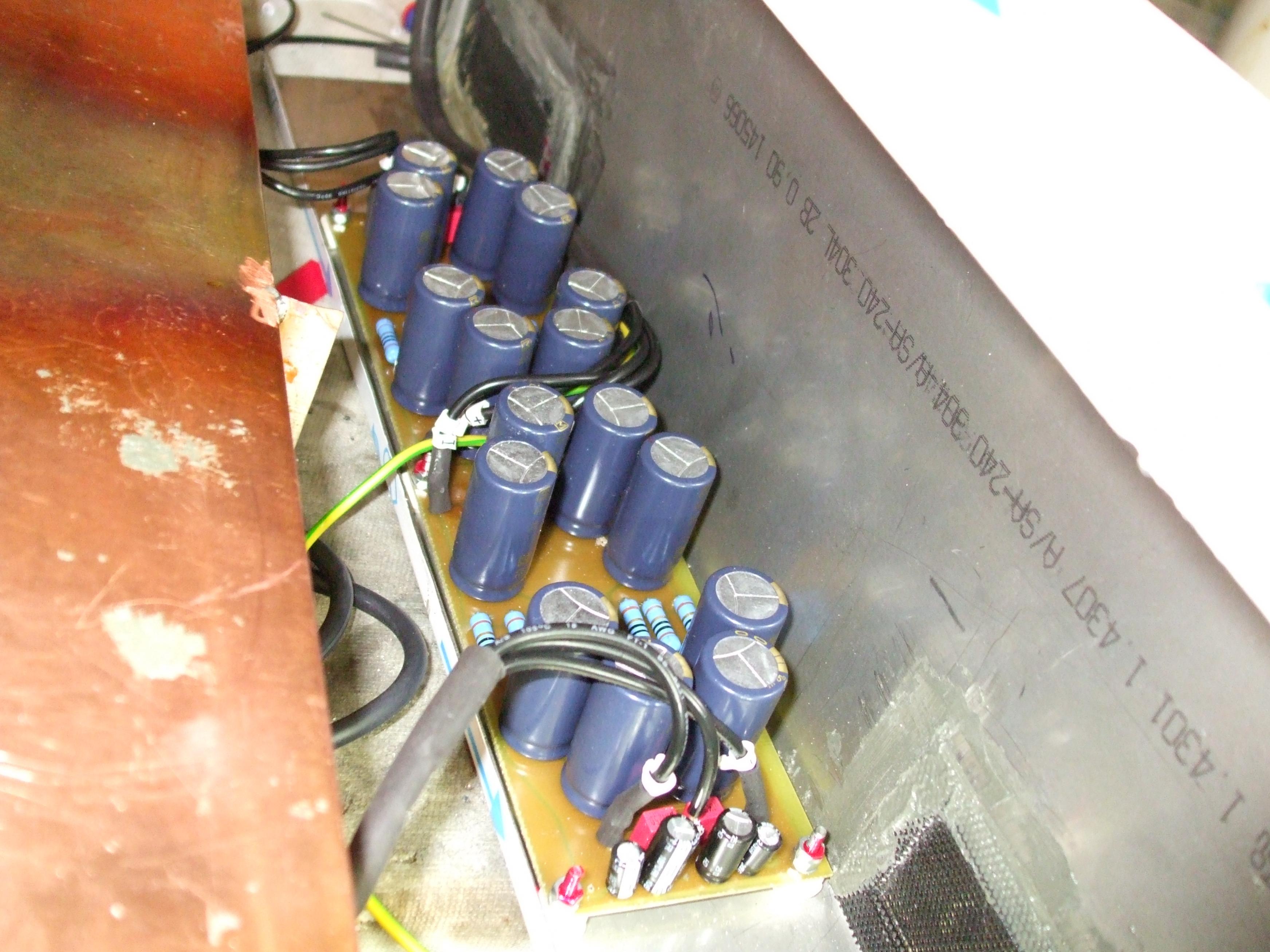

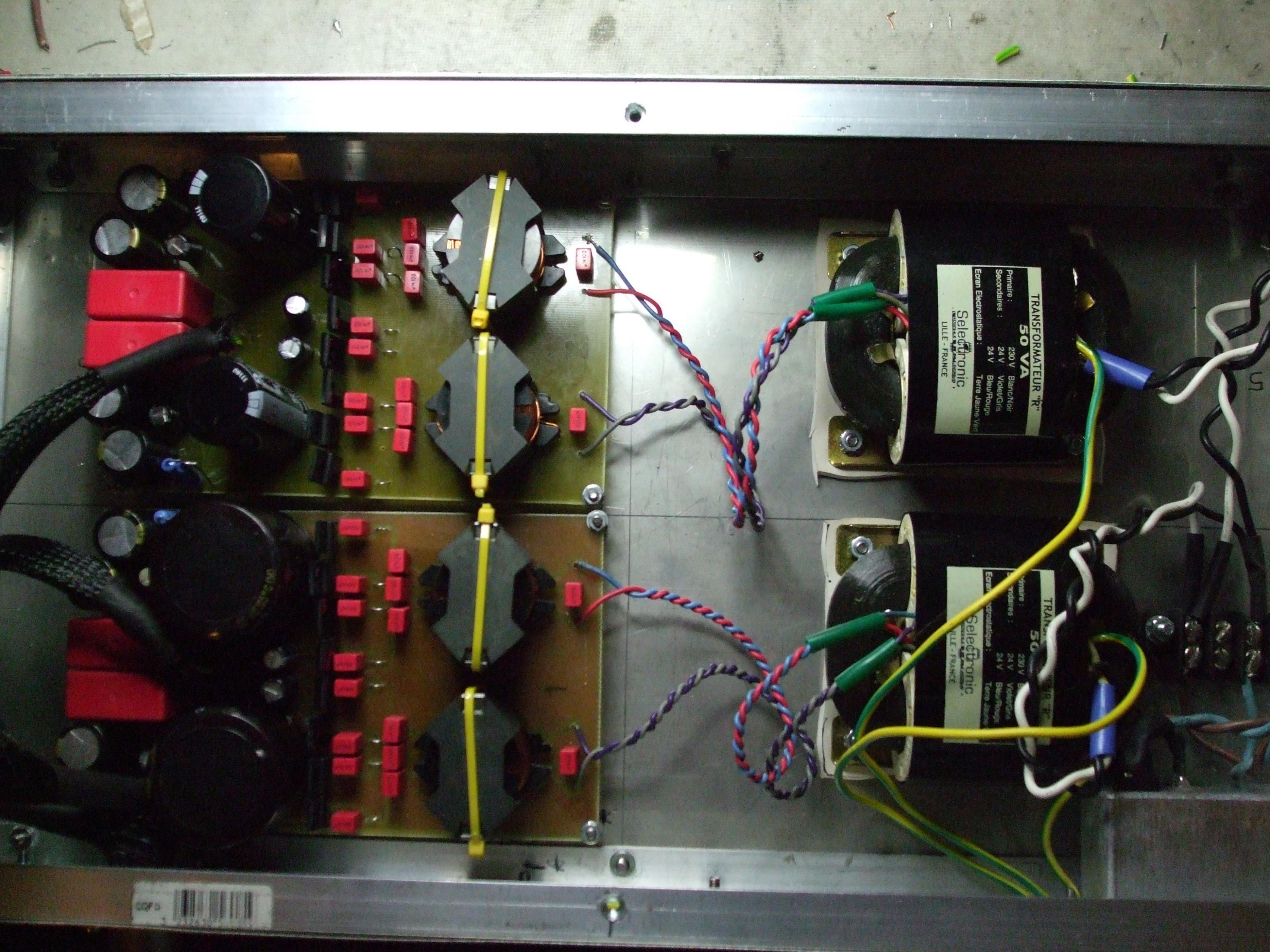

Sabbath, what transformers did you use?
Now I use 18 / 18 V AC from RS Components
That picture was Beta PSU
I tried seletronic Race cores 24 / 24 but those have realy poor spec and voltagge was sky hi stay weel clear of those
Paradise sinks suplied on the goodies bag can not take the 24/24 but this can be solved with an extra CRC
IMO Idealy I wuld use 20 / 20 ac and same CRC
I got no pictures of the last ones
PSU with Race cores
and EXTRA CRC this mounted close bay to paradise boards
