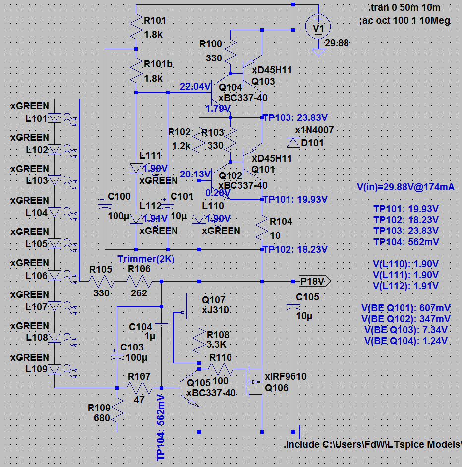

Yes I did, and I do not know what to say 🙂
The attached picture has your numbers in it, it is fed from the voltage you gave, it generates the output voltage you measured. Then I added your measured voltages (test points, Vbe’s and Vak’s of the LED’s) and I sat back and watched 🙂
And my conclusion is, I DO NOT UNDERSTAND IT 😡
There are no Si based transistors with a Vbe of 0.2V (as calculated) or 347mV (as you measured).
The PSU is operating as expected, outputting +18.23V and -18.21V, the current sources seem to work. Now we need some smart person to figure it out.

Thats a good one... just spent 30min looking at the same picture, in wonder....
BTW, VBE of Q104 is -1.79V, not 1.79V. It should be fully off. Still, Q103 seems to be conducting, else there would be no output current. But it is doing something between open and short circuit, else V(TP103) would equal the input voltage.

Hello Alfred,
hello FdW,
Power transistors are isolated. I had to to this as I mounted them to the sink with screws. The mosfets are in a plastic case so not needed here. But to make sure, I measured 6MOhm from GND to metalcase.

Still hard to believe the current should very so much with input voltage, for both rails.... mine were rock solid (once the CCS was operating) and were not changing (but I am quoting this from memory, would have to re-check)
BC337-40 as supplied with the group buy at both positions.
In my power amp I have a pair (one + one - 15V) of these PSU's running from 70V (finished a pair yesterday). The CCS current does not vary with input voltage (any way, this is prohibited by the leading CVS).
Mounting the wrong transistor (as Hessener noted) may make the reverse Vbe work as a zener and the CCS and CVS may conduct (this could also happen if the power transistors where wrongly mounted (I guess)).
But it is all a bit unlikely to lead to a functioning PSU.
I still cannot explain the hugely variant Vbe’s , I keep on watching.

Frans, I was wondering if the transistors were somehow acting as a thyristor, triggering each other off... do you think that could be a possibility? Never heard of it though. And it might be due to very high (current) gain in the setup.....
May be (but unlikely). The numbers (measurements) are very unreal, and I cannot understand them. The gain of the power transistors can be diminished (lowered in importance) by lowering the resistors R100 and R103 (they could be lowered to 22 Ohms).
But as I do not understand what is happening, I am a bit afraid to advice a thing like that (it could be that doing experiments like this does more harm than good).
